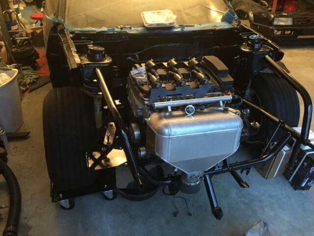

          So you will need a custom intake manifold with port injection. Like so
