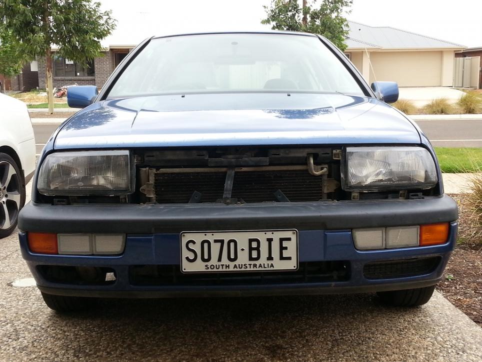

So not much has been happening lately. Went to get regassed and compressor wouldnt hold pressure, going to risk getting one from a wrecker. Read online its a common problem and was told today if the aircon doesnt get used for a while they do fail, anyone know which is true?
If my memory serves me correctly, the refrigerant gas acts as a lubricant on the seals and the working parts of the compressor. If you do not use the aircon for an extended period, the seals can dry out and fail and you will lose your gas and the compressor will become unserviceable. I was always told to run an aircon unit once a week for 15 mins to give it a good lubrication (this applies to your home reverse cycle split system aircon too).Last edited by feenix74; 23-12-2015, 09:59 AM.1997 Golf CL, 2011 Caddy Life TDI, 2007 Golf TDI, 1996 Vento GL (red), 2008 Skoda Octavia TDI
