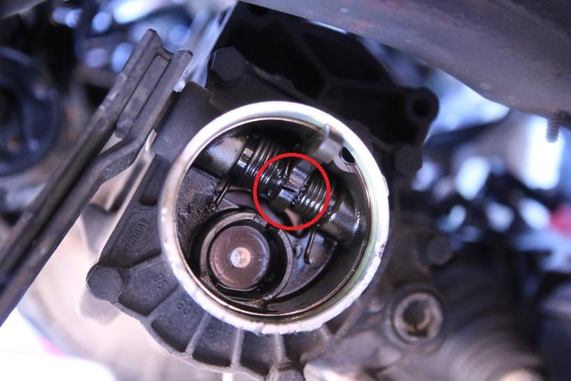

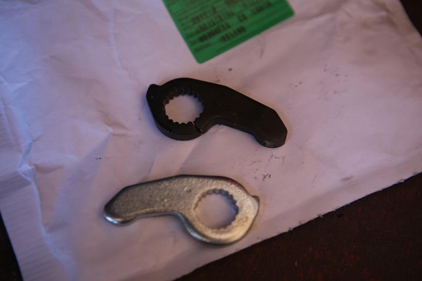

    Sadly the golfs been out of action for a while due to a dead clutch. I've been waiting on parts for about 3 weeks and finally at least one part arrived.
    Massive thanks to those who helped with narrowing down the problem, it was indeed a split arm.
    I'll admit I was a bit scared to pop the cap off but it was actually really clean inside
    Can see the split here
    And the new one

      Same thing had happened to my old Mk3 when it had the 1.8 in it - p/o knew that was the cause and even supplied the replacement part.
      Glad you got yours sorted!!

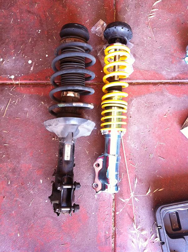

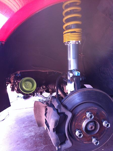

          I finally fit the coilovers on Saturday as well. The FK's actually ride quite well, the front has been lowered approx 2" (about half way in terms of the available thread for adjustment) and the rears are wound down about 85%, there's maybe another 1" or so on the rears but I can only just get my jack under the car. I may raise the rear a touch, will see how I go, the front I would like a touch lower but I do like my sump in one piece.
          This was when I first fit them, I took them down a bit more after playing around with them.
          I replaced the sturt mount rubbers while I was at it,
