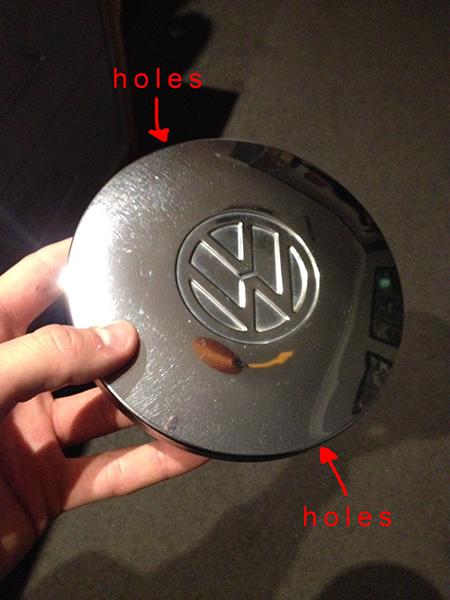

      Well my VW wheel centers arrived, unfortunately they're not a straight slap on like I had hoped for. Seems like I need some kind of spring/retainer clip to hold them on. If any has any bright ideas feel free to post them up in this thread or over here - http://www.vwwatercooled.com/forums/...ps-105880.html

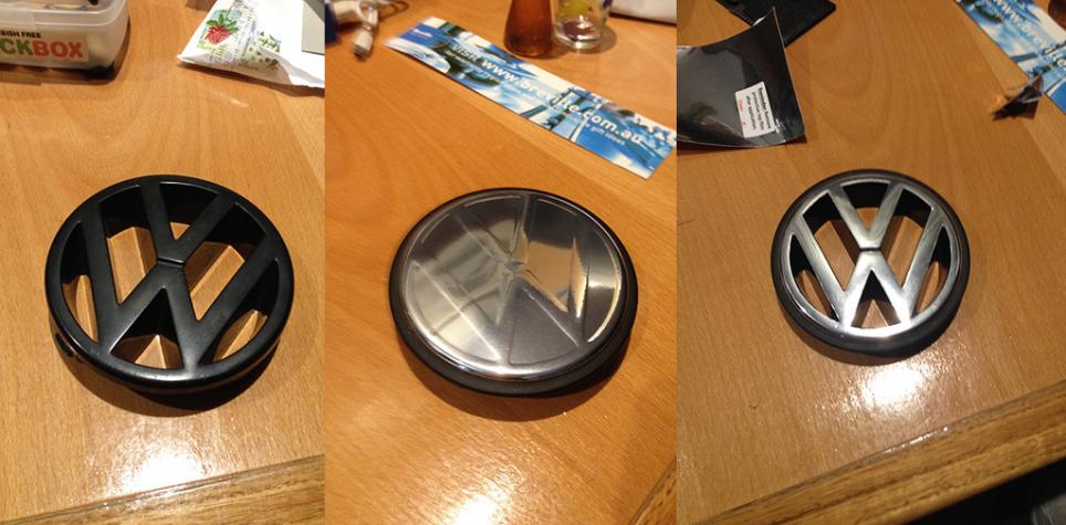

        Not much interesting happening in VW land. I picked up a second hand VR6 grille as mine has a nice dent right in the middle of it, will need to paint that in future. I have a spare set of mk3 hubcap centres on the way thanks to a member on here, which I plan on mutilating so that I can retro fit my mk1 centres, will most likely be repainting the wheels once I get those on. I got some replacement LED bulbs for all the interior as I have a blown one in the dash/speedo, plus dat factory green is nasty so that'll be on the cards for a rainy day in future. And here's an experiment that I tried with some chrome auto vinyl wrap that actually turned out okay haha. eBay tells me a new grille badge is $80-90 (stuff that) so I got myself some vinyl wrap for $6 and wrapped a spare one that I had.
        • #34
          that chrome wrapping looks mad, where did you get it from ?
          • #35
            Good old eBay. Right here to be precise - Chrome Vinyl Wrap CAR Auto Roof Film Foil Premium A4 Sheet | eBay
            Was a bit of a fiddly job, you need cut a square that's probably got at least 5cm around the edges so that you can grab it and really pull on it hard to stretch the vinyl over the rounded edges without having any creases or bubbles. Once that was all dandy I carefully cut out each section with a sharp razor blade.

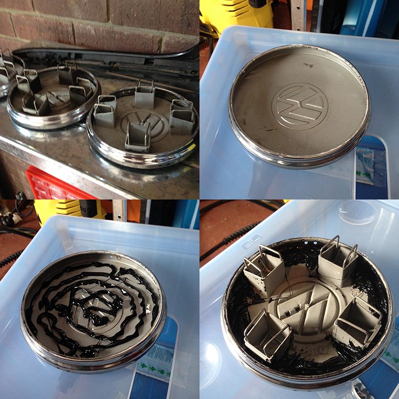

                  Been a bit quite on here as I moved place and didn't have internet for about 3 weeks but I've been pretty occupied with the move any how. Nothing drastic has happened really. Serviced the damn thing, oil & filter / fuel & air filters and I have some plugs to put in as well. Ive ordered a rocker cover gasket coz that's leaking as well. One of my dash lights was out so I got rid of the old smelly green defuser and popped in some nice bright LED's. I'm in the process of retro fitting the Mk1 centres by using a set of spare Mk3 centers, trimming them back to sit inside the Mk1s as they are smaller so they will be a simple pop on / off job. They are just sitting on in that picture so not completely centred and will be painting the rims gloss black when I get the time.

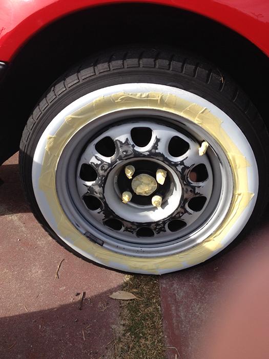

                              I also butchered my trade the other day and did a total DIY driveway job on repainting the factory wheels (painted them on the car haha) mainly because I don't have 4 jack stands and didn't want to do half the job at a time. The original silver was falling apart and had been planning on painting them black any way.
                              Painting the wheels gave me the nudge I needed to fit the Mk1 centre caps that I've had for a while now. I got myself an extra set of the Mk3 centers which I trimmed down and Sikaflex'd them to hell and back. So far they haven't flown off down the road.
