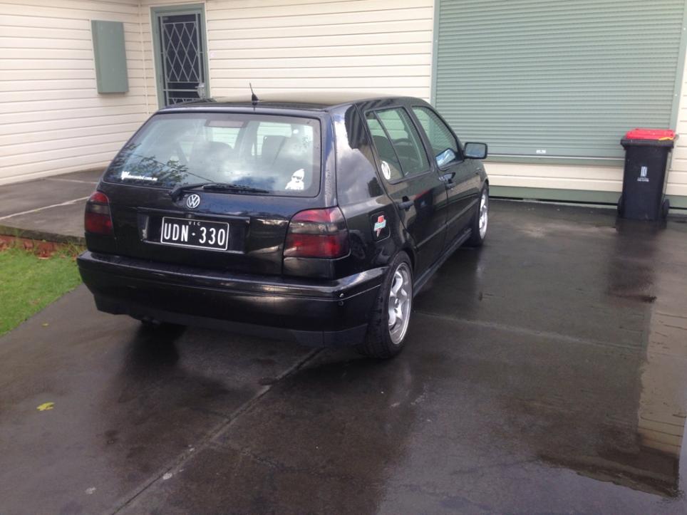

    • back to vr tail lights, thinking about shaving the rear badge and wiper,
      • I've blacked my badge. Don't fancy bogging the hole :/.
        I want to remove the wiper, just need to find a suitable bung. I've seen a cool Wolfsburg bung which looks sweet!

          nah i don't want to bog it, i want to weld a plate in the recess. i want to keep bog to a minimum.

              • Go to bunnings and there is a set of 4 plastic 21mm plugs in a packet for like 4 bucks. I used the original seal the wiper uses and it's been sweet. I have been meaning to take thenpkug out and chuck some plummers thread tape around it as an extra step during winter but it hasn't leaked so far.
                • Originally posted by BurgundyMk3 View Post
                  I don't want to bung it, I wanna be smoooooth

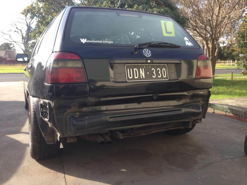

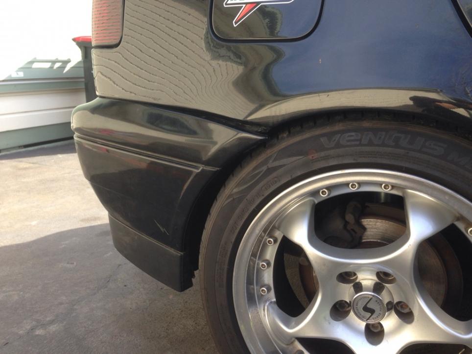

                    tried to align my bumper up today as it's been off place and the tyre is close to he corner of the bumper, I want to run spacers on the back to make it abit more flush and looking abit beefier, but it'll scrap on that part of the bumper.

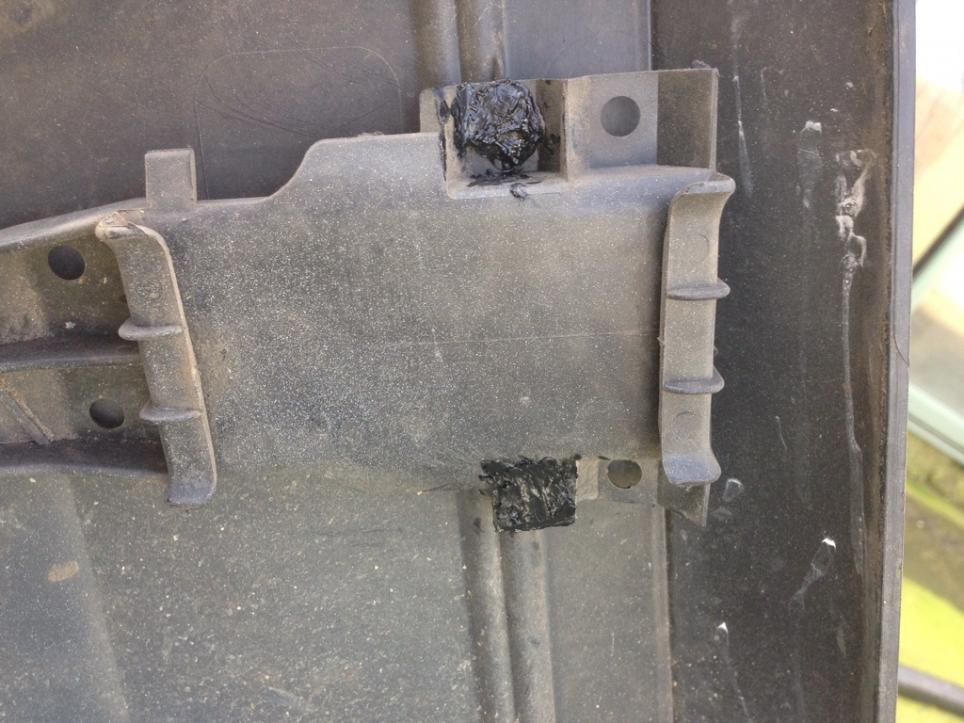

                    decided to see what was wrong, looks as if these sliding tabs were broken, so I tried to plastic weld them, (I used the same plastic as the bumper too) but didn't bond well enough and in the struggle to put the bumper back on it snapped off again, didn't have enough time so I just left it,

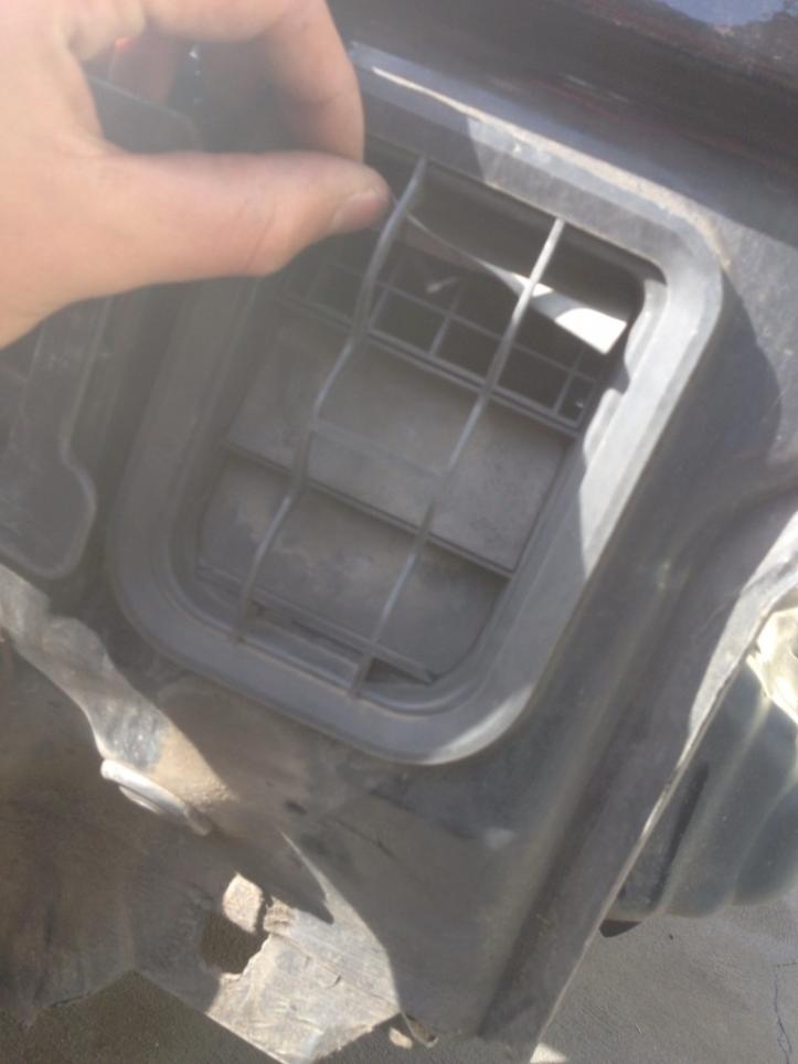

                    also, what are these vent things?
                    • Same thing when I was pulling the bumper off my parts car, the clips seem to be very flimsy.

                      • Not sure if you already know but there is a small metal clip on each end where you show it is sagging. They are a PITA to get both sitting properly while sliding the bumper on.
                        With the vents, someone on the forum told me they are just ventilation, air comes through the front of the car via heat/cool vents and comes out there.

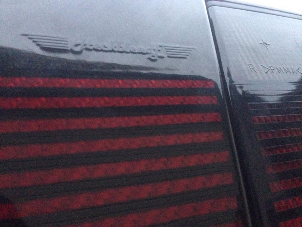

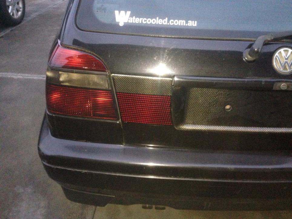

                        • I bought aka vr6's heckblende,
                          don't have anymore tape for the rear plate. lol
                          yeah I got both clips over .

                              Cabin pressure relief vents
