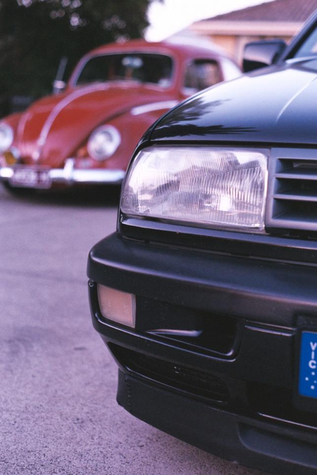

Beetle and Vento by Matthew Dart, on Flickr

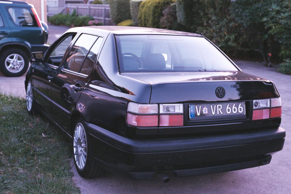

Woody by Matthew Dart, on Flickr
This was from Operation Rescue Beetle a few Fridays back with Waterboy and Dylan. Good times and the start of nice summer weather. The arvo was a success, fish and chips were consumed, and the Beetle made it back home safe and sound.Mk3.Mk4.Mk1
