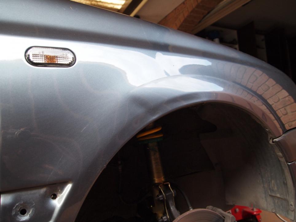

                        Got a little bit done today. I removed the flares to see if there were any hidden surprises, apart from the missing/cut trim pieces this was the only surprise:
                        Anyone got some 3-door trim pieces they wanna sell?

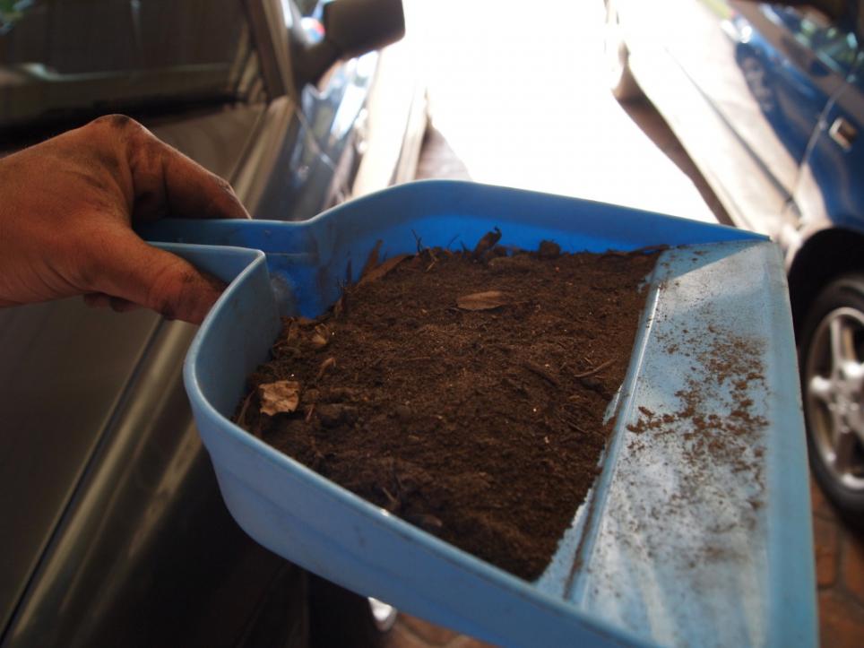

                        The garden I found behind the front wheels lol:

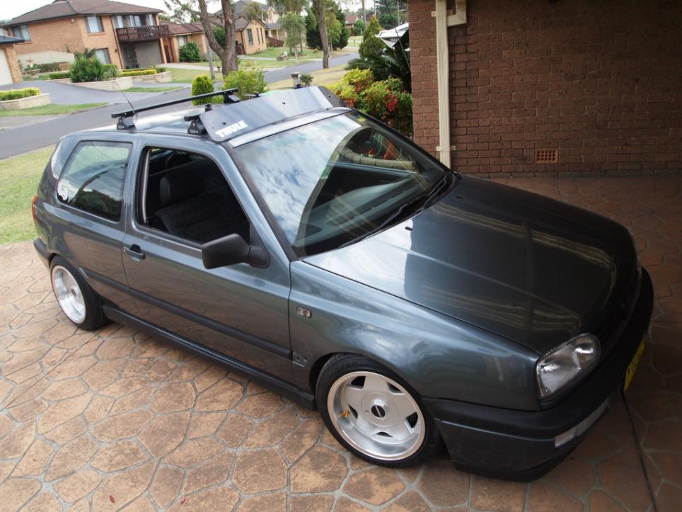

                        Fitted my new headlights, fricken H1 globes are pricey, still haven't got high beams lol. And the Thule roof rack I got from Ventlo

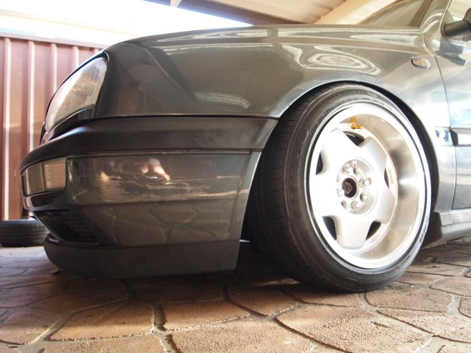

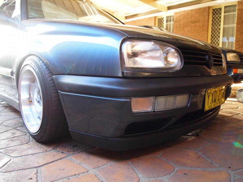

                        Some pics of the front before I work out the kinks...
                        ...see no lower than the Vento was.

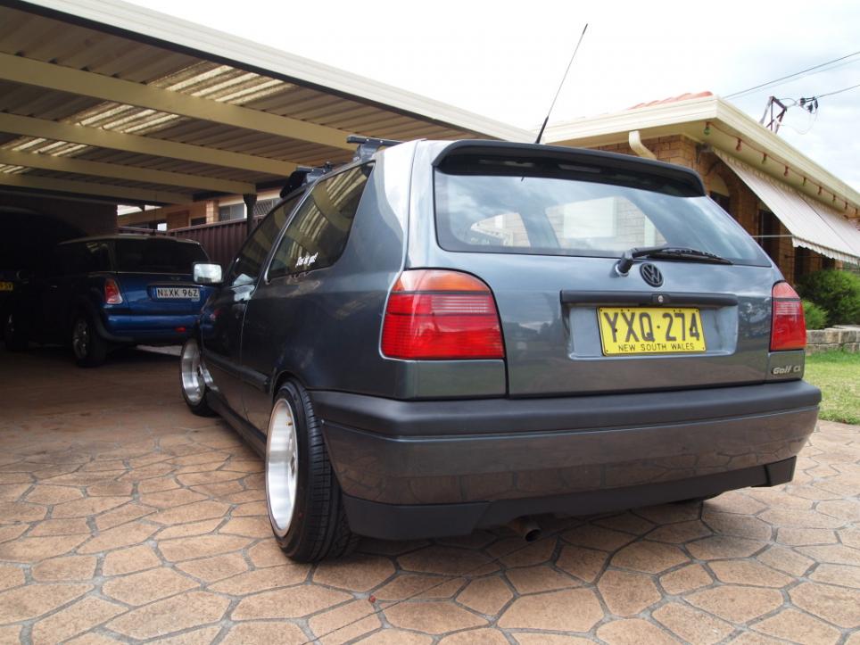

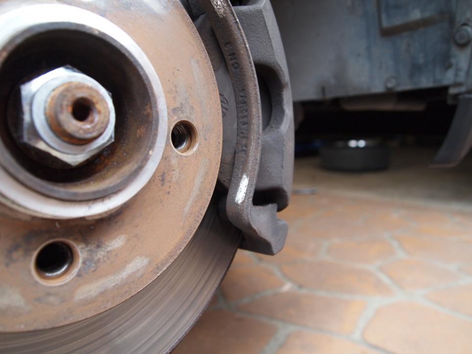

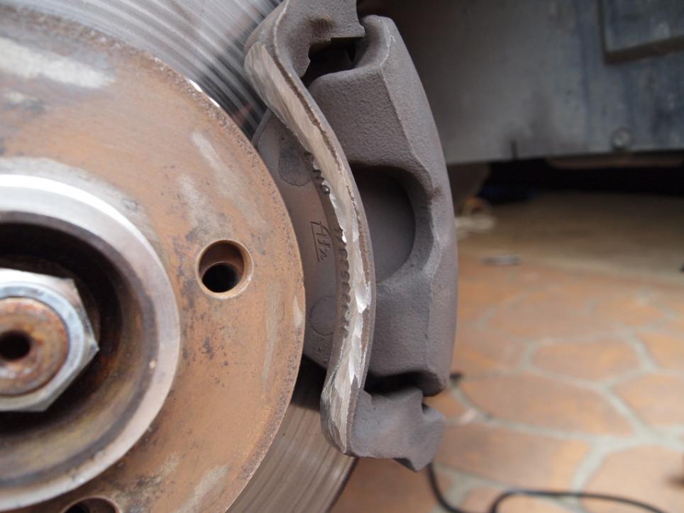

                            Thanks! Almost there now, just need to buff out marks where the old flares were. Still waiting on my budged re-trimmed roof liner to come back. The grinding ended up being the wheels rubbing on the calipers, both the Vento and the Golf have the same calipers so I didn't foresee this.... Must've been freaking close on the Vento. So I ground down the calipers a bit.
                            Before:
                            After:
                            Not pretty, but it ain't grinding anymore

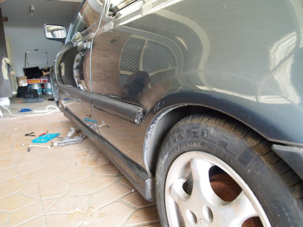

                            Rolled, ground, pumped (with a bottle jack) and hammered the rear guards so I could fit the Borbets with a 15mm spacer for a bit of poke... 0 offset now
