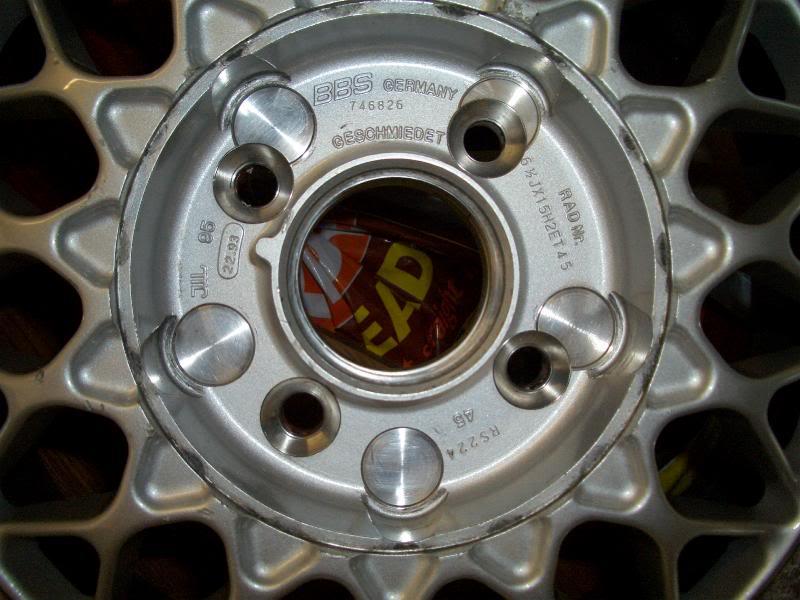

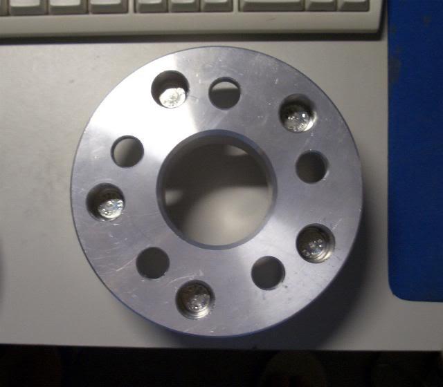

Another thing about them BBs's you have. You mentioned adapters and "redrilling", care to share some light and tell me what you mean by adapters and redrilling? I'm under the impression that adapters just make the wheel stick our further? And redrilling....lost me there. For example, could you buy any old pair of 15"s and put them on your Golf. bang, straight bolt on?

Adaptors are device used convert the stud pattern of the wheels... Say his hubs are 5x100 and his wheels are 5x114 or something like that...

Redrilling is getting the wheel holes redrilled into the correct stud pattern. For the bbs it involves getting the original holes welded up and then drilled by a wheel specialist. Adapters are like spacers except they allow u to run different wheel stud pattern but dont physically alter ur hubs.

And cameo, what James and Pedro are saying is correct. Here are some pics.
Filling and redrilling - evorobin on these forums had them done. The original 5 stud pattern (no idea what the fitment was for) was filled, and a new 4x100 pattern was drilled in. Incredible thing was, the centrebore was exactly 57.0mm, which meant it went on our Golfs like standard wheels.
Filling is actually not necessary though; the only time you don't have to fill is when you're drilling the same amount of holes and the hub was flat-backed.
Adapters allow you to keep the original wheel untouched. In my case, the adapters had holes that allowed me to attach them to my brake hub, and studs were pressed out to allow fitment of other sized wheels.

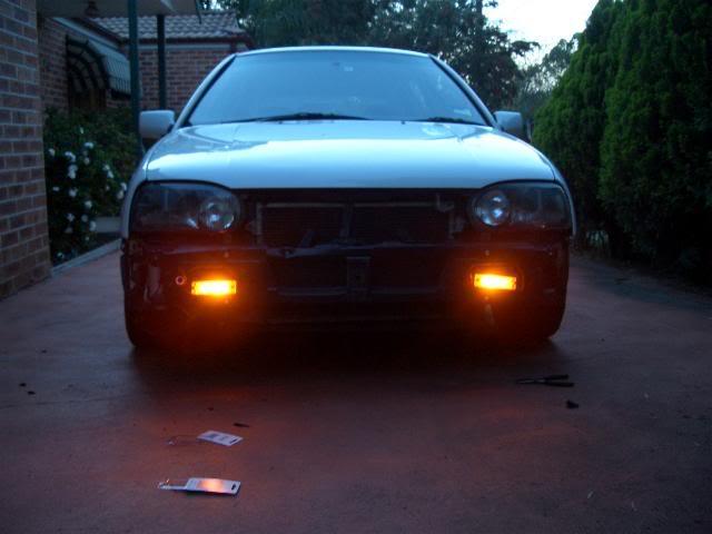

This was before they were smoked. Smoking it made it more inconspicuous, but the lighting suffered. That said, it's still very well visible.
