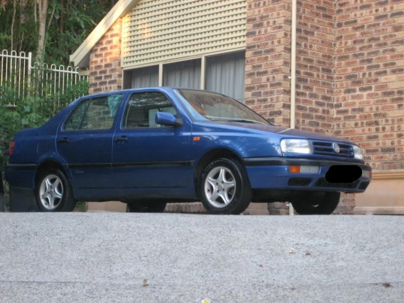

The day I got it.

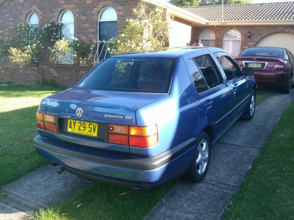

When I got home the badge fell off lol.

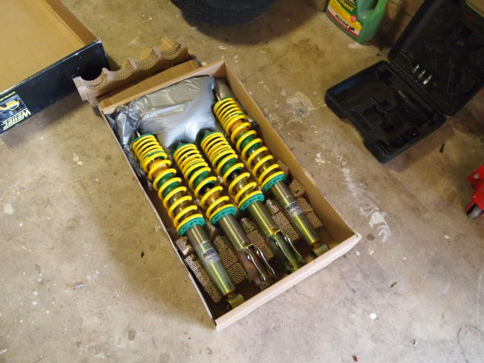

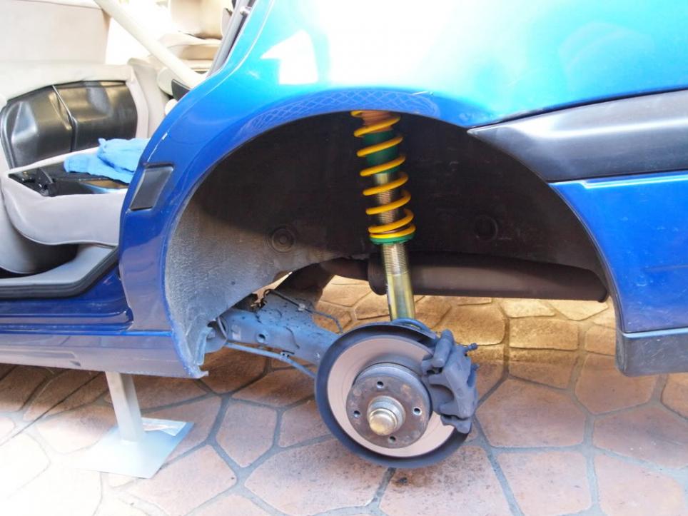

Weitec Hicon GT Coilovers.

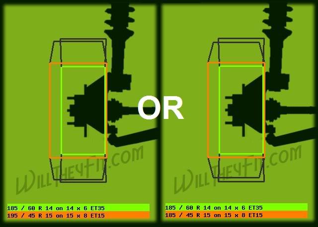

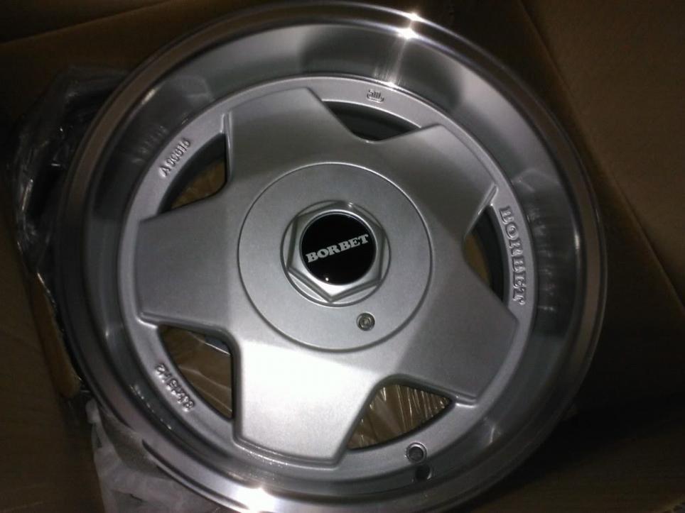

Borbet Type A Replicas 15x8 +15. Will be stretching some Nankang 185's over them.

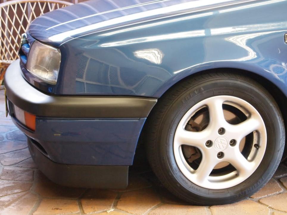

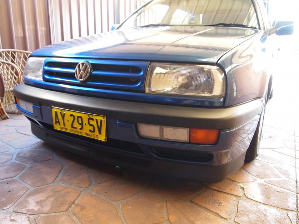

Deep front lip. Still not sure about this, it was designed for the American market (I think) so it doesn't quite fit right. May just go with an Aussie vr6 lip. I may have to remove it when I fit my Borbet Reps because I will be going more low.

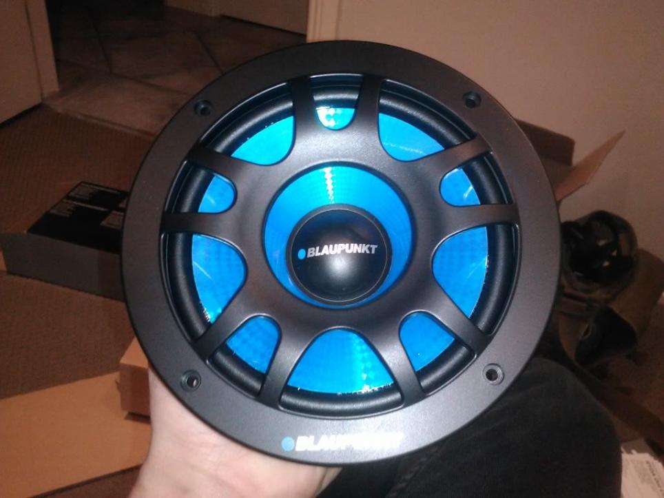

Blaupunkt Toronto 410 BT headunit and front splits for *****s and giggles, and dancing bananas

. The lip is not US per se, it's just that your Vento has... well, a Vento front bar, which as you've discovered has slightly more overhang. A locally delivered duckbill will sit exactly the same, for perfect fit you either need to go a Golf front bar, or (some trimming involved with tabs) get a narrow US style front lip. Took me fitting my old VR front lip to mine to discover this, it's something suppliers often don't know (along with other variations) so sometimes you get surprised... but oh well.
