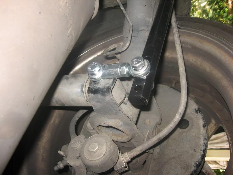

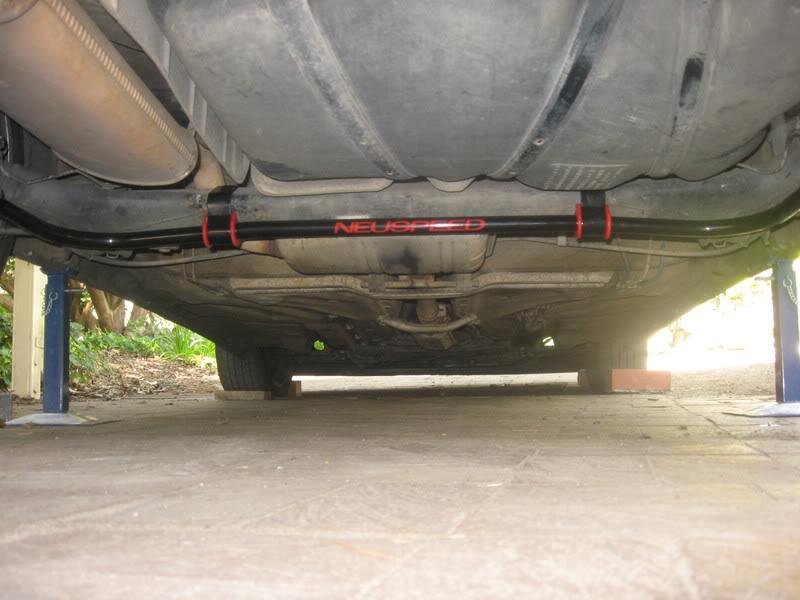

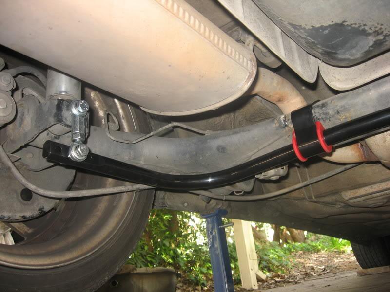

          Another little update, car now rocks a Neuspeed rear swaybar, and damn it was worth every penny. Stiffens up the rear end and reduces body roll by quite a bit. Car sits alot flatter around corners and I have yet to experience any real oversteer issues with it set to medium stiffness.
          Was a bit wierd installing a sway bar to a car that never came with one, Im more used to putting them in replacing an old one! Was a bit stumped at first when I realised there wasnt really anywhere for it to go (ie holes to bolt to).
          Wish the rest of the under car was that clean!
          • Looks great james !! How hard was the install ??
            • Wasnt to bad in the end. Hardest part was putting the new longer bolts into the bottom of the strut for the sway bar links (muffler and fuel tank get in the way)
              I could do it all again in about an hour I reckon.

                      I was expecting alot more work is needing to fit the sway bar, cutting welding muffler etc.... Good to know it was not hard.
                      • prob should have adjusted it to the softest setting, even more so because you dont have a front do you? I would imagine that oversteer will be kickin your ass out quicker than you can say f*&k
                        I have the 25mm and 28mm and was recomended that I make it soft, see how you go anyways
