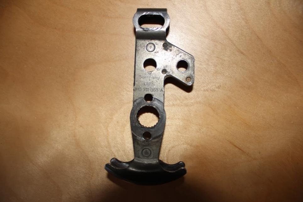

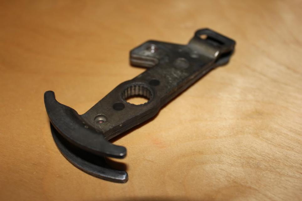

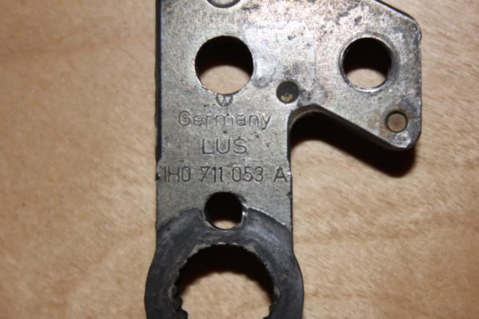

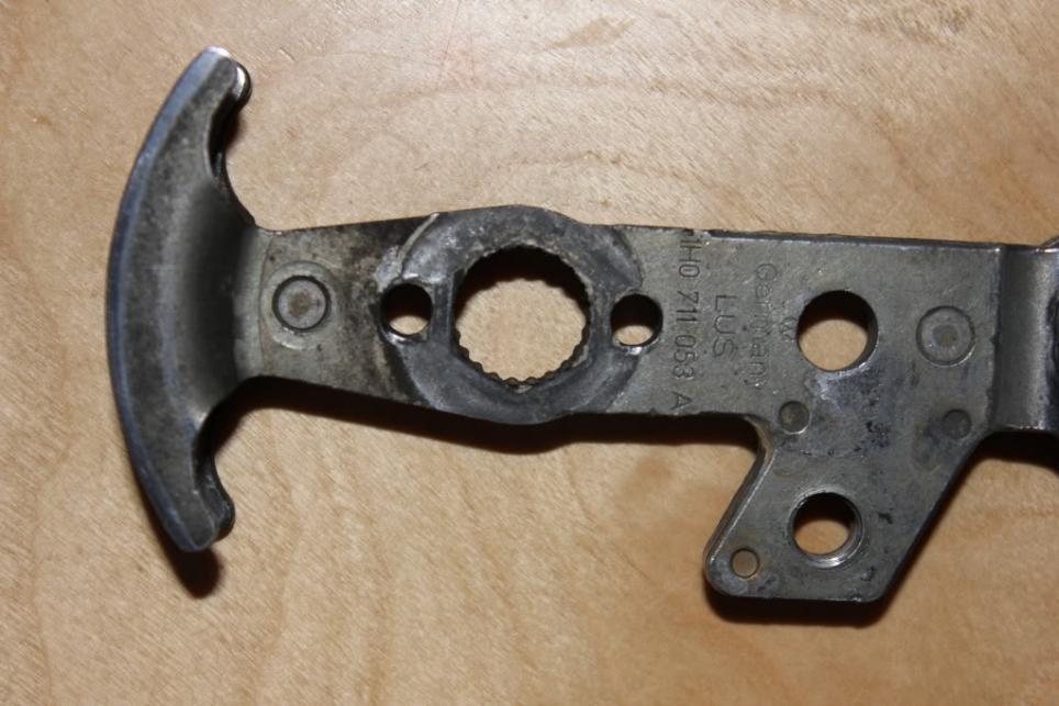

      I found the problem though.
      The spline on the shifter lever and the selector shaft are worn out.
      The Part Number is: 1H0 711 053 A
      But I even rang up the VW dealership (Burwin) and they couldn't even find the diagram of the 02A tower.
      So i'm a bit stuck to where to find this part..
      otherwise i need to find a place that can re-spline this part.
      If anyone knows anything that may help, that would be great.
        If you can supply them with the part number, there's no reason why they can't run a search on it to at least get a price.
        To re-spline it, you'd need to close the hole up and re-bore before you can spline it. You'd have to do similar to the shaft.
