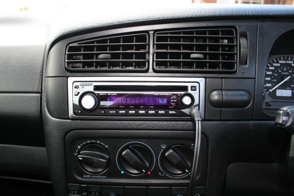

                              Got the cd player in, after 2 hours... The oem radio has little holes in it which you are meant to be able to put something in and that releases it. But as hard as we tried we couldn't get it out that way so we took the whole surround out and did it that way. Wasn't to hard really. My friend made me an adapter out of all of his electrical gear so i didn't have to buy one. So now i can listen to my ipod static free!
                              Have no radio until i get an adapter for the new unit but not to worried.
                              Here is what the new unit looks like...
