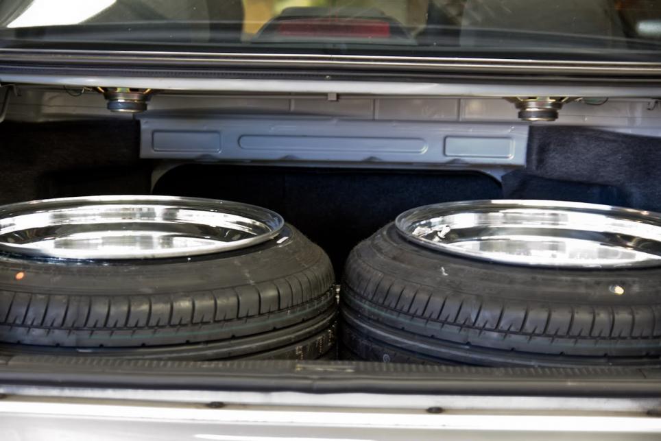

    That's like a 225/235 on a 10".
    • Look out for achilles tyres they do od sizes, stretch well and good price.
        Woody's got it right. 225 on 11", beaded easily with a blaster:

          sweet, thanks for the tips guys, I'll keep it in mind. I'm going 195/45 on 9.5s so that's going to be a hell of a lot of stretch too, so will definitely need something that stretches nice.

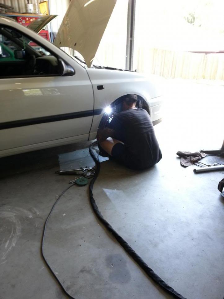

          got front chassis notch welded up and shaved the rear wiper yesterday. also started to put on a rear piece that relocates to hatch lock to make it look like it's shaved. Cant remember the name, will put up details/photos later
            That **** cray.

                yeah I know, I've looked at the photos heaps of time, should look sweet I think, and I'll need the stretch or it's not going to sit as low :p

                • Anyway yesterday I had a notch in the front finished up for driveshaft clearance

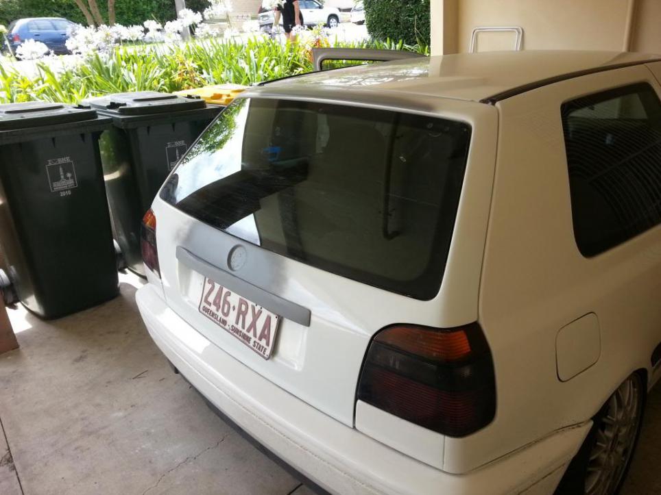

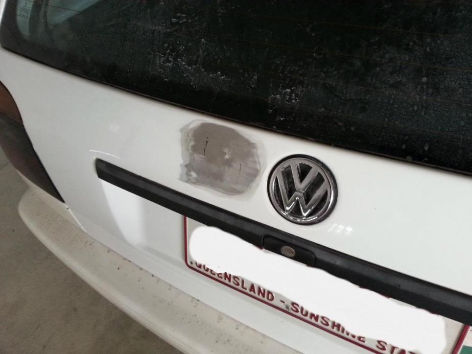

                  Also got the rear wiper cut out and some metal welded in

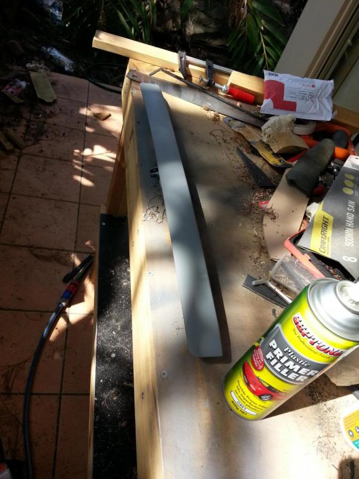

                  Got this "Cult Society Clean Style" rear handle thing a while ago, it had a little chip in it so I fixed that up with some fibreglass filler and sanded it down (the original finish wasn't perfectly smooth) and hit it with some plastic primer
                  It relocates the lock to underneath. Was a complete bitch to install, as the instructions where in german and the pictures where vague at best. This thing has also been through a few Australian owners who never fitted it before it came to my hands, looks like someone lost some of the hardware too and replaced it with wrong bits (as in it needed 3 6mm nuts, but two were replaced with what im guessing where 1/4, which then stripped the threads of the little parts they needed to go on, so I had to figure out another way to make it all work), you have to cut up the wire pieces that connect everything and extend them, and the actual thing itself wouldn't quite fit properly without trimming a few things, and even then I had to go and buy longer screws to get it to actually fit. Anyway, it's in now and looks cool
                  Put a tiny bit of filler over the where the wiper was and sanded it down and hit it with some primer too, and also sanded down a couple little spots on the top of the boot where seemed to have tiny amounts of rust coming through, hit them with some rust converter and primer aswell. Also took off the rear spoiler and filled the holes with sikaflex. Paint will be done in the next week or two, when I have a few other things ready which I also want to paint

                    You should remove the rear badge as well before you paint it! Weld a new plate in so it's flush ad it will look really sweet and clean
                    YAY I got my R!!!! White, recaro seats, 19" wheels, bluetooth, reverse camera
                    • I thought about it, it would have been easy to do while he was already cutting things up and welding them, but I decided to keep the badge. Everyone seems to delete the badge if they are going to shave the wiper, so its almost something different to do just one but not the other, and I quite like the badge anyway It's still a lot cleaner than most, have removed rear spoiler, wiper, lock, golf and CL badges and exhaust cut out is next to go, so only thing left on the back is that badge

                          Car doesn't sit any lower than it has been sitting for a long time. To be honest I cut the notch myself a fair few months back and had organised for someone to weld it up. That fell through though and I pretty much forgot about it until recently, so this guy just welded it all up.
                          • Any pics of the notch?
                            • Re: Ben vs Mk3. Round 2.
                              I haven't taken any but I know the guy who did it did, they have a facebook page and post up all their work, so when they do that I'll post them photos here

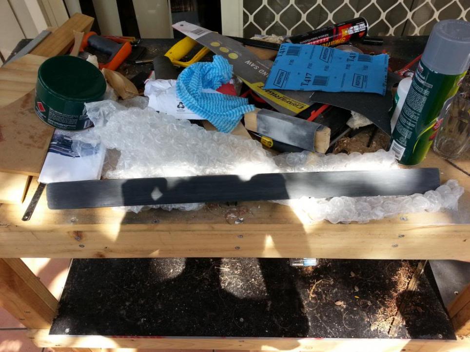

                                Bought some paint and stuff, and spent way to much time getting the back perfectly smooth with a skim of filler and painting it all up. Was my first time doing real body work and painting a body panel (I've done wheels before but it is a bit different) so was a good learning experience. Considering my lack of experience and the fact I used the cheapest spray gun money can buy, I'm pretty happy with how it turned out. My hatch is now glossier and has less orange peel than the rest of the car
                                Also sanded down the originally textured side trims and colour coded them. Wouldn't recommend this, it took a hell of a lot of time sanding and they are very far from perfect, I'd just find some that are already smooth and paint those if I were to do it again. They turned out ok though I suppose, so they will do for now.

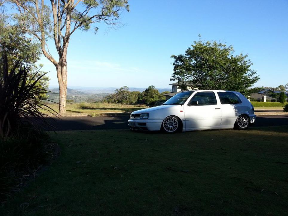

                                And here are some compulsory whore pics of it all back together (well almost, Ive misplaced the VW badge, but that will go back on as soon as I find it)
                                And a photo of the notch
