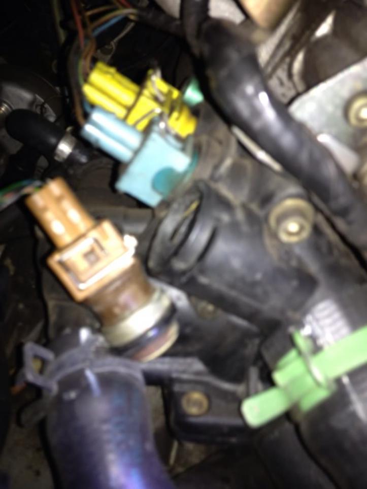

                          Anyway does the plug look like this?:
                          Same thing happened to me a little while ago so... I think it's some sort of sensor to do with the thermostat... Anyway I'll let you know what I did in case it's a similar problem, not sure if it's all the same with the vr6 compared to cl/gl.

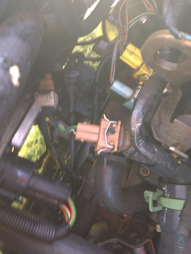

                          Next picture shows the plug unplugged out of its socket. You can see a slit that runs down the socket:

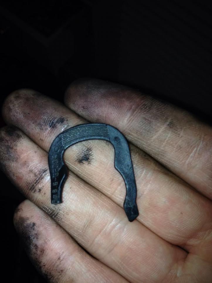

                          Basically, in that little slit, a plastic clip shaped like this is meant to fit in there to secure the clip. The next picture shows this, except mine was snapped down the left side as you can see:
                          The plug kept on falling out when I put it in without this clip from the vibrations on the road and stuff, it wasn't secure at all. The clip breaking had caused it to come loose. I got another one at a vw specialist, but before I could make it there as I was in some place ages away, I found a pretty thin cable tie that fit into that slit, plugged the thing in and cable tied it in tight and it didn't budge. It's probably more secure than the ****ty clip if this doesn't work, have a look at the o-ring and see if it's causing it to leak.
