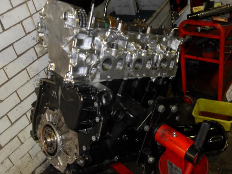

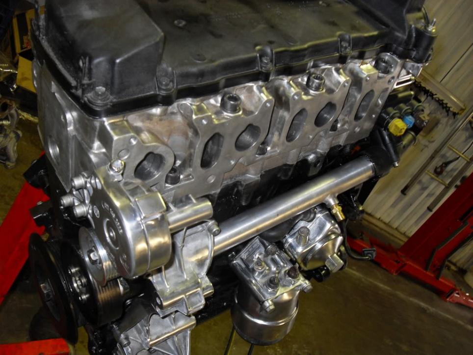

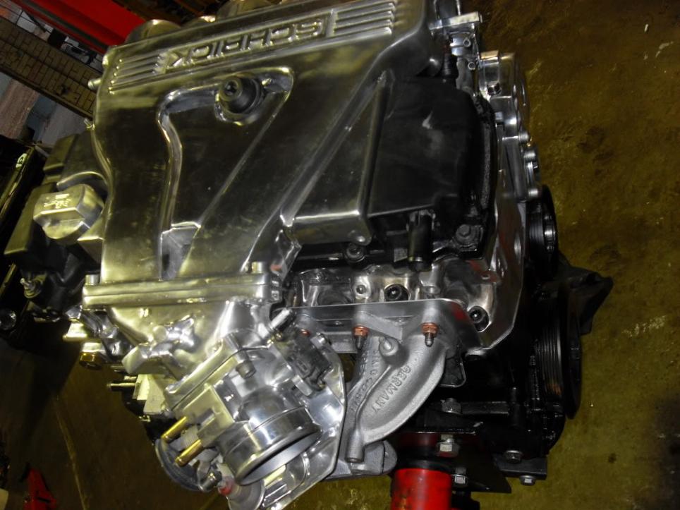

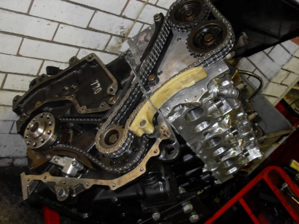

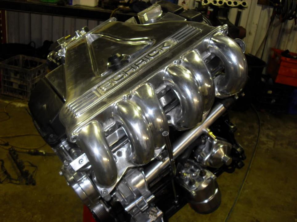

                          • This weeks progress
                            Timing Chains fitted up.

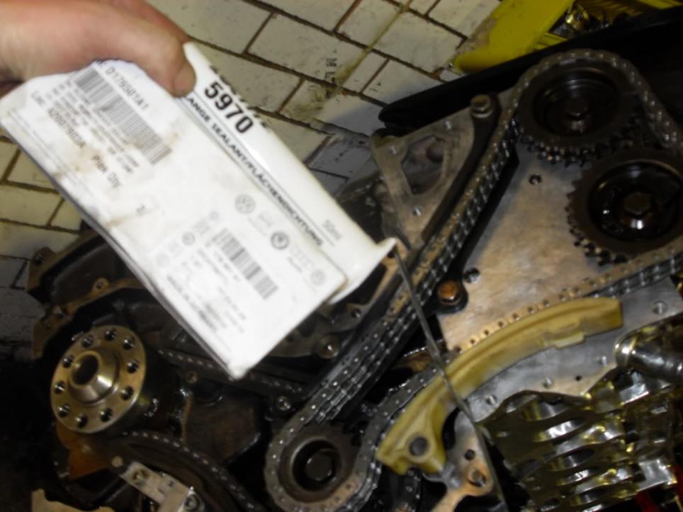

                            You must use the proper VW sealant for the timing chain cover. If you use sealastic, it will leak.
