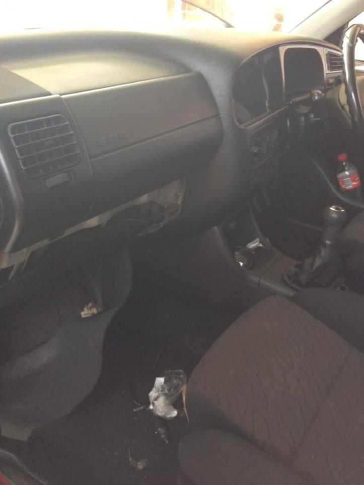

        Yesterday:
        Pulled out most of the dash board apart from the actual dash and windscreen wipers.

            I think I would rather just fix it now and then I can clean up all the mess as well.

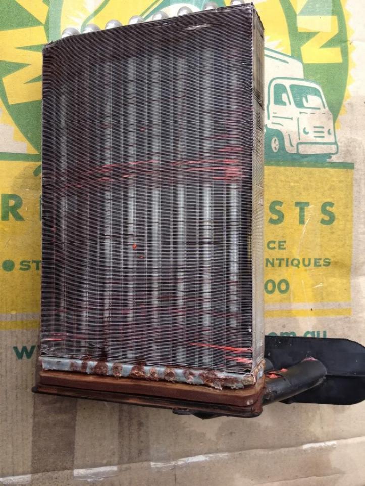

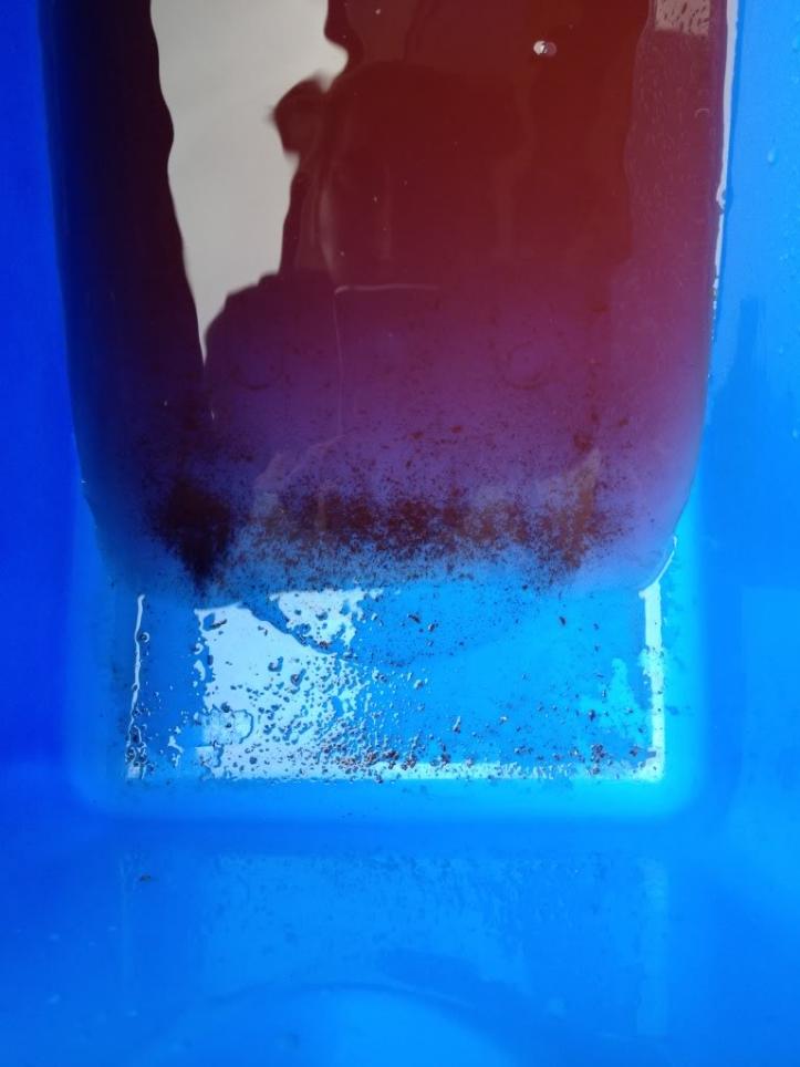

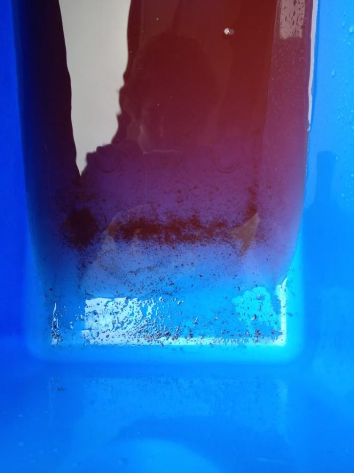

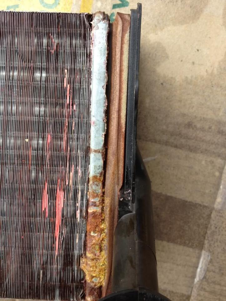

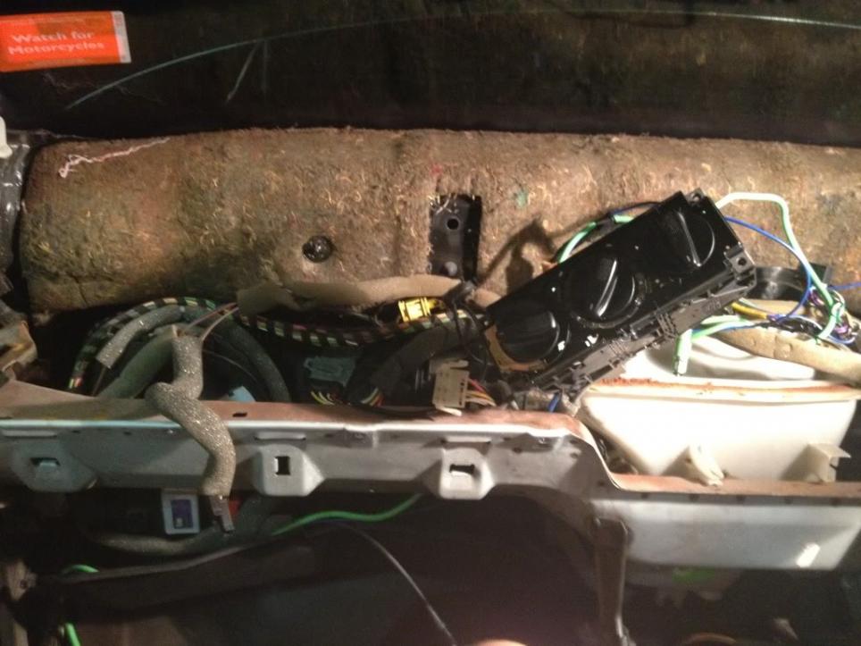

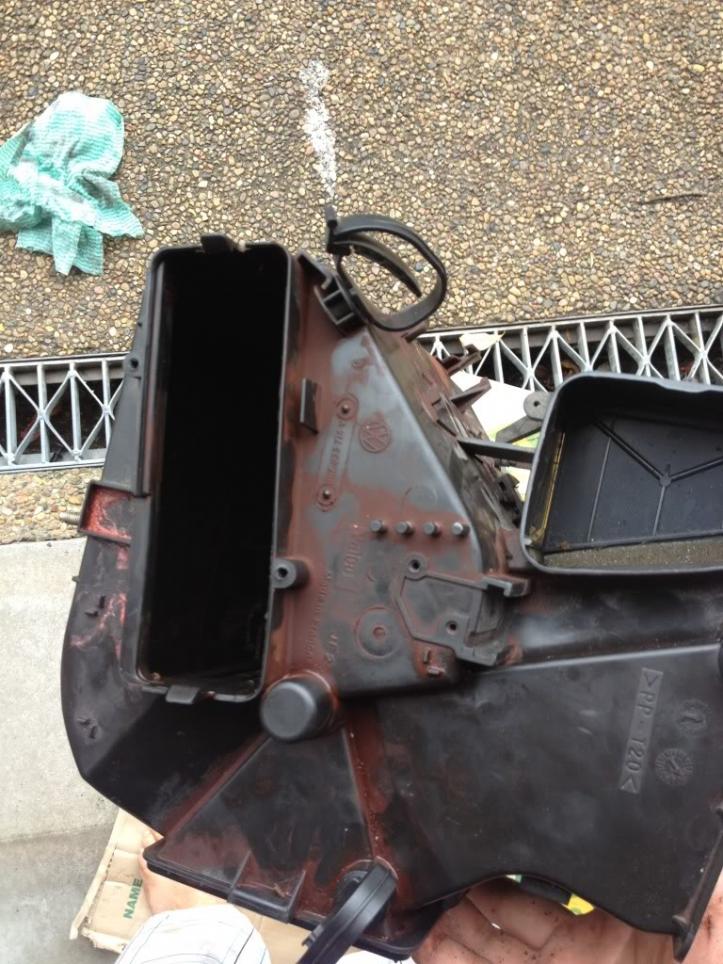

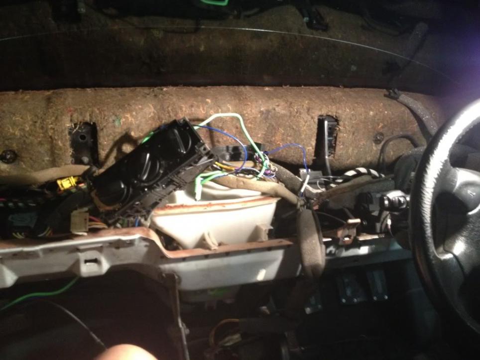

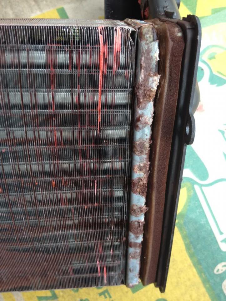

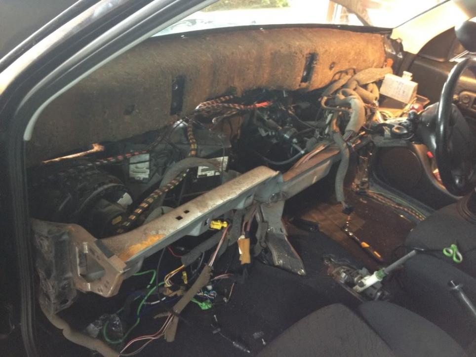

                        • hey guys,
                          So just a bit of an update since I have not done one for about a month now.
                          Here is what I have done...pics can do the talking

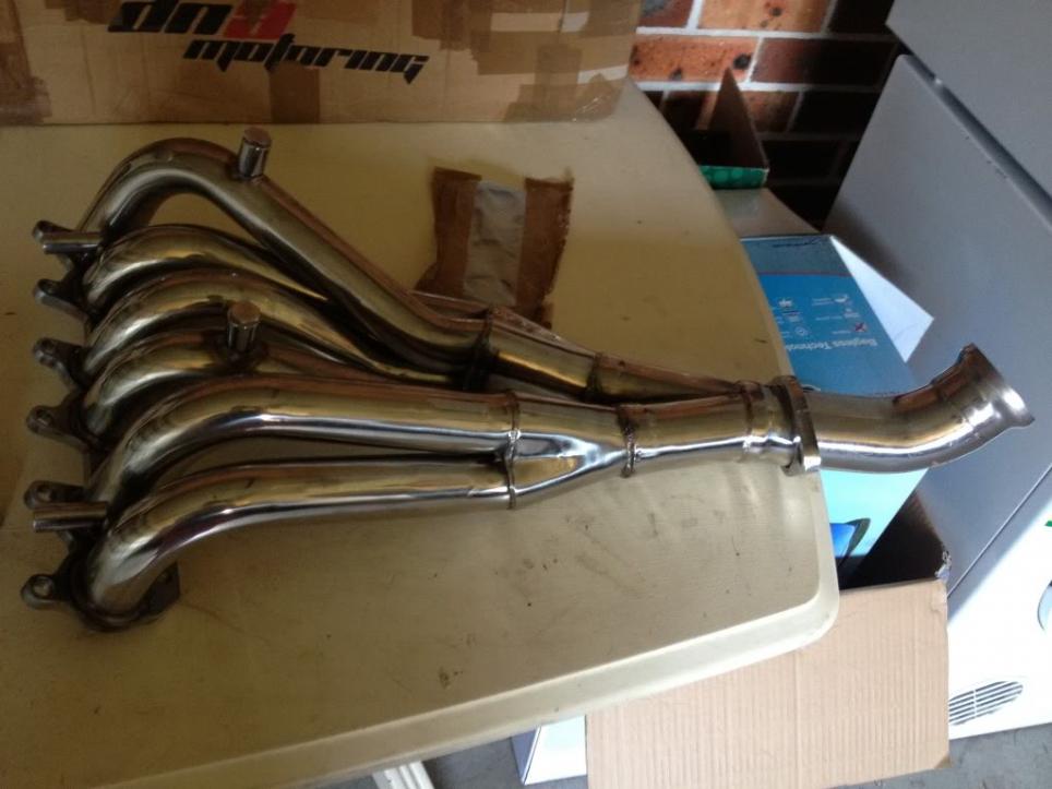

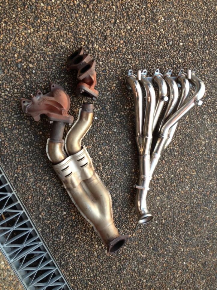

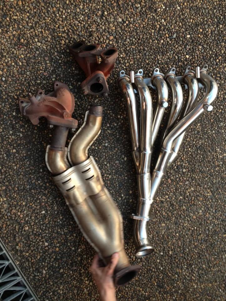

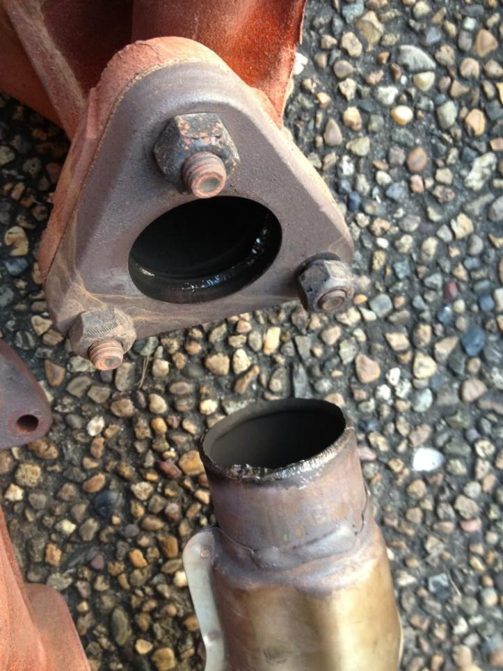

                          Snapped clean off...standard headers

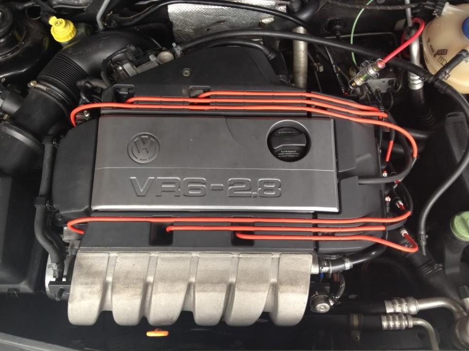

                          New Plugs and Leads

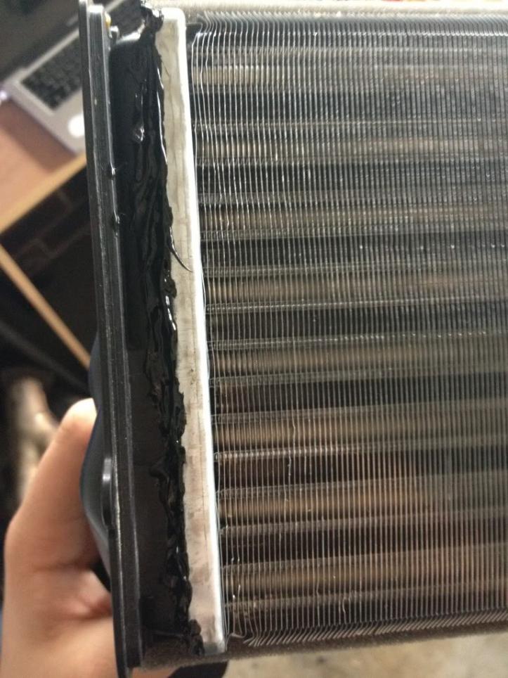

                          Heatercore Swap
                          • Comment

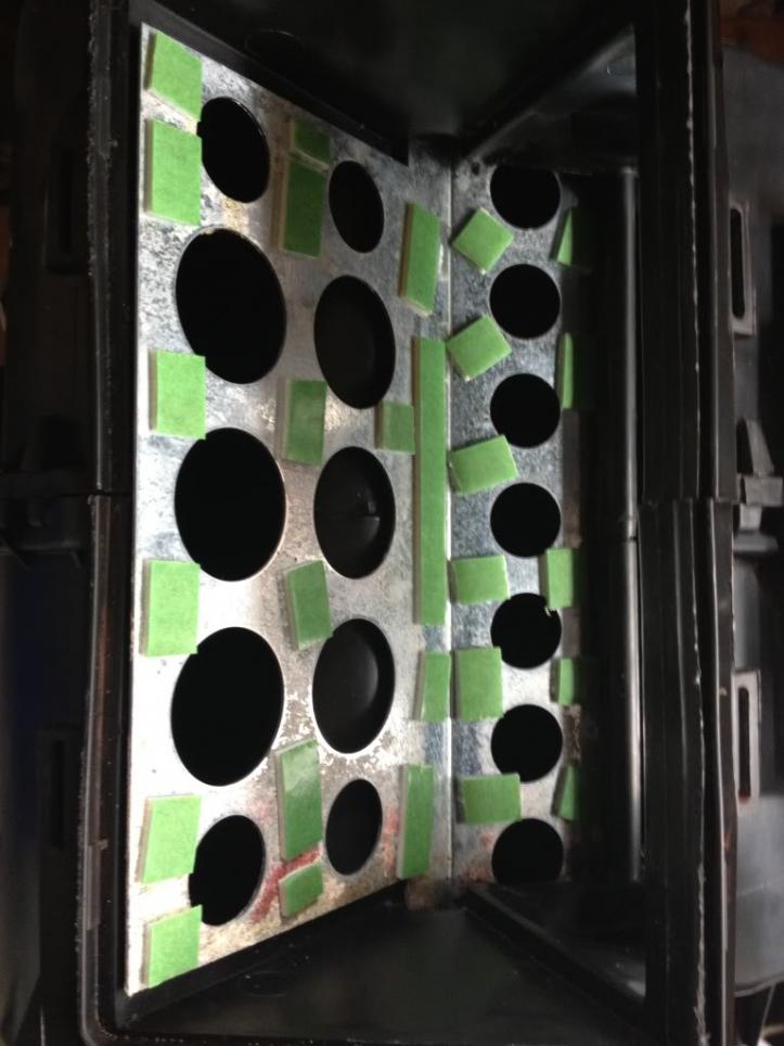

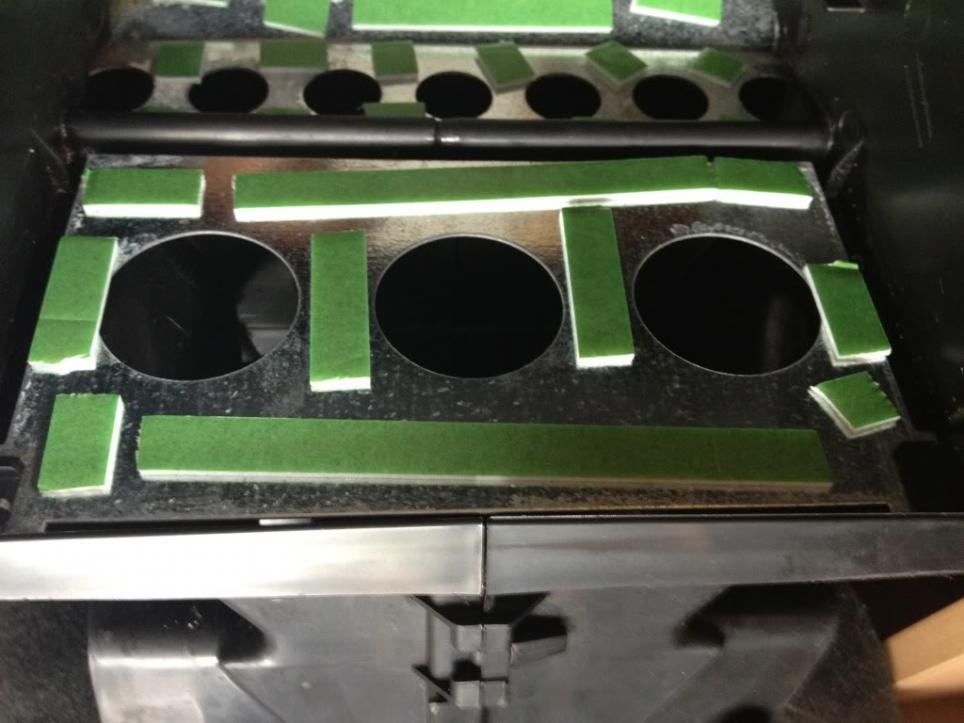

                            • NEW heatercore with some sealant because i'm OCD haha
                              (and other parts for the air distributor box)

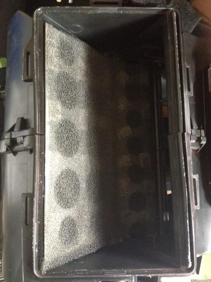

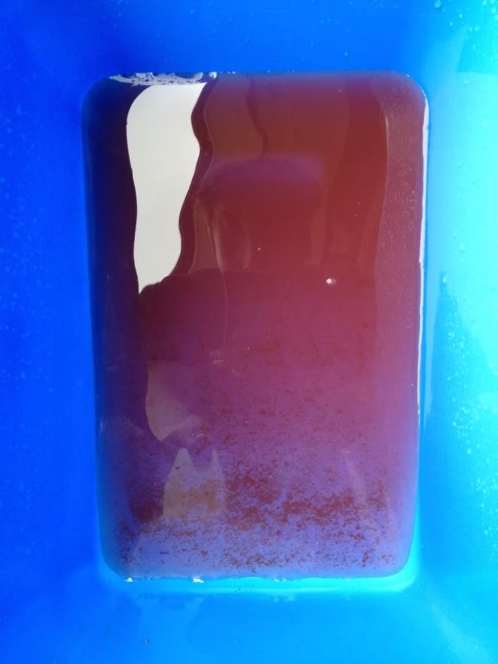

                              So yeah, did the heatercore swap over and filled it up with the good stuff (50/50 water/ VW G12++ coolant), put new off takes on for the breather hose for the heatercore, etc. Cleaned up the back of the dash and sorted out the old foam, cable tied it all up neatly at the back of the dash as I had to cut the factory cable ties off.
                              Fitted new extractors, they are a little bit louder, not heaps, but its a much better sound, it crackles, pop and mumbles and talks a fair bit, and generally just nice to hear the german 6 banger! Of course, no drone, so a cheap and very cheerful mod! Next will be cats (2.5 inch high flow 100cpi? Too big?)
