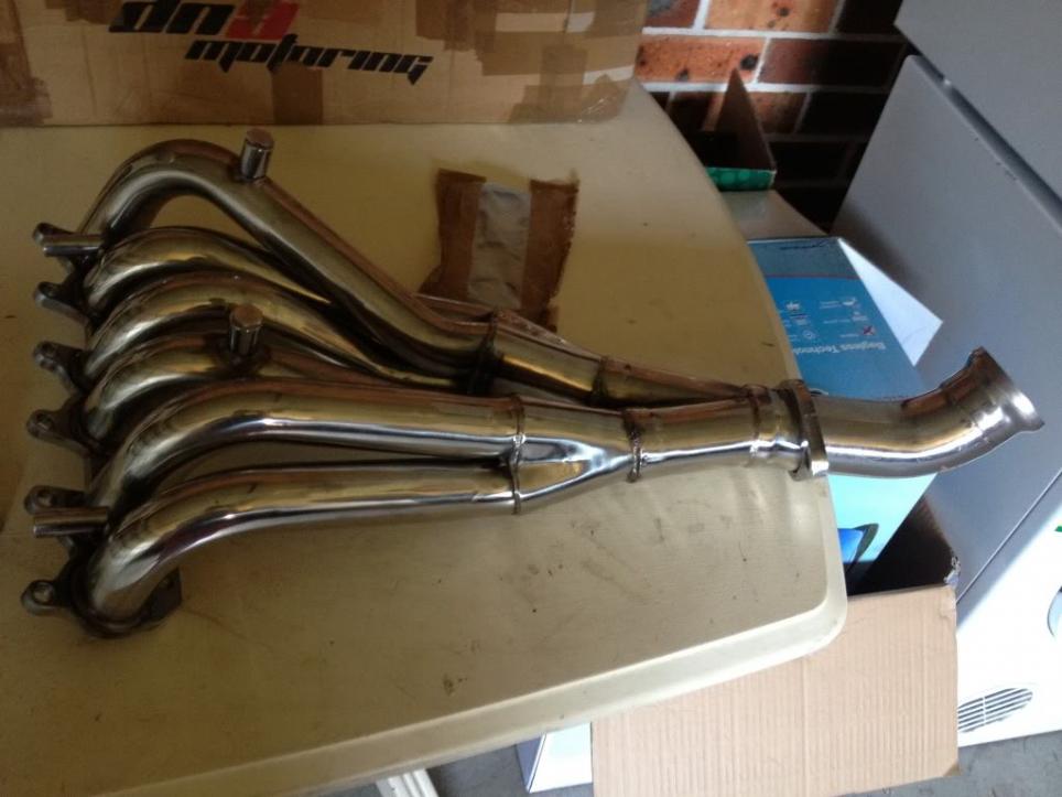

      This is straight bolt on right? It came with a flange, bolts and gaskets so hopefully I can do it myself.

        AHH.... That looks pretty awesome, dont mind me asking where did you get it from?

        • #79
          hey mate,
          I bought these off eBay, they were owned by a forum member here. No idea what brand they are or size. They were cheap so I snapped them up.
          Cheers
          • #80
            prettyyy Will be interested to see if you feel a difference, most cheaper headers for vr6's dont make any power at all. Change the sound and certainly look very nice though
            • #81
              Yeah ben, mostly for sound hey, not expecting any power gains.
              This weekend I will be installing them, im 99.9% sure they will just bolt in...that correct?
