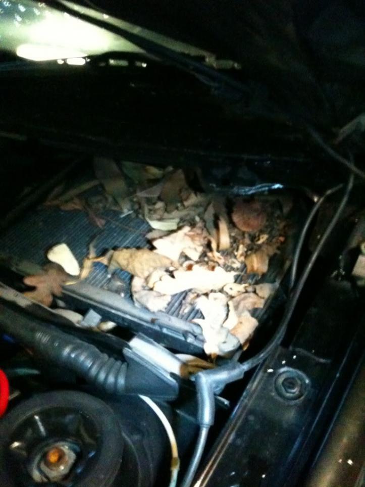

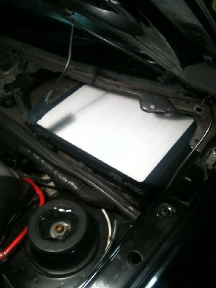

I also fixed that leak too, I managed to clean the whole left passenger side of the engine bay, near the rain tray ( thanks to the user who helped me with this) and I cleaned the whole area, dried it out, and reattached the pollen filter carrier with silicone sealant around the joins, fitted with a new pollen filter and reassembled..good as new! Now I have a bone white pollen filter, instead of a black ones full of leaves and dirt!

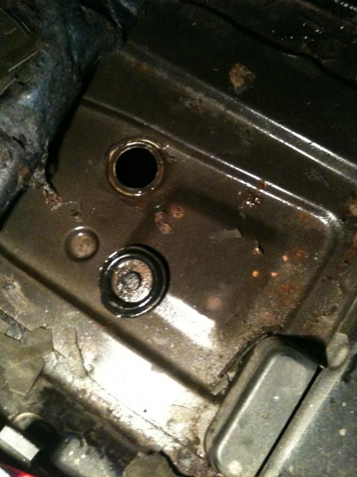

Inside of the car, where the water entered in and where is sat at the passenger foot well, I pulled out all of those rubber grommets which were old, cheesey, crusty and filthy, replaced them with new rubber units from VW and silicone sealed them too, also fitted new insulation too from the rubber/foam people; Clark Rubber.

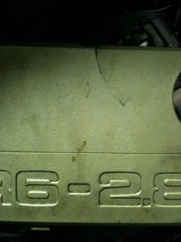

Manifold Cover? the plastic cover on the engine with 2.8 DOHC or whatever it says, has a crack through the middle, I will bog this up, sand it back and just respray it to new condition.

Pollen filter all reassembled...
Before...
After!

This was the floor pan before...
and imagine this all scrubbed up nice and clean with new rubber plugs with sealant around it..didnt get a pic.

Bogged, Sanded & Sprayed the engine cover
