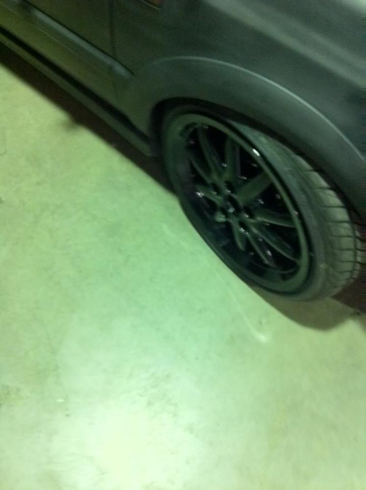

Ok this is a bit of a fake shoot - I test fitted my wheels today. In a nutshell, they rub! Bad. But I am hoping I can maybe shave the arch flares on the inside - its really close to fitting! like mm's!!
Anyway - heres a preview of how i hope my mk3 will be rolling in the near future:

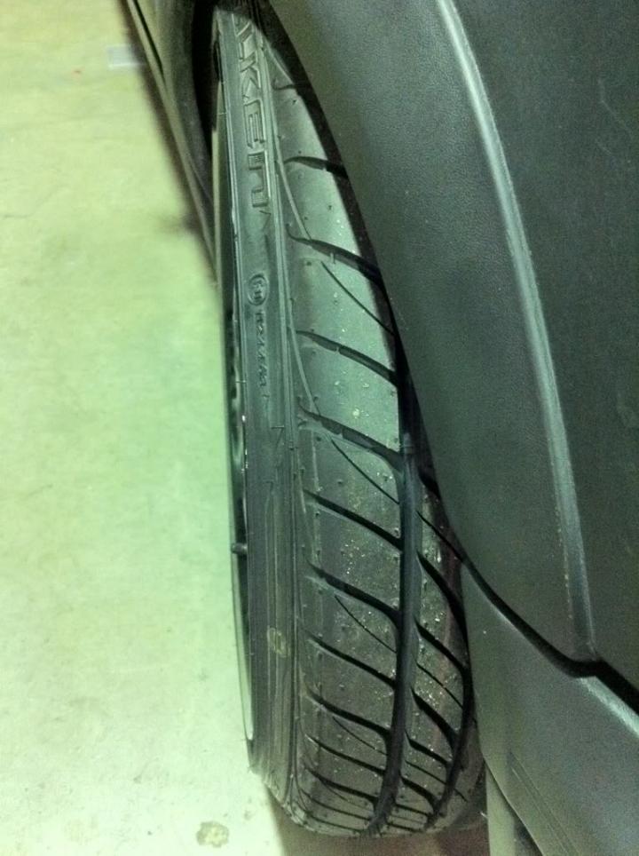

The Falkens ended up stretching pretty nice!
I still haven't washed it so she's pretty dirty
Audi a6 Boleros give it a pretty unique look - whats the verdict?

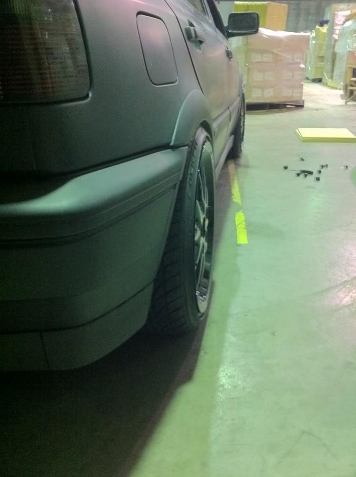

The back wheels are rubbing pretty bad - but I am hoping I can fix it.
Anyhow let me know what you think, suggestions etc. I am debating rolling the guards / removing arch flares but I do kind of like them!Last edited by dark; 03-06-2011, 01:03 PM.

I reckon roll the lips flat on the arches (metal) and then trim the trim (plastics) and stick em back on. you wont have to be too picky about rolling the lips, cause well, you'll cover the edges back up with the trims, and it's matt black, so touch ups shouldn't be an issue!

took them back off - till I can trim the flares and roll the guards - but I'll let you know when I put them back on.
I havent calculated the final offset but the bolero's have a 43mm offset, plus I'm running 15mm adapters on the front and 20mm on the back.

the flares were trimmed with a dremmel and stuck back on with 3m double sided outdoor mounting tape.Polo GTI

I did my front ones with a hammer. soon to do the back too. like this YouTube - ‪How To Roll Your Guards DIY - Mighty Car Mods (SE01 EP03)‬‏ I didnt crack the pain or anything andonly used a hair dryer. not that paint on yors would be such a pain to touch up
Up front you have to trim some of the fender liner which i did with a dremel. Up back theres some stuff in the fold apparently you can take a dremel to so you can roll them flat.sigpic
