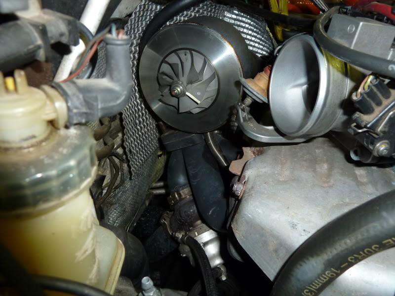

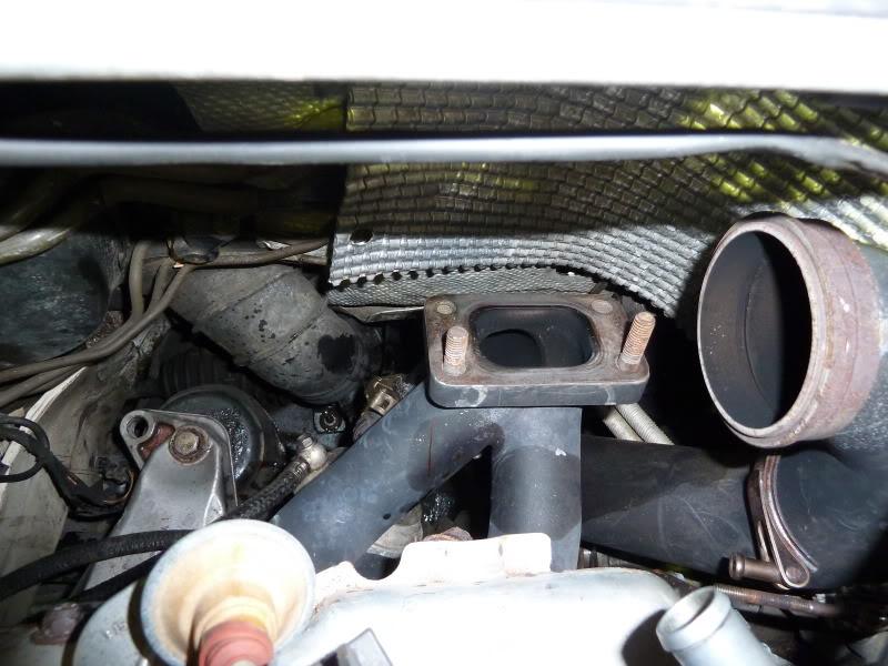

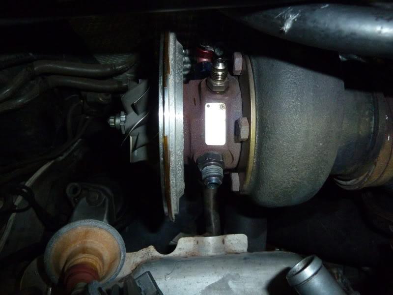

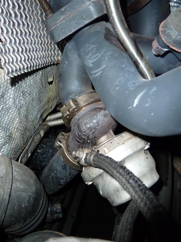

          Well I had the opportunity to take some more photos of the turbo and manifold setup this week due to having to remove the turbo to repair the turbo coolant hoses that had been affected by the heat. The high quality coolant hose that I had used just went hard and crack causing a nice steam haze on the way to work on wednesday.
          They give you a better idea of how tight it is behind the engine when you put a GT30 back there.
          • #20
            are those tri clover clamps i see there
            iv never seen them on a car before
            thats a good idea for ease of removal

              • #22
                Yeh they are, but using nut and bolt rather that the wing nut versions that I've seen

                          • #28
                            I should do this more sooner than later that thing looks awesome . i was thinking of using a gt3582r but since a gt30 is pretty tight in the might have to change plans. ohh and what made you not use a short ram intake like SP and other brands ? wouldnt that free up some space out the back ?
                            94' Golf Mk3 Vr6
                            • #29
                              Dont get me wrong, a gt3582r will most likey fit. Just not using stock exhaust manifolds and intake like I did.
                              The stock intake is better for bottom end torque than a short runner setup, being a daily driver at the time it didn't make sense for me at the time. Plus they were all damn expensive at the time and still are. Unless you make you own.
