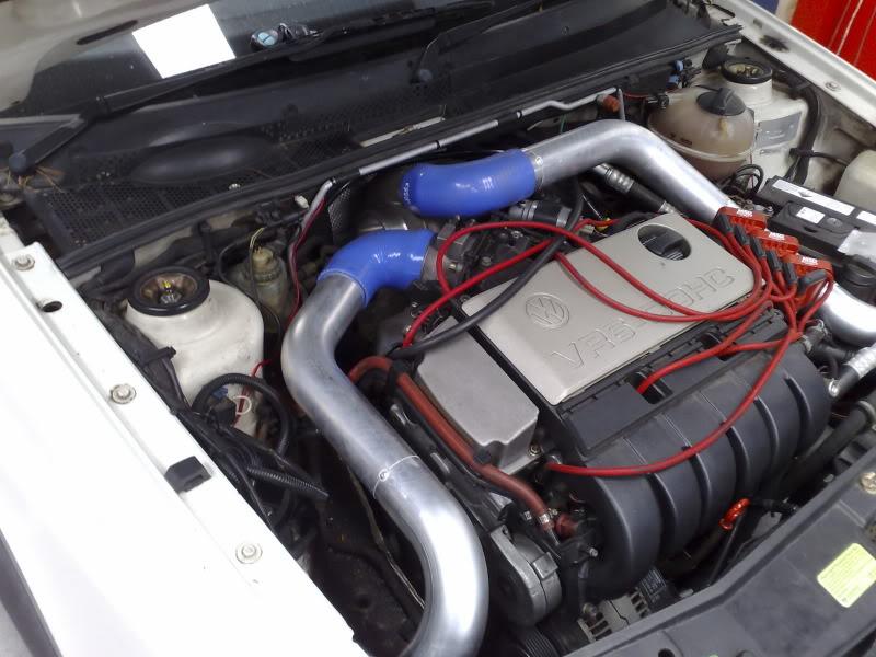

    As some of you may know there are not many turbo kits that fit nicely on a RHD VR6, and I don't personally like the ATP 12V manifolds. So that didn't leave many options, well one in my opinion. All the pipe work, exhaust manifold and intercooler would have to be custom made This work I was unable to do myself, so I got ASE (Auto Sport Engineering) to do all fabrication. Unfortunately in speaking the them recently they have stopped doing all custom work, bummer!

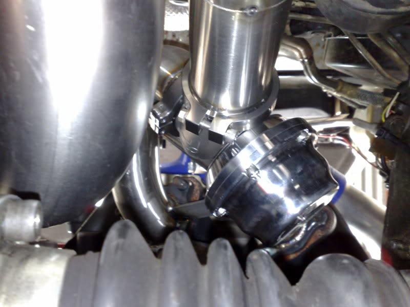

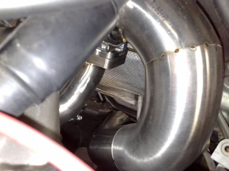

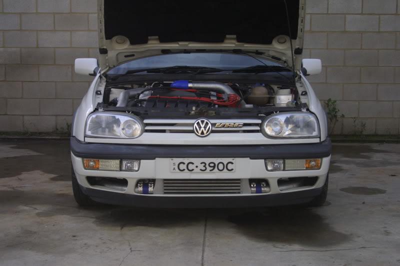

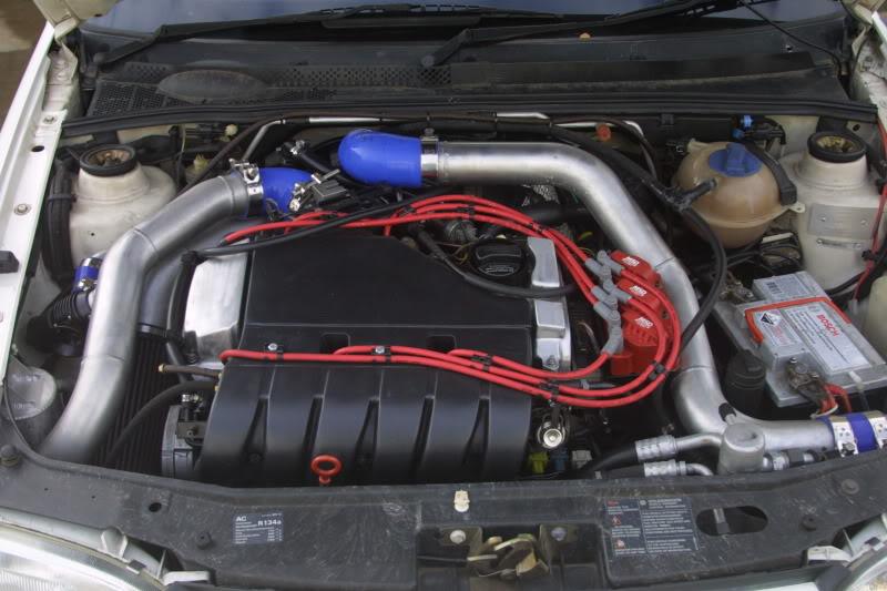

    I decided to keep the stock cast exhaust manifolds and just have a 'Y' shaped manifold made to fit the GT3082R (like what EIP were doing years ago) into the screamingly large space behind the engine. 3 inch aluminium boost pipes into a custom FMIC running back to the stock intake manifold. 3.5inch K&N pod filter near the stock location. Turbosmart 38mm dual port blow off valve and a Tial 44mm? external wastegate.

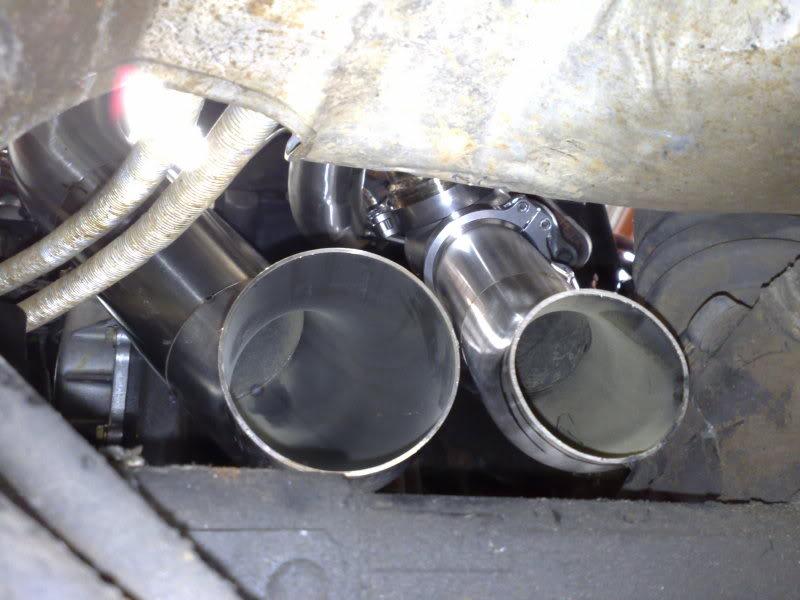

    3inch v-band downpipe ceramic coated aswell, into an optional 3inch high flow cat or 'test pipe', through a full custom 3inch system with a high flow muffler at the back and down turned tip, in an attempt to make it a little quieter.
    Custom oil cooler, as there is not much room left in the front of the car.

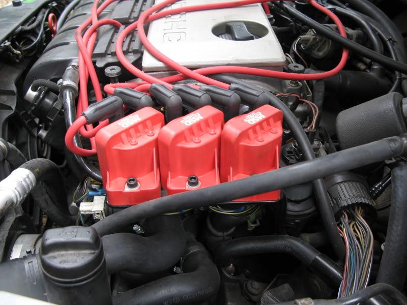

    An Autronic SM4 takes care of the engine, running Siemens 660cc injectors at only 3bar (flow tested at about 700cc@3bar). MSD ignition coil mod, using custom MSD leads and some special ignition modules.
