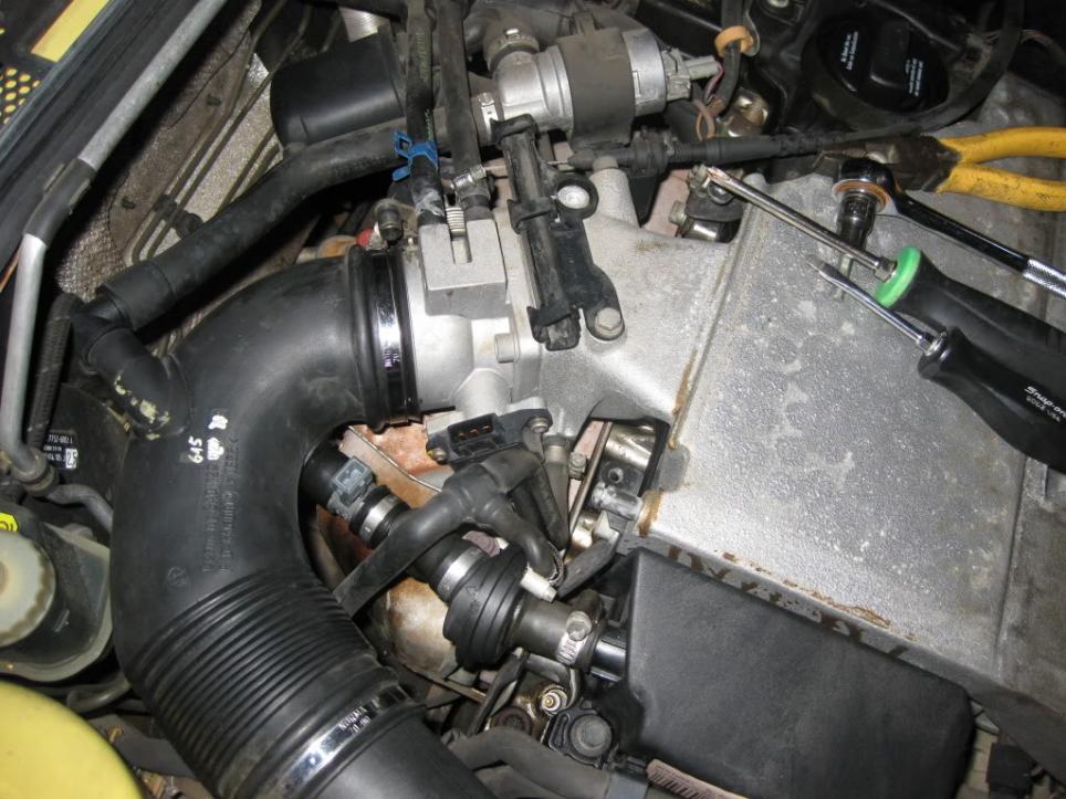

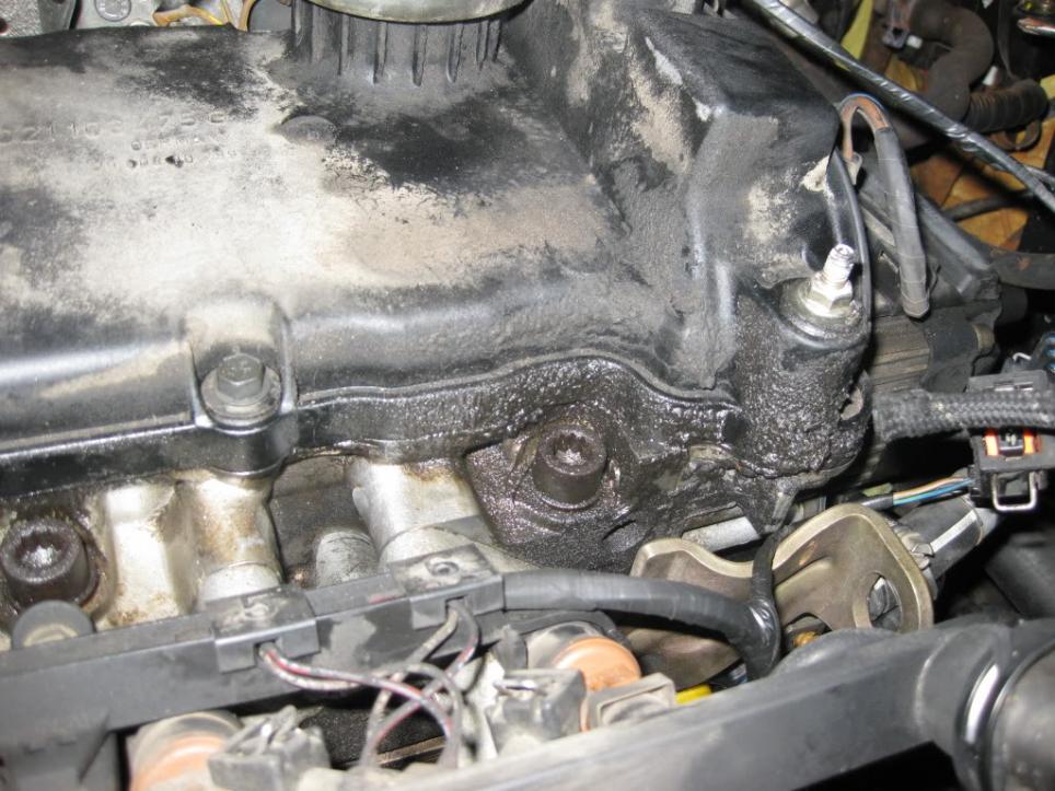

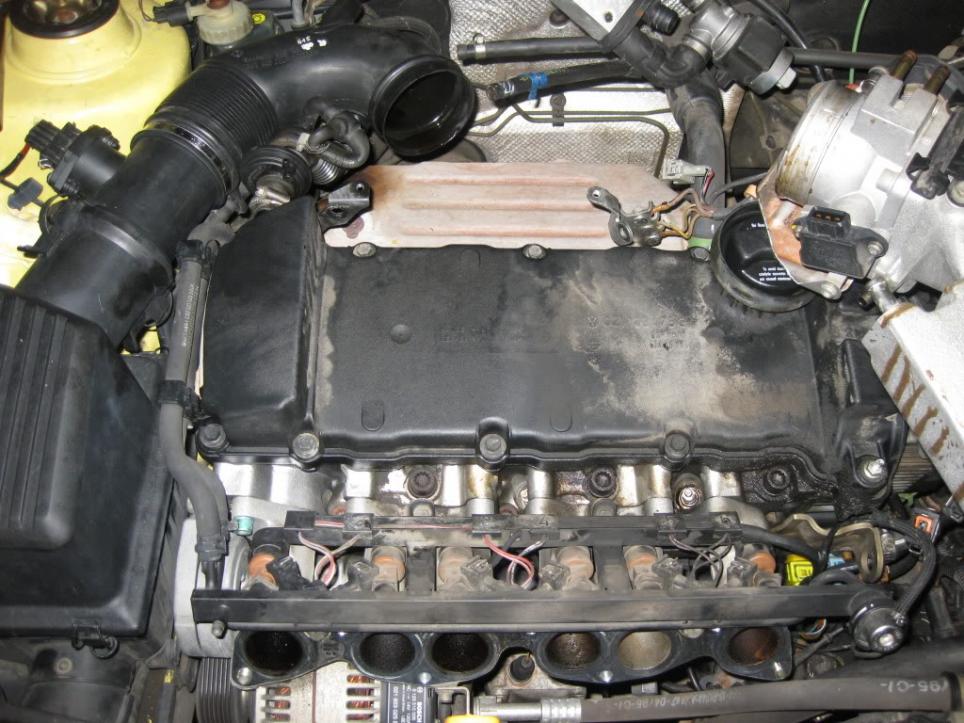

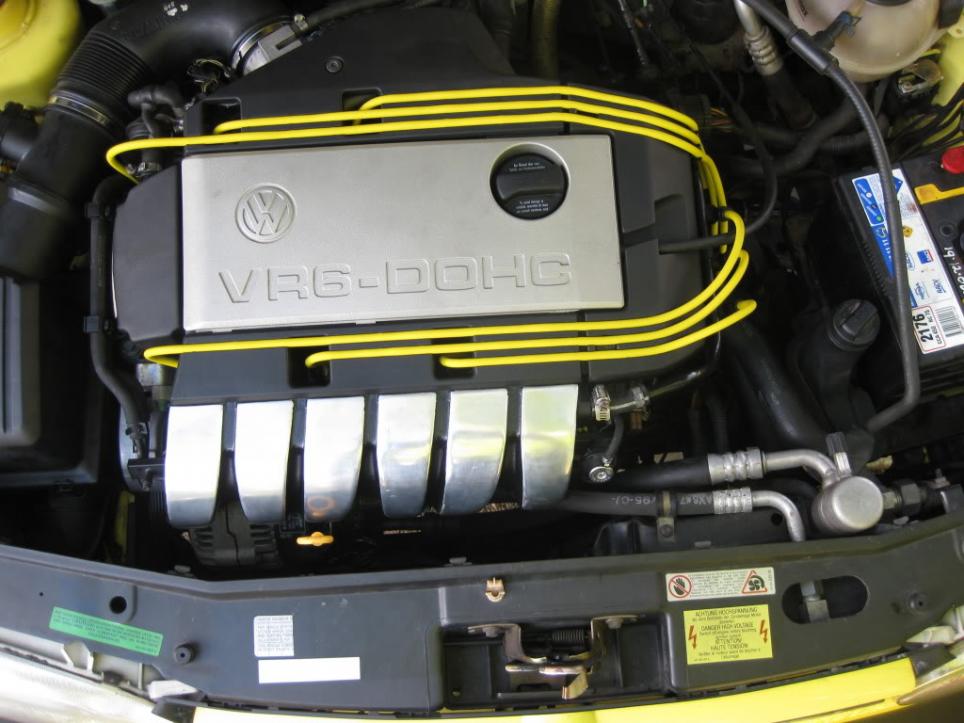

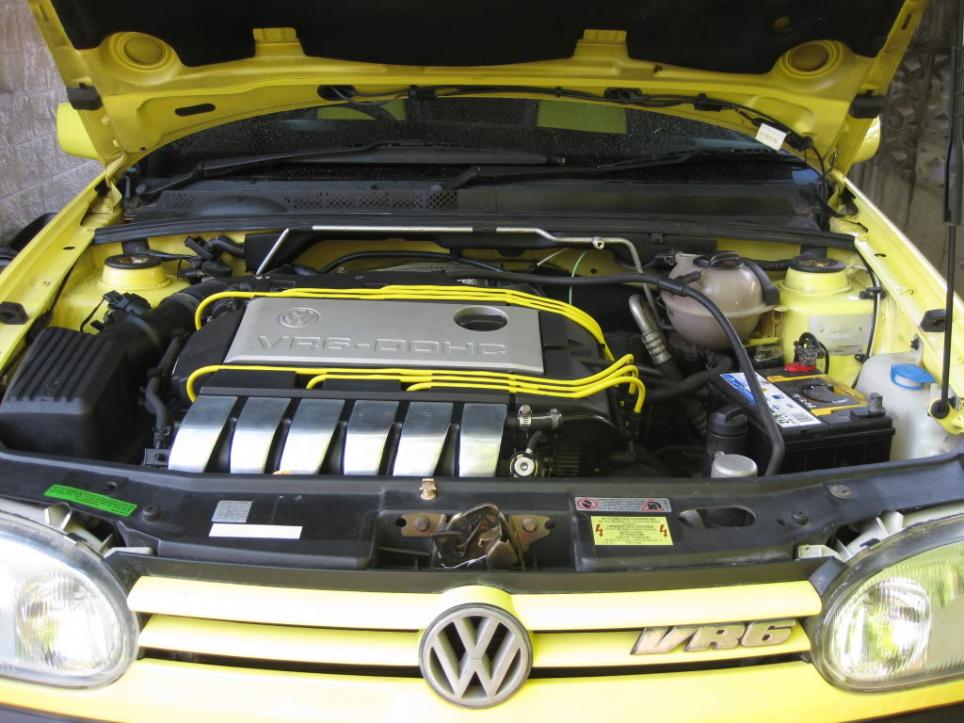

Looking damn nice, I'm amazed at just how clean it's coming up. Good to see another member not afraid to take to their car with some tools and tear it down

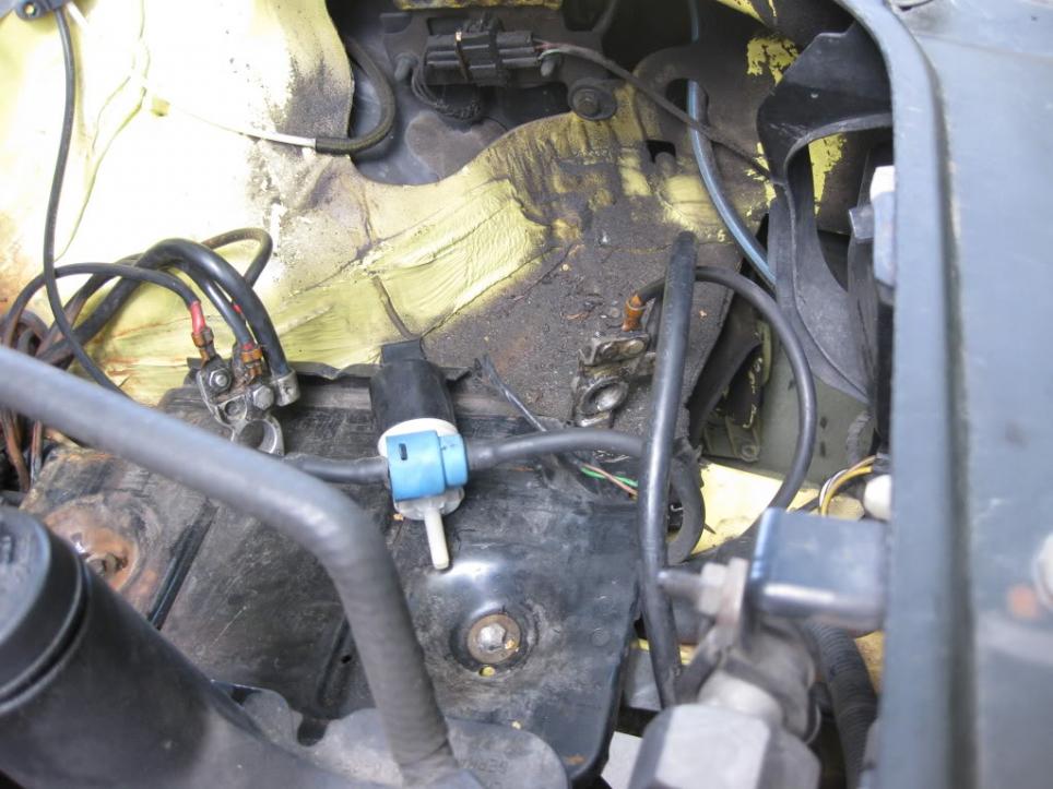

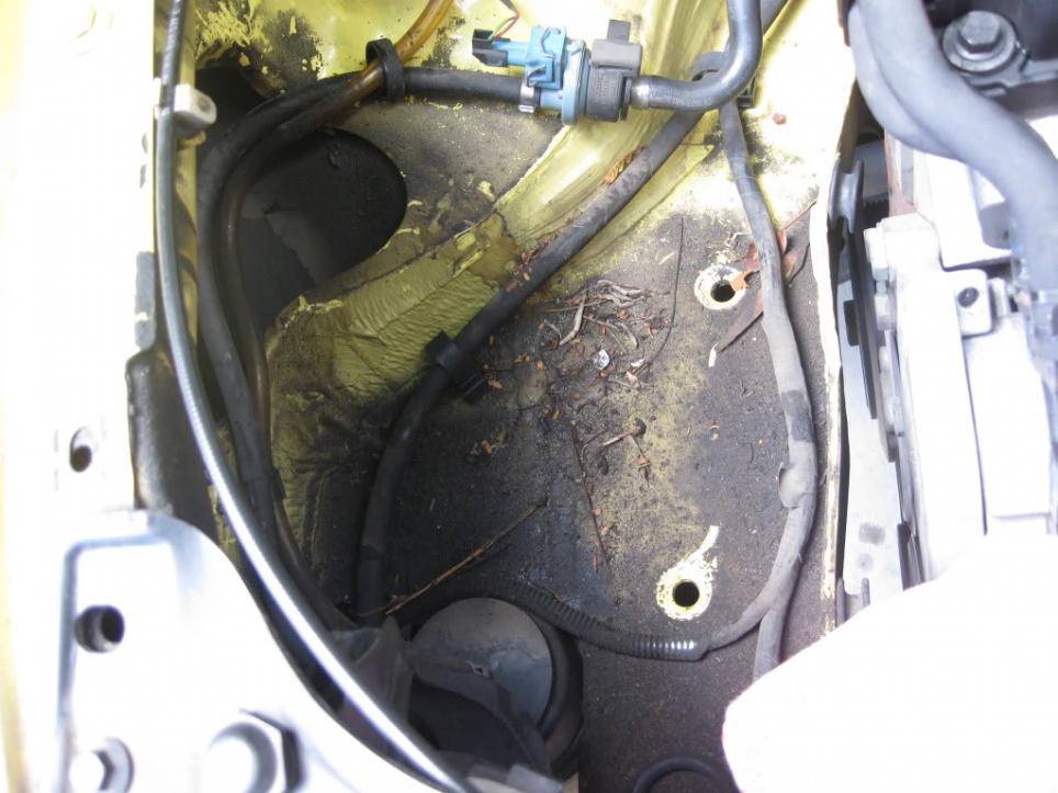

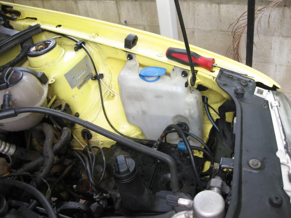

Cruise control, much like the central locking is a vacuum system. The pump is in the passenger side fron quarter behind the washer bottle. First things fist I'd check to see if you can hear the relays clicking as expected when it's turned on and you try to set it. It should also click off when you touch the brake or clutch. If the relay is clicking it's an air leak you need to hunt down. It my case I was lucky and it was easy(ish) to get at and fix.
