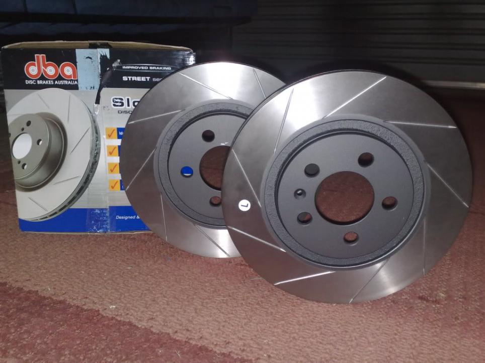

        Originally posted by VOLKSMAN View Post
        Oh man they look real good! DBA are always quality
        Let us know how you go when they're fitted!
