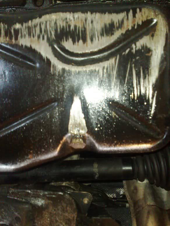

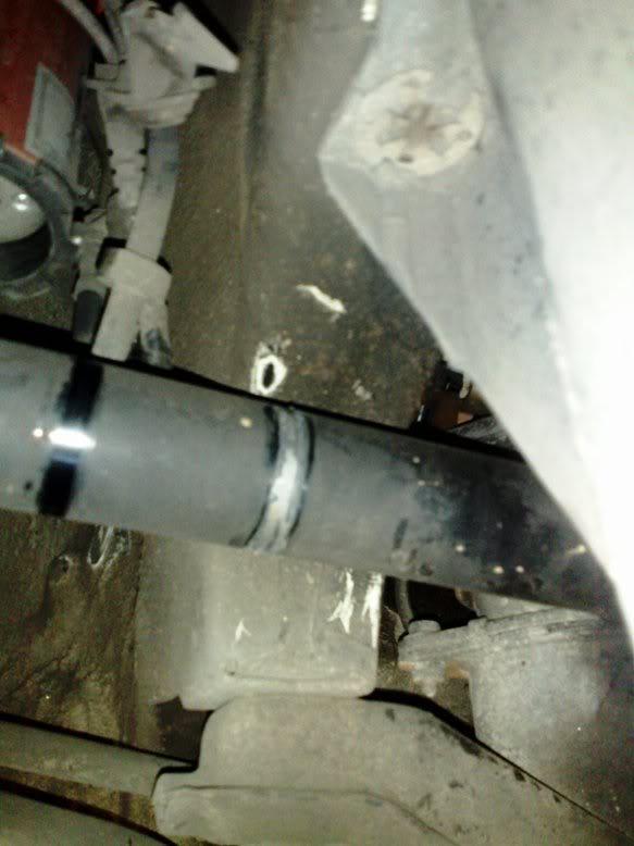

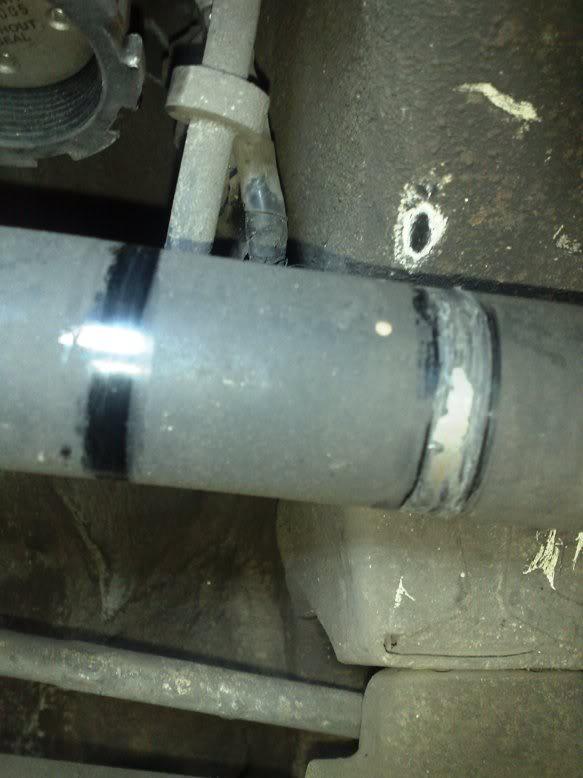

            I got a look under the car today, as it was on a hoist and it was noted that my drive shaft hits the chassis when i hit bumps which isn't the best. Here are some pics. As it stands its only rubbing paint off my 2 month old driveshaft... hopefully it doesn't get worse.
            and heres one of my battering ram
            i mean engine sump

            • #51
              Get a skid plate lol
              • #52
                why not just sit them higher, a skidplate wont solve the driveshafts from lathing
                ~\\VoLkS//~\\MaN//~
                • #53
                  marty mate, not exactly good, do something about the drive shaft, it's not going away! Did you go to brads work?

                    a skit plate will make me raise up the car... which means that there's no point in putting it on i might as well just raise the car up

                    what i've done is i've adjusted the travel, and suspension hardness. just when i thought it couldn't get any rougher. hopefully this stops it from going to high up when i hit a bump.

                      Marty well done there is only one thing that you really can do at this stage mate, notch the rails

                          Have a look at vortex there are plenty of people that do it and proven it. Plenty of travel and you won't bend drive shafts!
                          It will require some welding but apart from that not to hard, I have thought about doing it to my car, still undecided.
                          Apart from that careful of your sump plug its getting pretty thin by the looks of it, just to let you know. If you can get another one and cut the plug out and rreposition it to a higher position!!!

                            Lovin the driveshaft Marty
                            God knows how stiff your car is now, but hopefully it will stop acting like a lathe on the drive shaft...come to think of it, thats quite a good way to lighten them

                              Let the driveshafts self-clearance themselves - mine rubbed at the same point as well but it got to the stage where it stopped rubbing on the frame haha. I'm worried about the first mark though - what's rubbing on that? And how about your tie-rods? Are those rubbing?

                                oh thats good to hear. i wanted to hear that. The other line is rubbing from a zip tie on my brake line. i'm not actually sure why its there. Its probably holding my whole car together. i looked at The tie-rods, and couldnt find any evidence of rubbing. thankfully.
                                Will do!
                                oh thats smart...yeah i might replace that/modify it.
