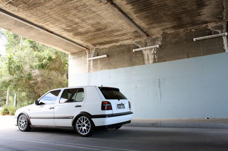

                      Hey dude, I got 16's cos I didn't want any bigger and also because I found what I reckon to be the perfect VR6 OEM look...
                      Shameless whore-out:

                        i do like urs mickey. who made them?

                          Technically, if you go from your stock tyre size (205/50/15) to a 16 inch size in the same diameter but a smaller profile (205/45/16) you stay within 3mm of overall rolling diameter. That means that the wheels with the tyres on will be 3mm different in diameter...
                          Nothing worth losing sleep over if you ask me! It's only the width and offset of the wheels themselves that you need to worry about, because I can guarantee you these wheels I've got are identical to my stockies, and both don't rub.
