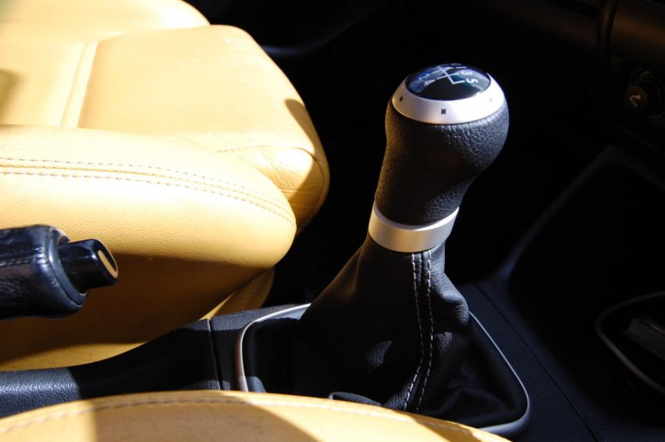

Having a complete lack of an install guide I've decided to make my own with proper pictures and instructions on how to fit a MKIV gear knob on your MK3. This took me about 30 minutes including buying the small hose clamp required.

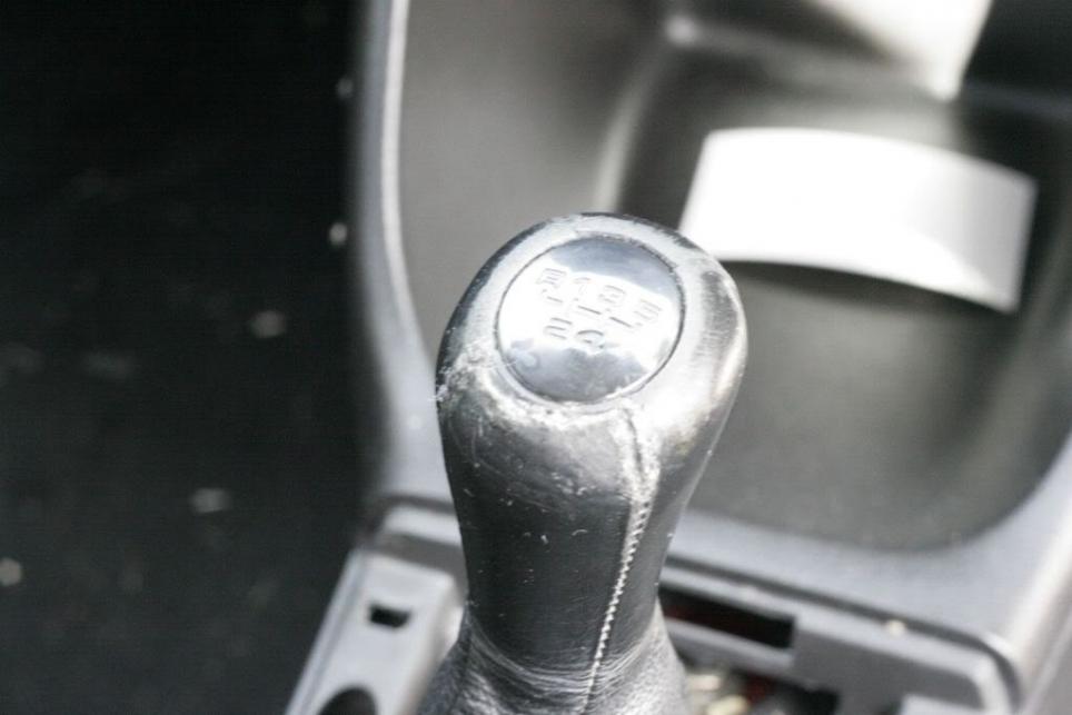

So here is the first step: Observe how atrociously bad your gear knob is and decide to get a new one!

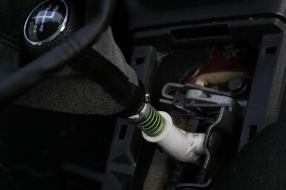

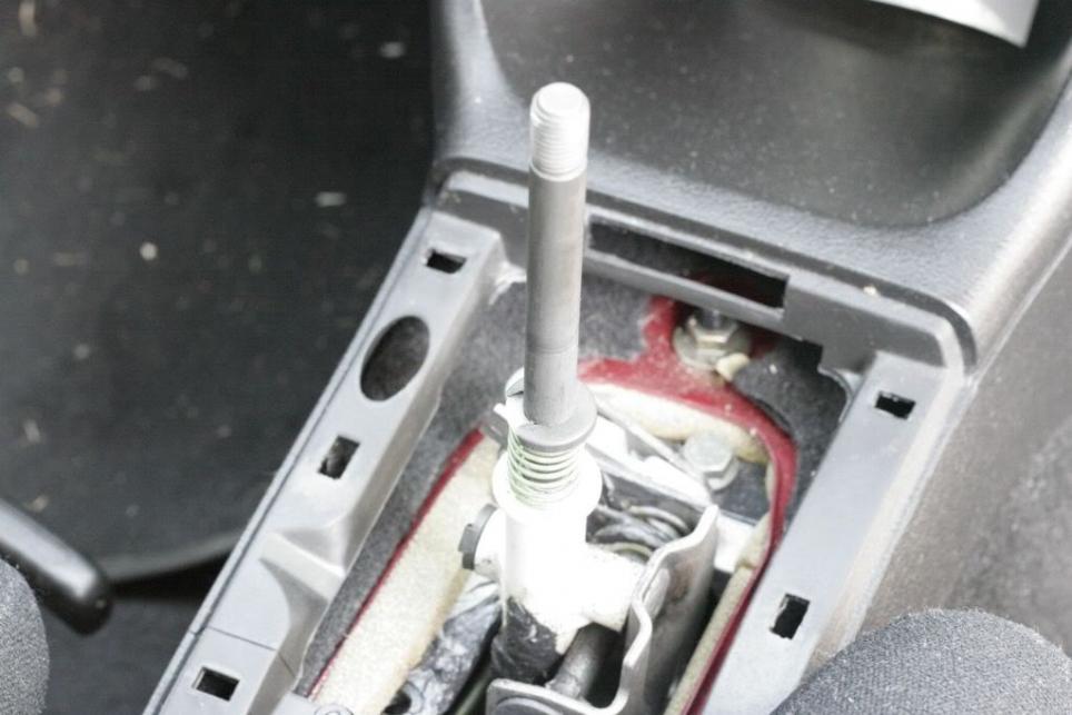

Secondly: Remove your old gearknob and/or gaiter by unscrewing the old knob and pulling off the gaiter from the shift gate trim:

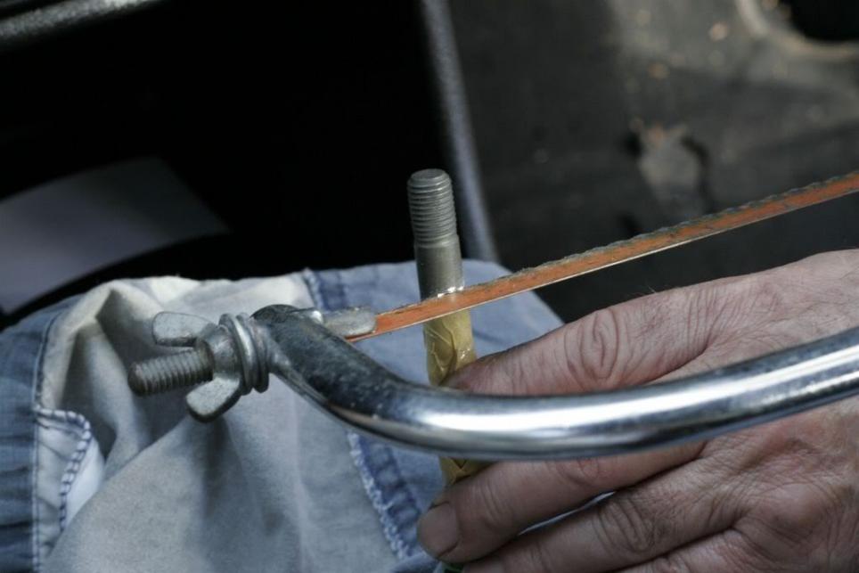

Thirdly: Measure 35mm from the top of the shifter rod and mark the distance with a piece of tape, then begin to cut it with a hack-saw:

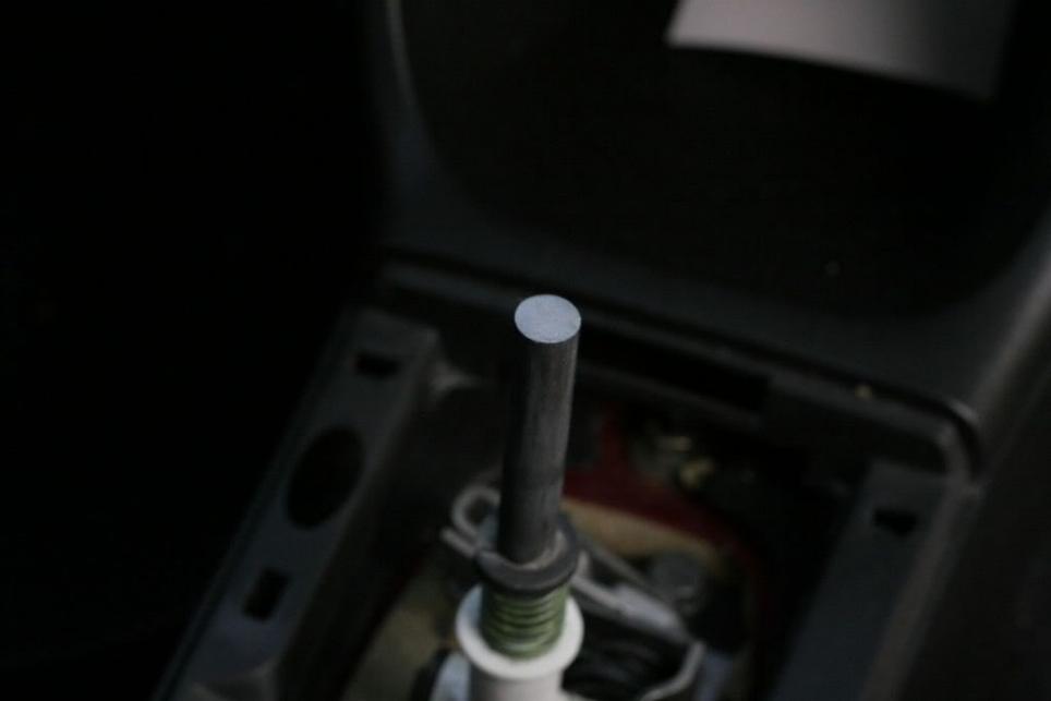

Fourthly: File the top of the shifter stalk until its flat and you have reached the 35mm marking. Remove the tape and sand vertically to make the surface and bit more abrasive and remove any sharp edges:

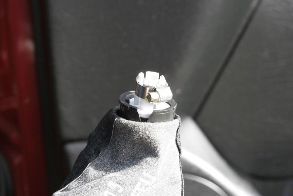

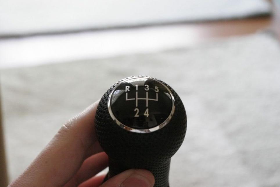

Fifthly: Insert the hose clamp over the bottom of the shift knob as seen here:
Sixthly: Push the gearknob over the shaft and position correctly, then begin tightening the hose clamp until its secure:

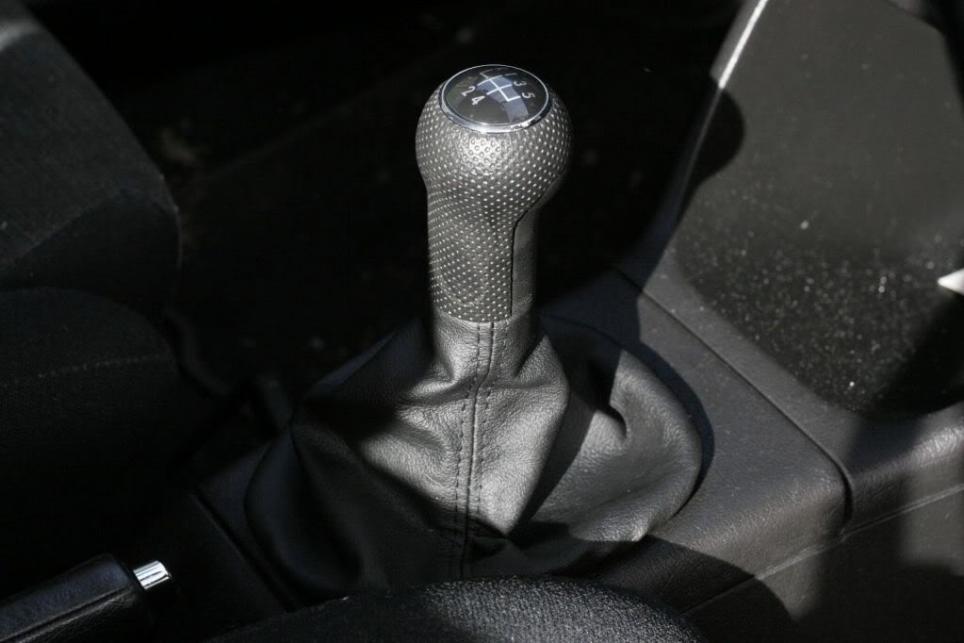

Finally: Re-insert the shift gate trim and pull the base of the gaiter over the trim and it should hold well, and ENJOY
