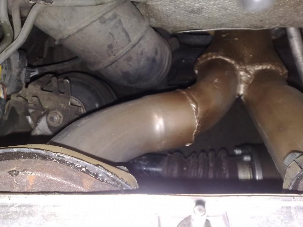

      Custom exhaust downpipe

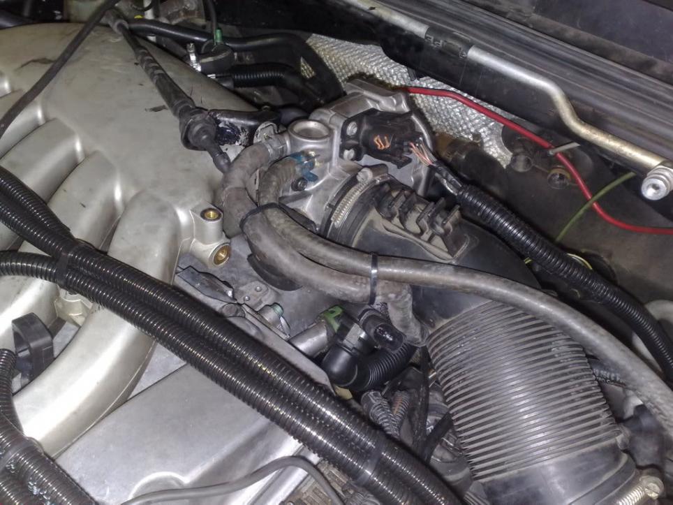

      Throttle body off a 1996/7 VR6 fits the bora manifold. As this car is a 1995 there was some wiring involved to make the later throttle body wiring behave the same as the earlier.

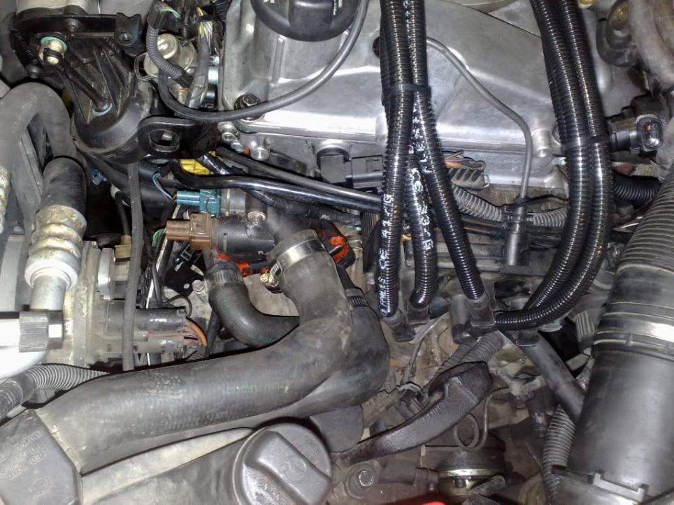

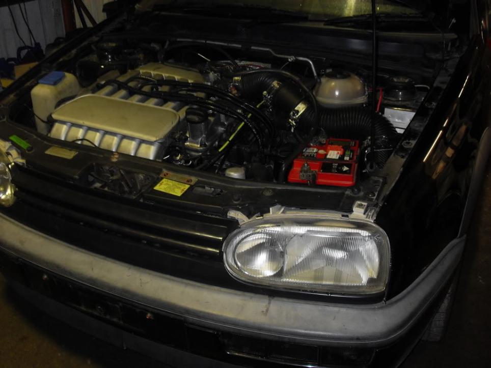

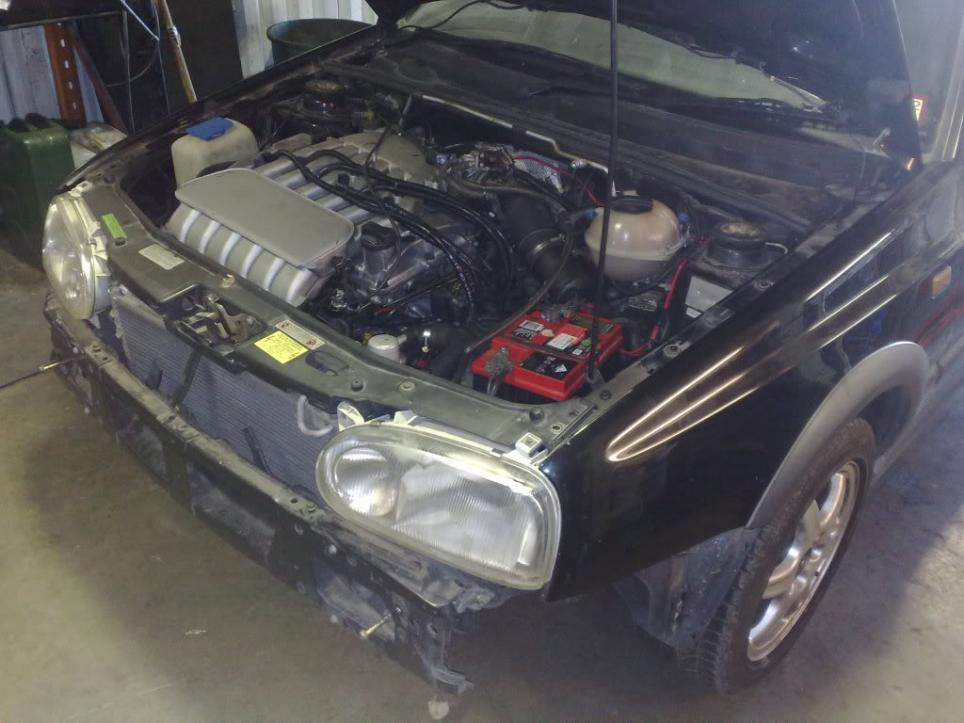

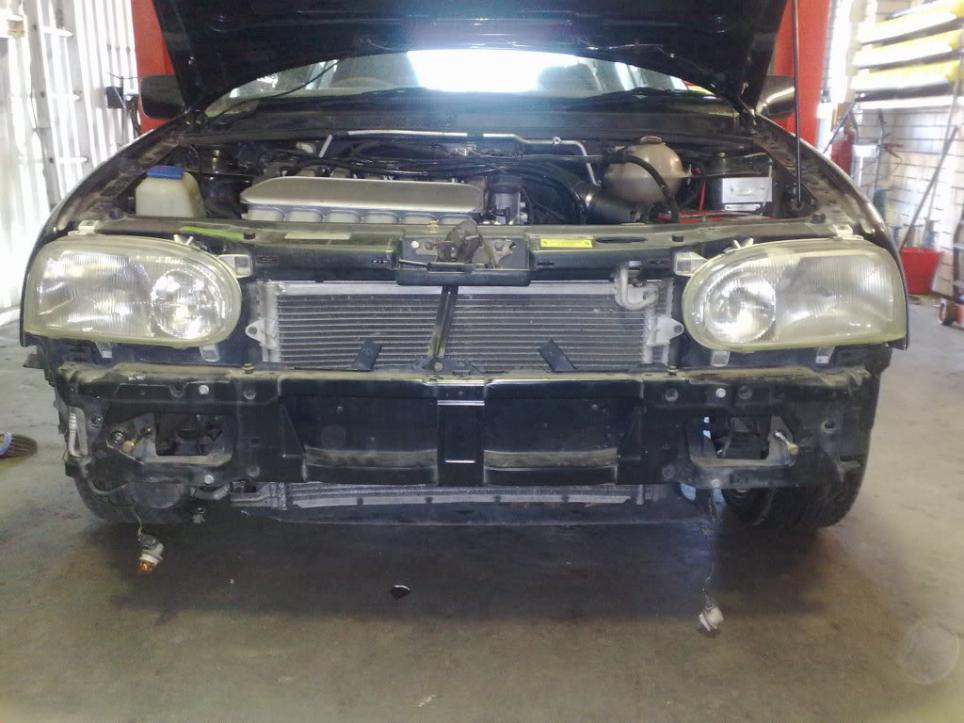

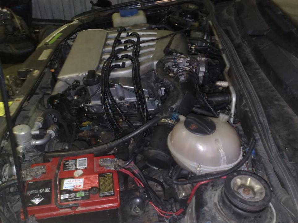

            Guys, i finally got to take some snaps of the car now with its font-onish and it looks like it getting there, some minor hiccups are present however like any first swap like this, there is prone to be more.
            Pictures show a bit of the custom downpipe, quality of the Beru leads and pretty much the whole setup.
            enjoy....
            front ender with the new heart.
            custom downpipe
            intake setup with throttle body
            coil pack (ignition system)
            side on view relocated washer bottle

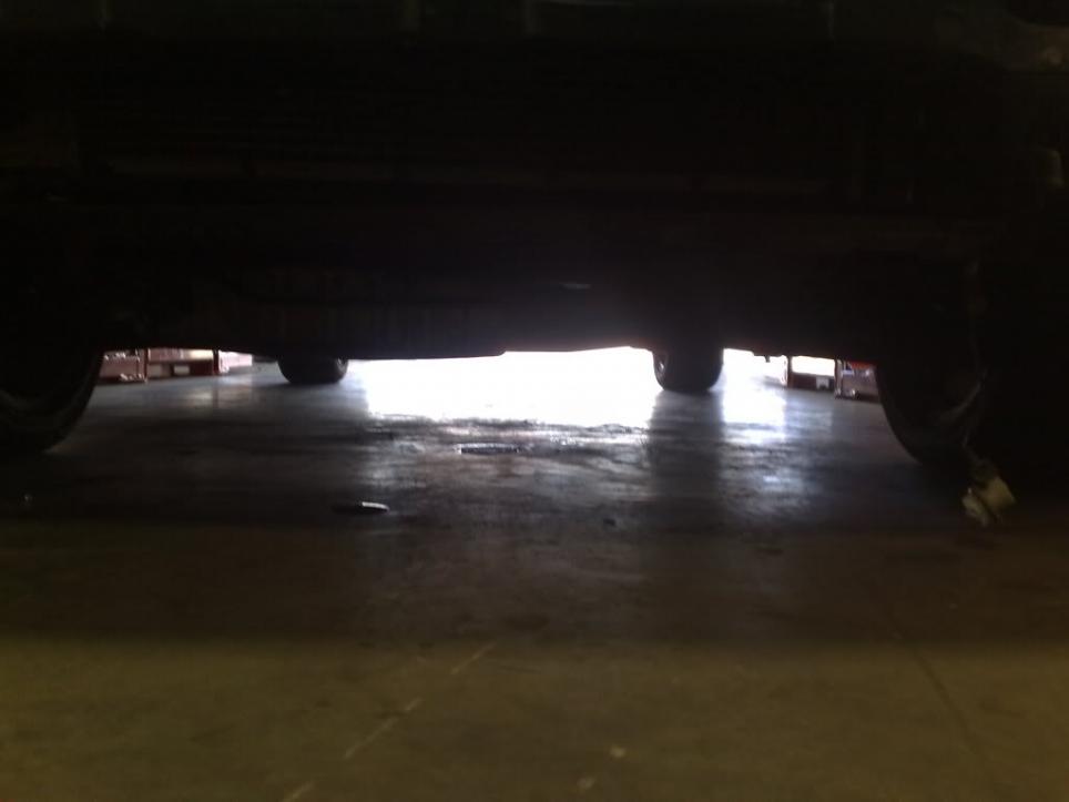

            sump clearance (pretty low at factory height)
            and finally it revving on video enjoy.......

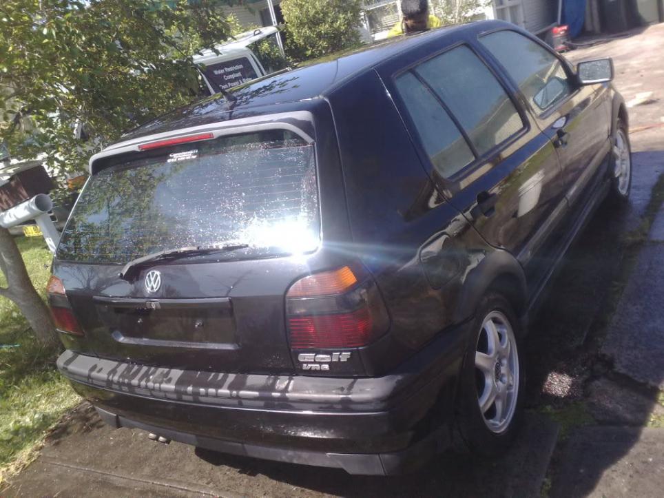

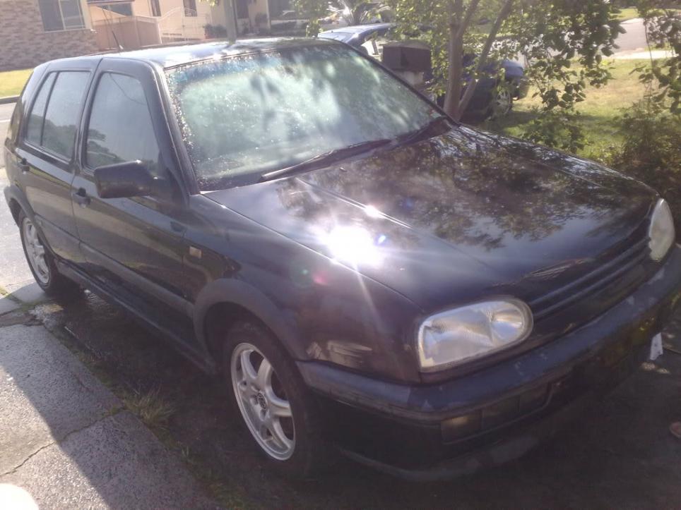

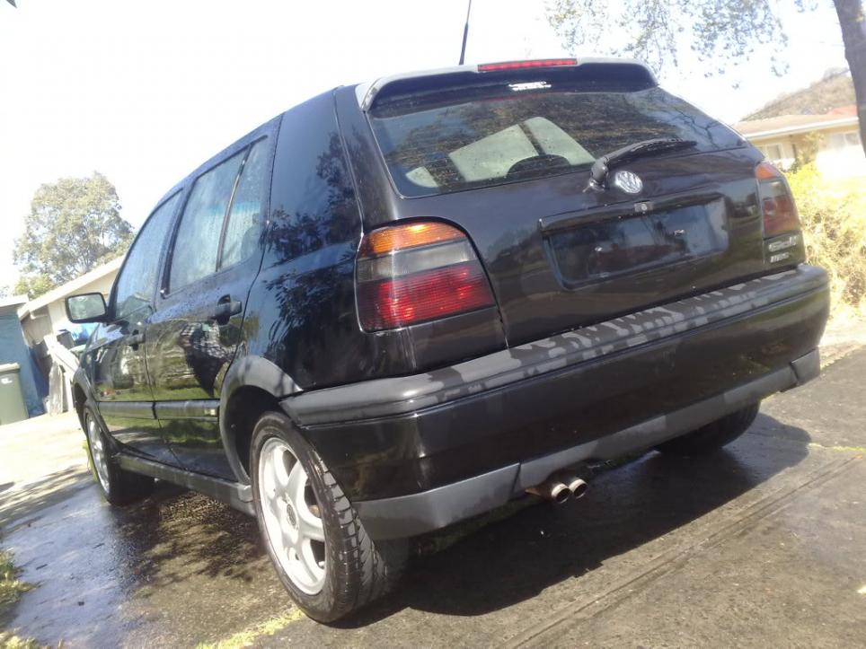

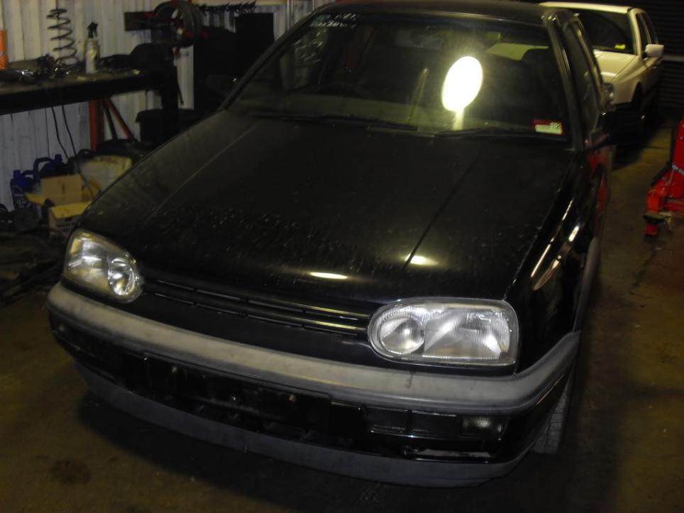

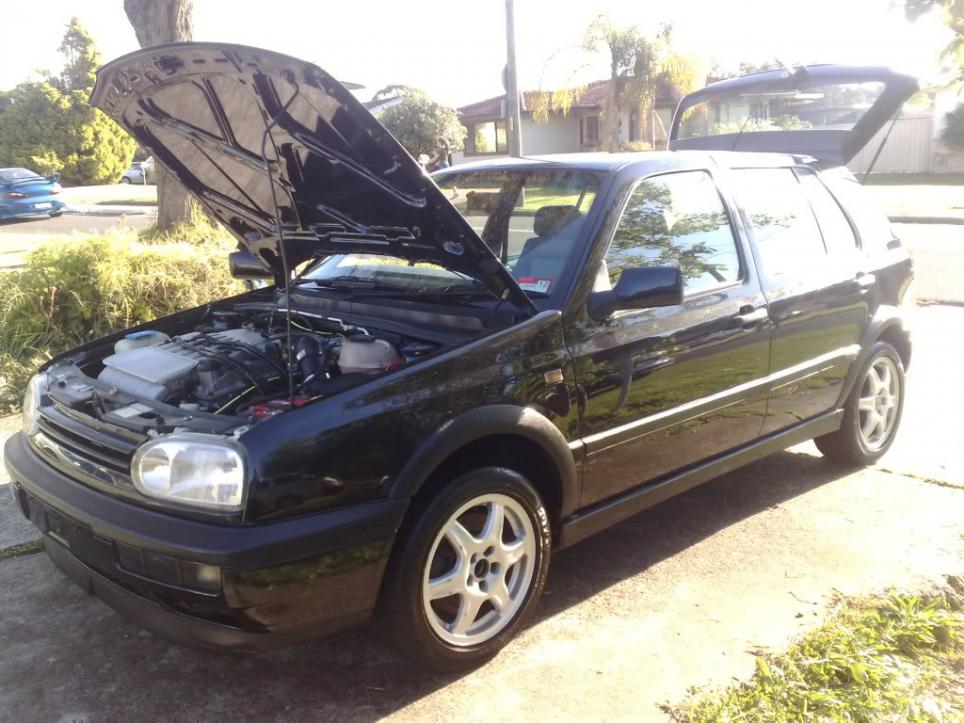

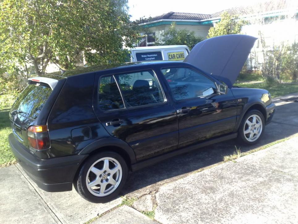

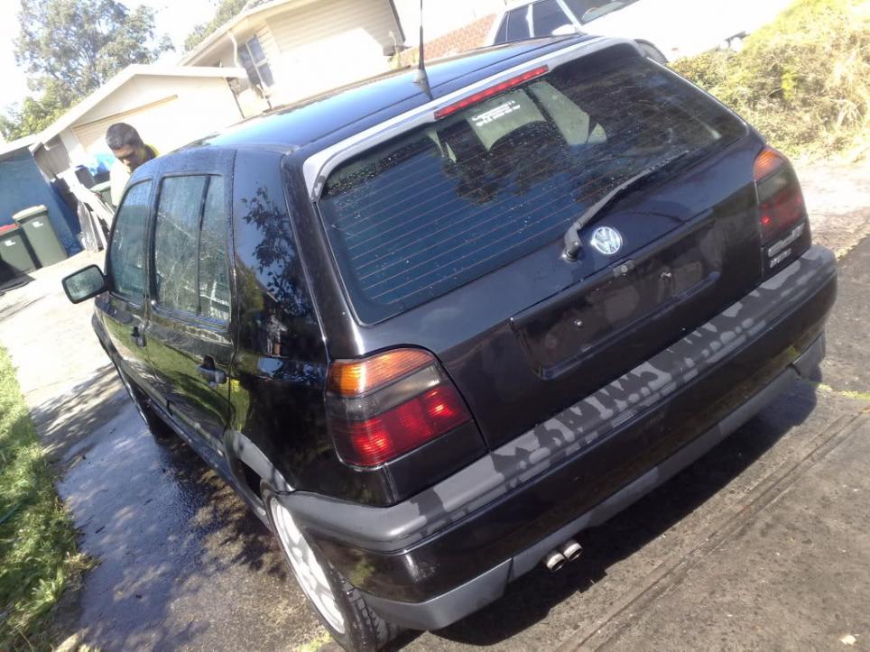

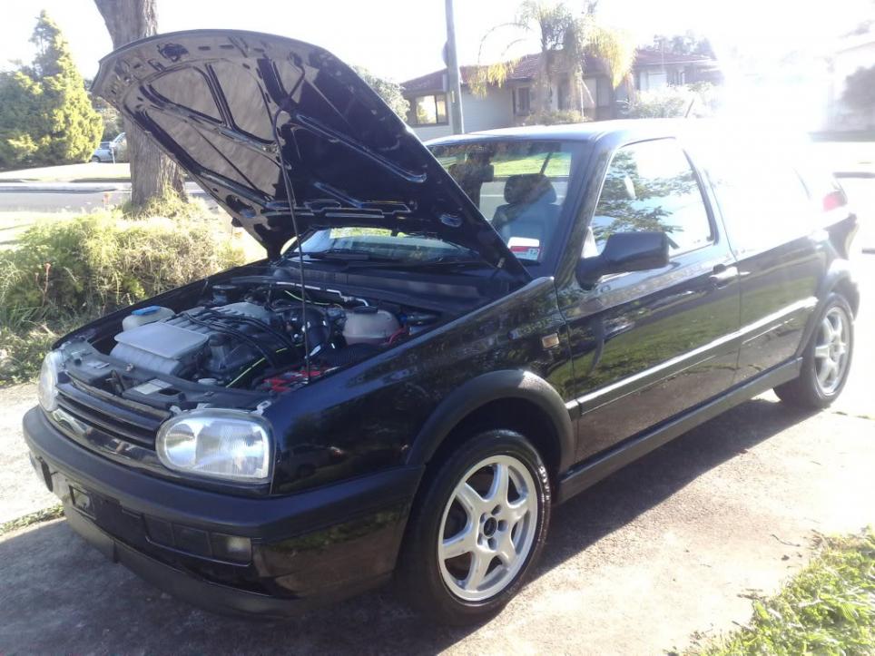

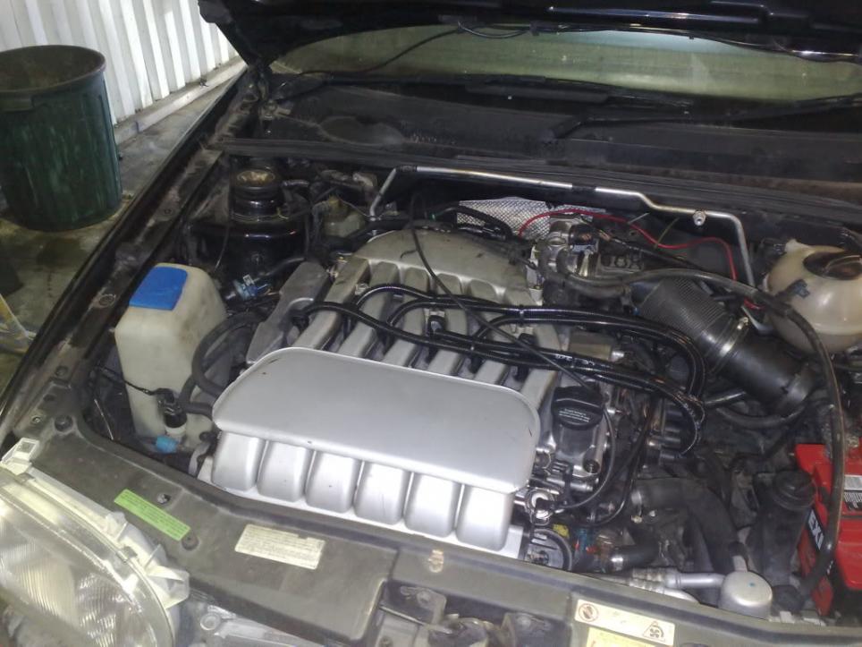

                      A few sneak pics, dont wanna steal your thunder and sorry for the dusty and dirty condition of the car, you can tell its been sitting for a while.
                      Thanks for the kind words man, glad it is going ok.
                      Now detail it, rego it and drive the thing
                      • #41
                        geez its a messy engine, pipes and wires going everywhere
                        but performance-wise should be a blast! Good work
