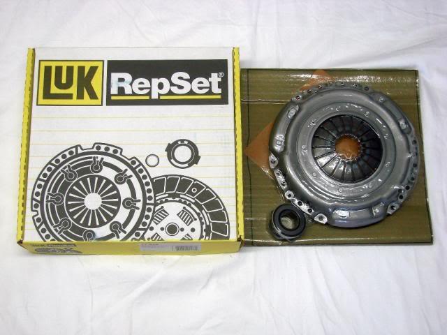

What flywheel/clutch are you using ?Euro Revolution - eurorevolution@live.com.au

while engine was out i took advanatge and so matt had changed the clutch to a LUK oem clutch equivalent to a sachs which are famous for their strength and clamp holding abilities (With a torque rating of near 300 ft/lb) you cant go wrong.
the standard 228mm flywheel is being used and will hold up well for this conversion.~\\VoLkS//~\\MaN//~

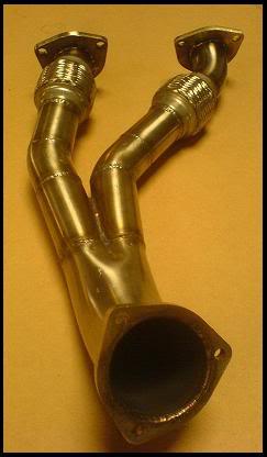

for the exhaust manifold im getting a custom y pipe (downpipe to mate with the 24v manifold to the factory cat back system.

heres a pic of the downpipe to connect from 24v headers to 12v cat back
