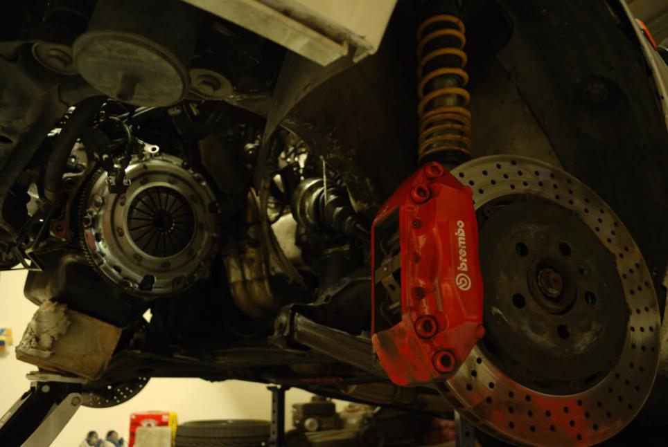

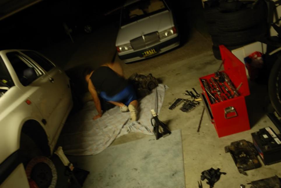

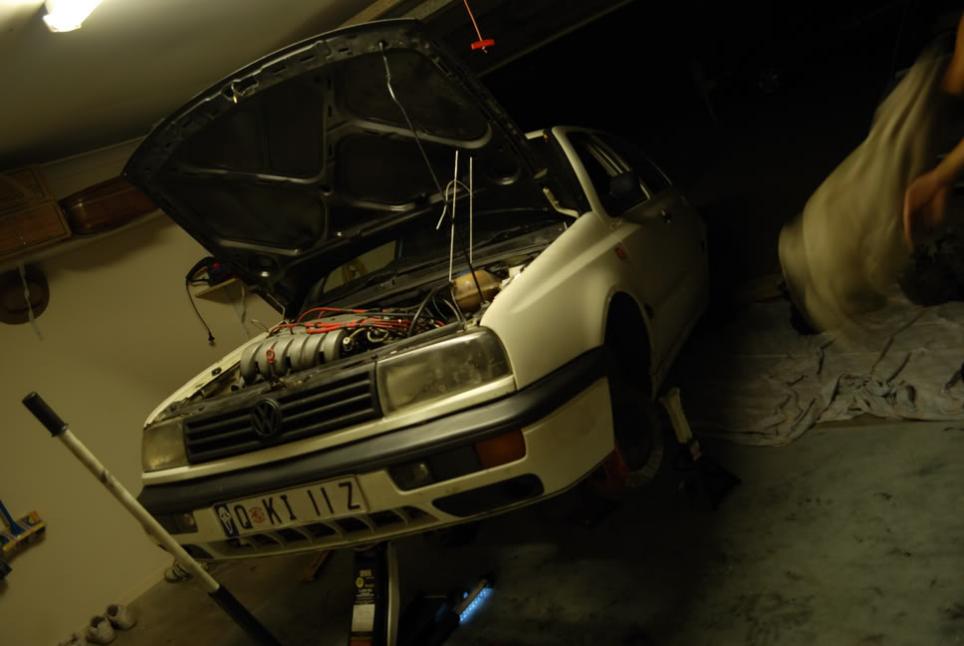

    i blew the gearbox that i bought of matt with the o2o gears! havnt pulled it apart yet to see what's gone wrong, So now i've got the standard box back in . . . . some pics for fun
    Jacked up and ready to go!
    Gearbox-less

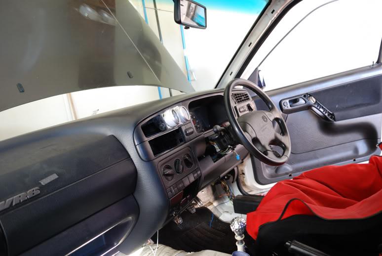

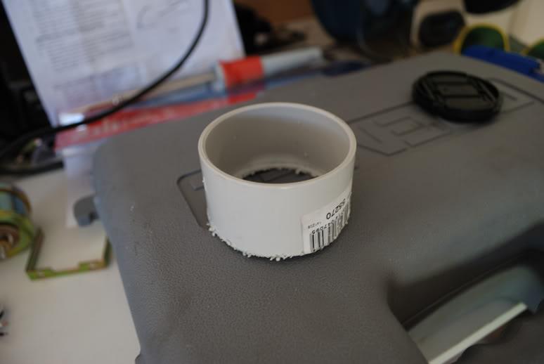

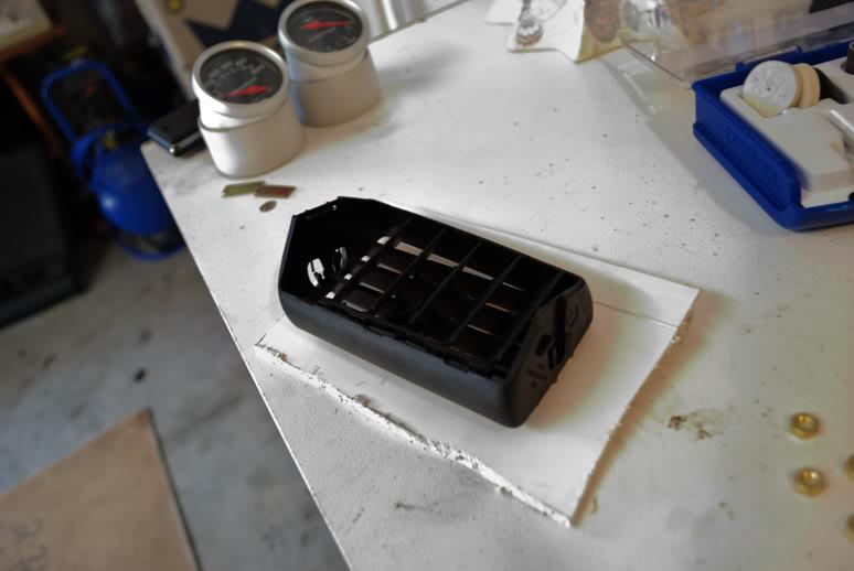

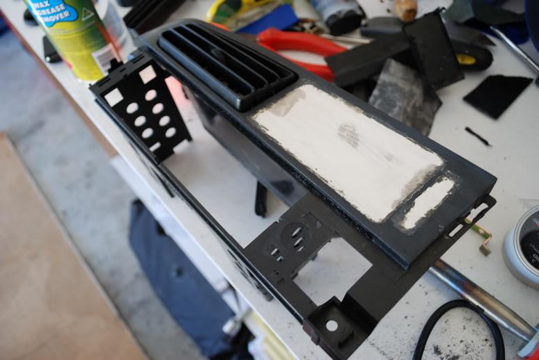

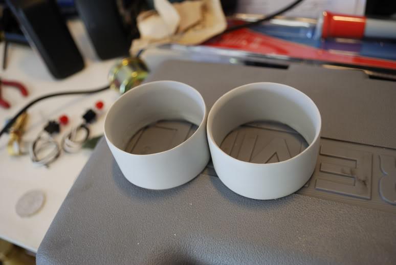

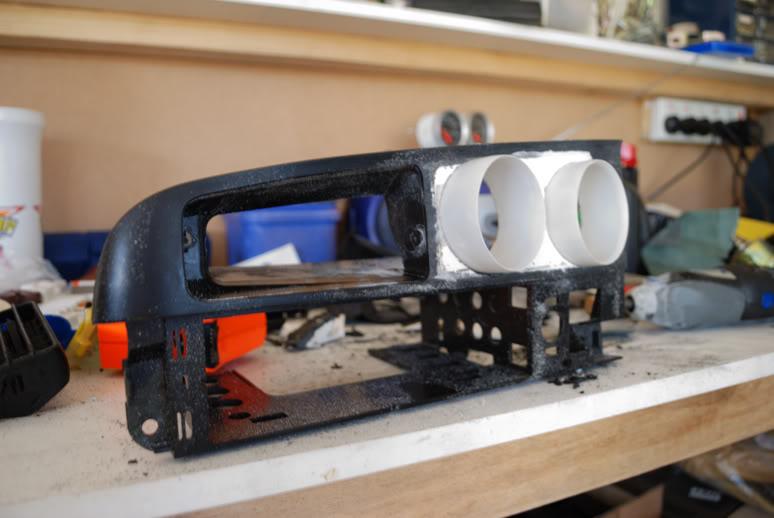

        I bought myself two Stewart Warner 50mm black face oil temp and oil pressure gauges now my dilema was that i wanted to mount them as high as possible without mounting them on top of the dash; First thought was to buy a 3 gauge single din plate that clips into the radio slot, but was too low for me . . . So I had another thought of mounting them into where the air vent is i bought some 50mm pvc pipe and a lil flat piece of plastic, pics . . . . .
        PVC pipe
        I shamfered the edge so the gauges would sit nicely in tem

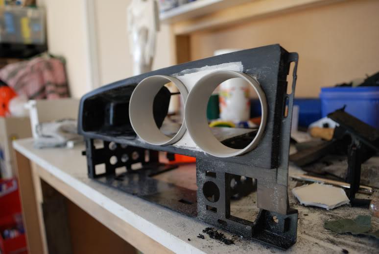

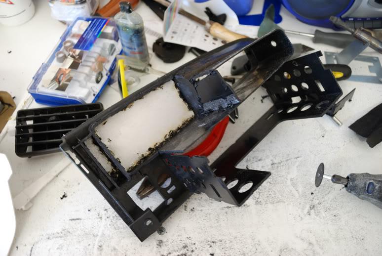

        Roughtly traced out the shape need for the delete
        trimmed and sat in place

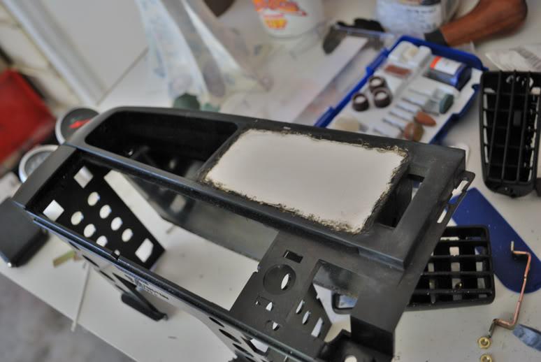

        Welded blank in place
        Sanded
        the rear

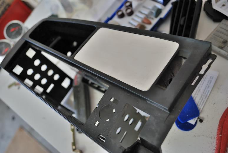

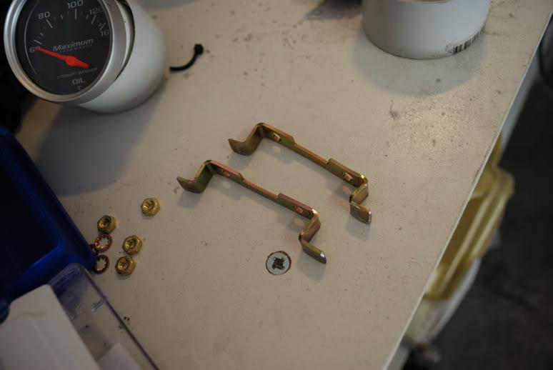

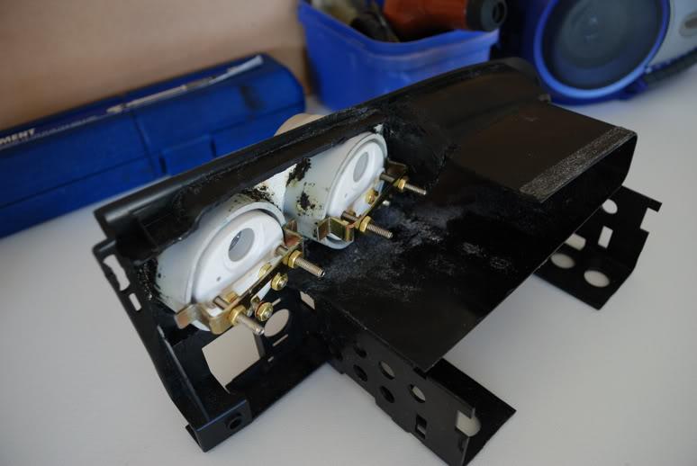

        • Cut the holes required and placed in the gauge mounts (angled)
          I had to trim down the gauge brackets and bend them out to secure ontot the pvc pipe

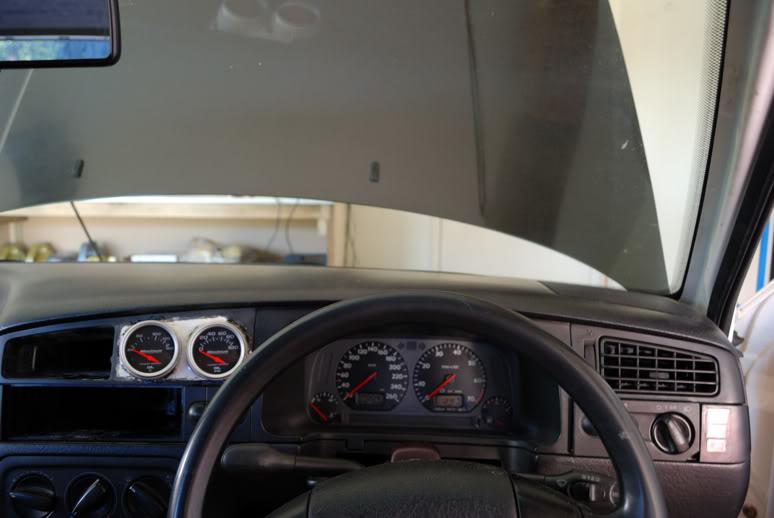

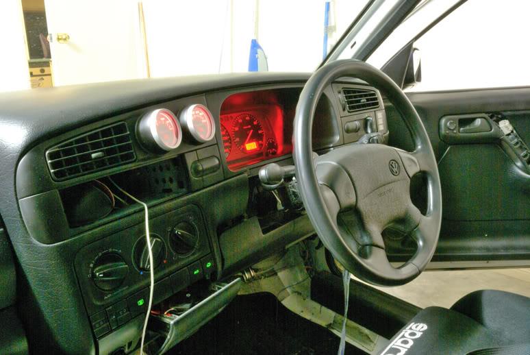

          mounted
          Dummy fit to get the angles right
          welded, sanded and sprayed

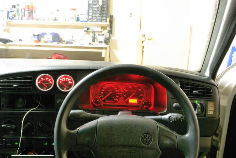

                • Woah, dedication right there...
                  How on earth is your dash so RED?

                          THAT is sweet! Liked how you angled them!
                          Cheers ray, its far easier to read them that way
                          I played around a bit huh, its brighter in the pics than what it actually is cuz i rushed the pics, but i placed a row of red led's along the top of the cluster and also replaced the lcd light with a red led, i didnt hook the other one up though; during this proccess i up both the lcd readouts, broke the fuel needle and wrecked my speedo! So not the most effective mod i've done haha . . . . however i would do it again
