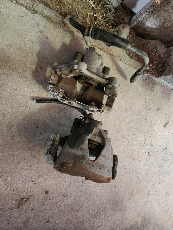

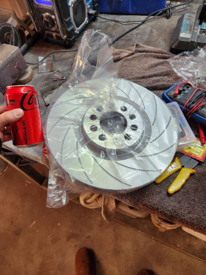

                    Firstly, brakessssssss. My stopping power is awful. The teeny tiny brakes on there now just aren't cutting it. Insert Audi TT calipers, 312mm slotted discs, and mk4 golf rear calipers (alloy vs cast iron, just to lighten things up). Note I am only currently 4x100, so this complicates things and I was so certain I was going to drill the Audi TT discs to 4x100, but I've decided against it and now looking out for some decent 5x100 rims, that I can swap my brand new freshies Pirelli P-zeros onto from the 4x100 rims... argh more money...

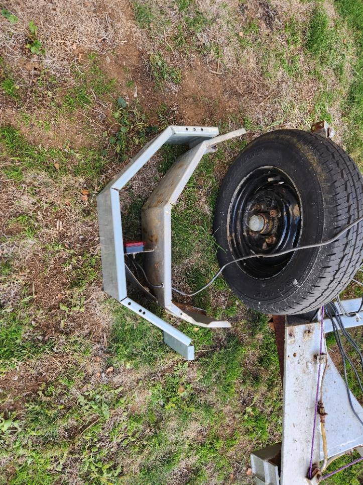

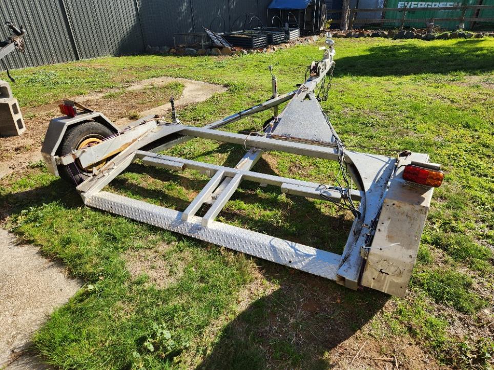

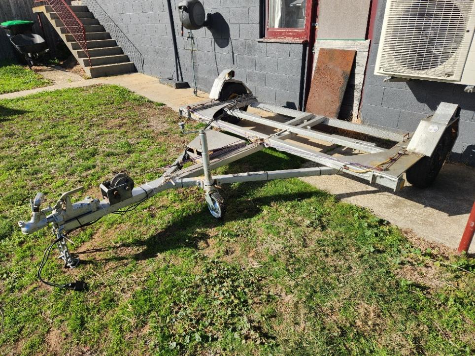

                    Secondly, transporrrt! Now my predicment is I only have the van as my tow vehicle (FWD, 1800kg capacity). So don't even think about a car trailer. And they are so expensive!!! Which basically leaves me with no option. But wait... a dolly trailer! Never seen one before, dunno how unsafe they are, but they are a thing! So I've picked up an unregistered one for $700 and been to work. I am certainly not a skilled fabricator but I've busted the mig out and I'm actually very happy with my new fab up of wheel arches to replace the rusted out ones. Just needs new tyres now, a fresh respray and then hopefully a straight forward stroll over the pits to get it registered. And this one is pretty cool, you wind a winch and it lowers the deck up n down, so you don't need trailer ramps. Cool in theory, see how well it goes with a mk3 on it...

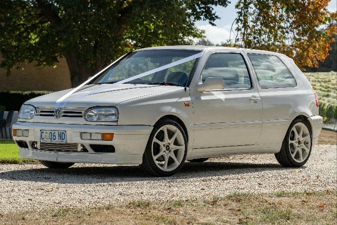

                    And lastly, golf(s) made it into a special wedding again, pics presented them very well! Exciting times.

                      Successfully converted to 5x100 pattern. Upgrades included fitting Mk4 rear calipers with ECS tuning brake lines, poly bushes on the control arms, the TT caliper/312mm brakes with ECS brake lines and of course the widetrack. Everything was refurbed, regreased/booted the CV's, new wheel bearings and new bushes everywhere. Had all the classic issues, stuck hubs, stuck CV's, snapped bolts, broken caliper pistons. But got there in the end, big tick for some nice tight suspension.Click image for larger version  Name:	20250616_150513.jpg Views:	0 Size:	211.5 KB ID:	2038099
                      Click image for larger version  Name:	Capture.jpg Views:	0 Size:	109.3 KB ID:	2038100Click image for larger version  Name:	20250722_171213.jpg Views:	0 Size:	212.4 KB ID:	2038102​​​Click image for larger version  Name:	20250821_162927.jpg Views:	0 Size:	0 ID:	2038110
                      For the 312mm brakes, I had to use x4, M12 washers to space the TT caliper carriers to the correct offset (~6.1mm). I also had to remove the anti-rattle spring as they hit my 17 inch wheels. I changed to a new set of 17 inch 5x100 and was able to swap the tyres over from the 4x100 rims as they were brand new when I put them on. Happy days.

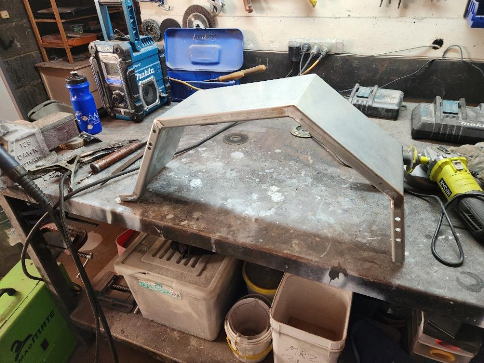

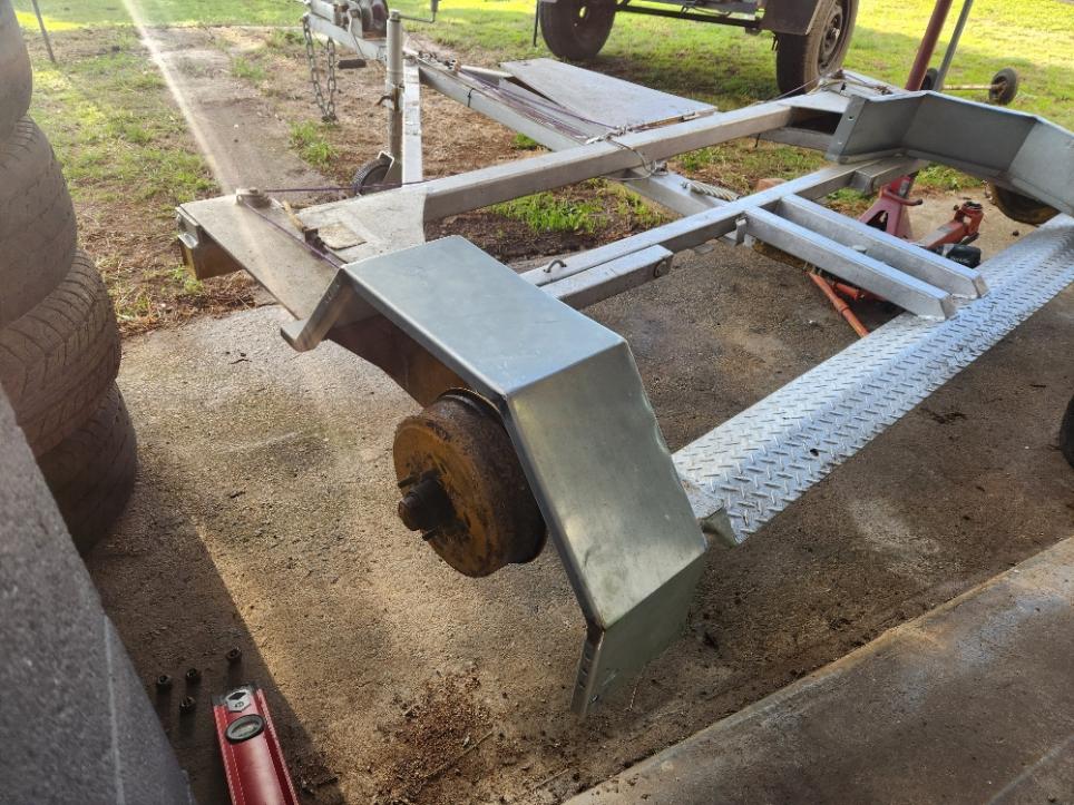

                      Click image for larger version  Name:	20250926_132846.jpg Views:	0 Size:	146.5 KB ID:	2038098​As for the dolly trailer, this got a generous lick of paint to bring it to life!​ As well as a new brake master cylinder, fresh wheel bearings and drum wheel cylinders, all to help it pass registration. The first time loading the car did not go so great... Smashed taillight, broken front lip and snapped winch line. Fair to say it was an experience!!! And reversing the trailer with a car on the back of it as a straight up nightmare, basically a very short wheel base B-double. Resulted with me denting the drivers door in as I did a double jack knife?... Focused on not jack knifing the trailer without realising the trailer was jack knifing the car... lol!
                      Click image for larger version  Name:	20250618_184851.jpg Views:	0 Size:	212.8 KB ID:	2038104Click image for larger version  Name:	20250618_144109.jpg Views:	0 Size:	318.8 KB ID:	2038105Click image for larger version  Name:	20250704_163234.jpg Views:	0 Size:	383.1 KB ID:	2038106Click image for larger version  Name:	20250919_155557.jpg Views:	0 Size:	229.2 KB ID:	2038107Click image for larger version  Name:	20250906_153856.jpg Views:	0 Size:	337.3 KB ID:	2038109Click image for larger version  Name:	20250919_171220.jpg Views:	0 Size:	184.9 KB ID:	2038108​​​More to come...
