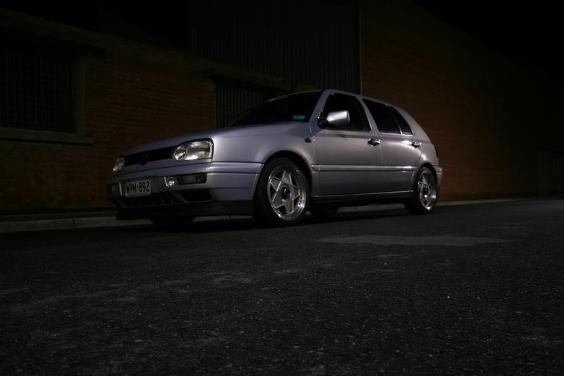

                              I bought few month ago from "Evorobin" Hottuning coilovers. That is best investment on my car. There is a picture how look like. Car is much better for driving, handling and looking too.
