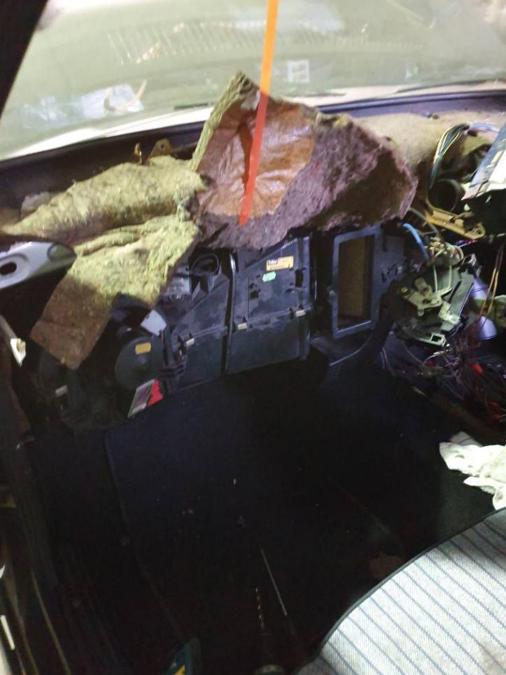

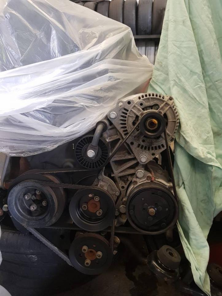

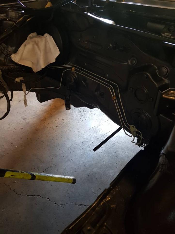

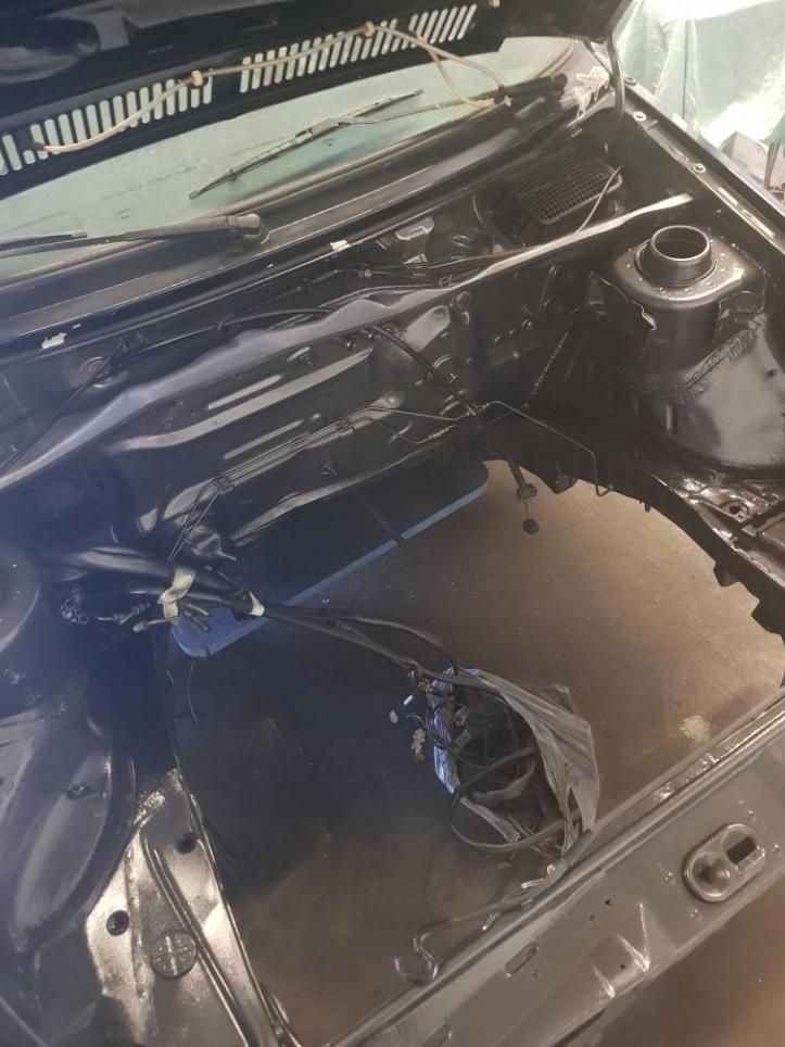

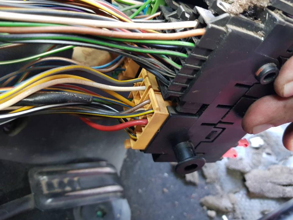

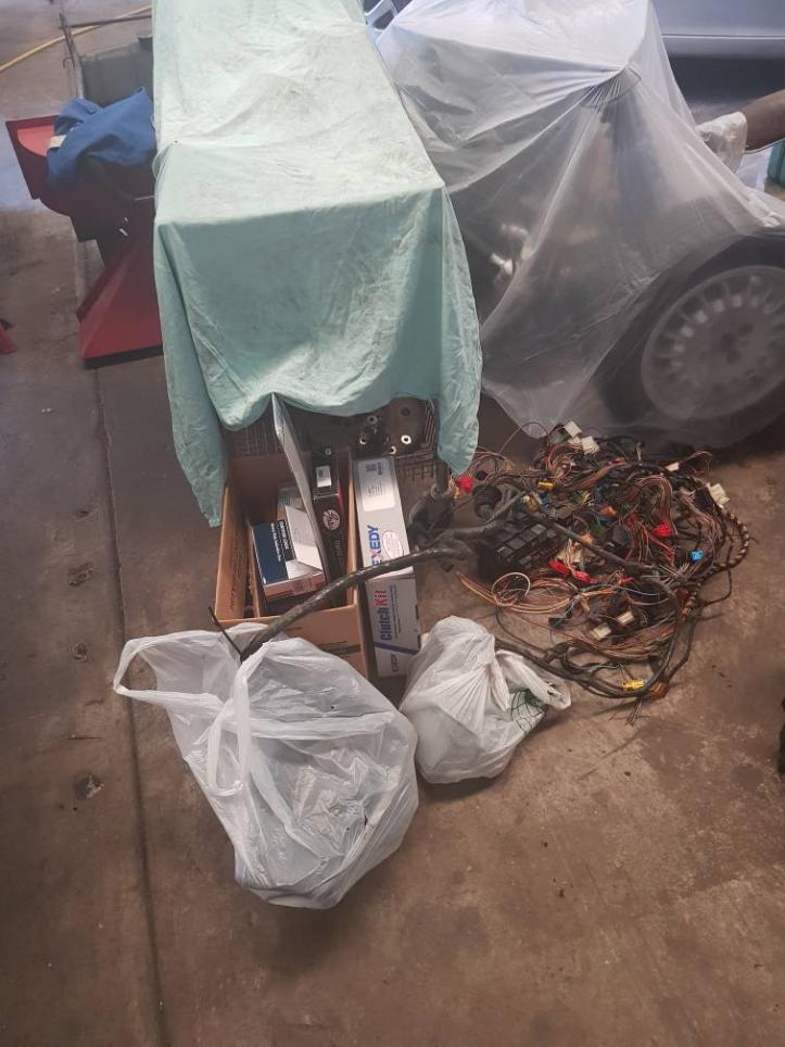

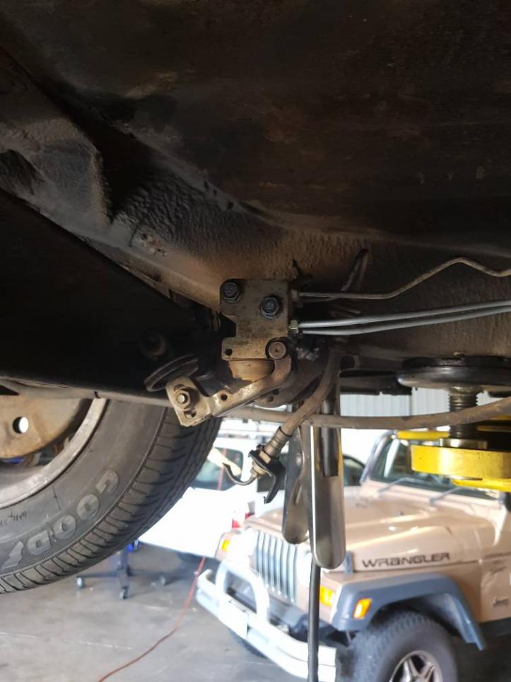

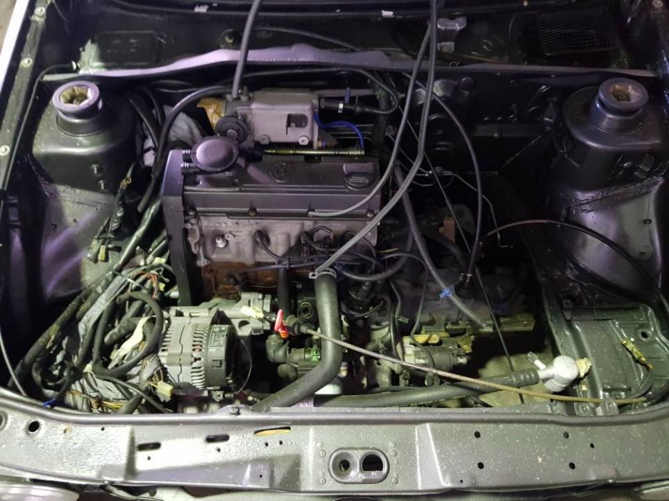

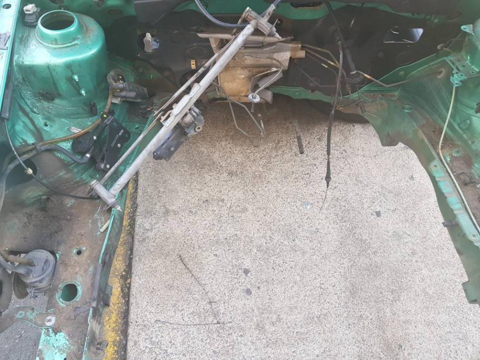

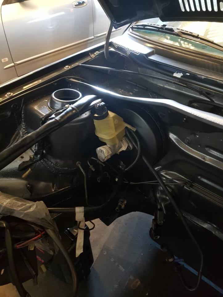

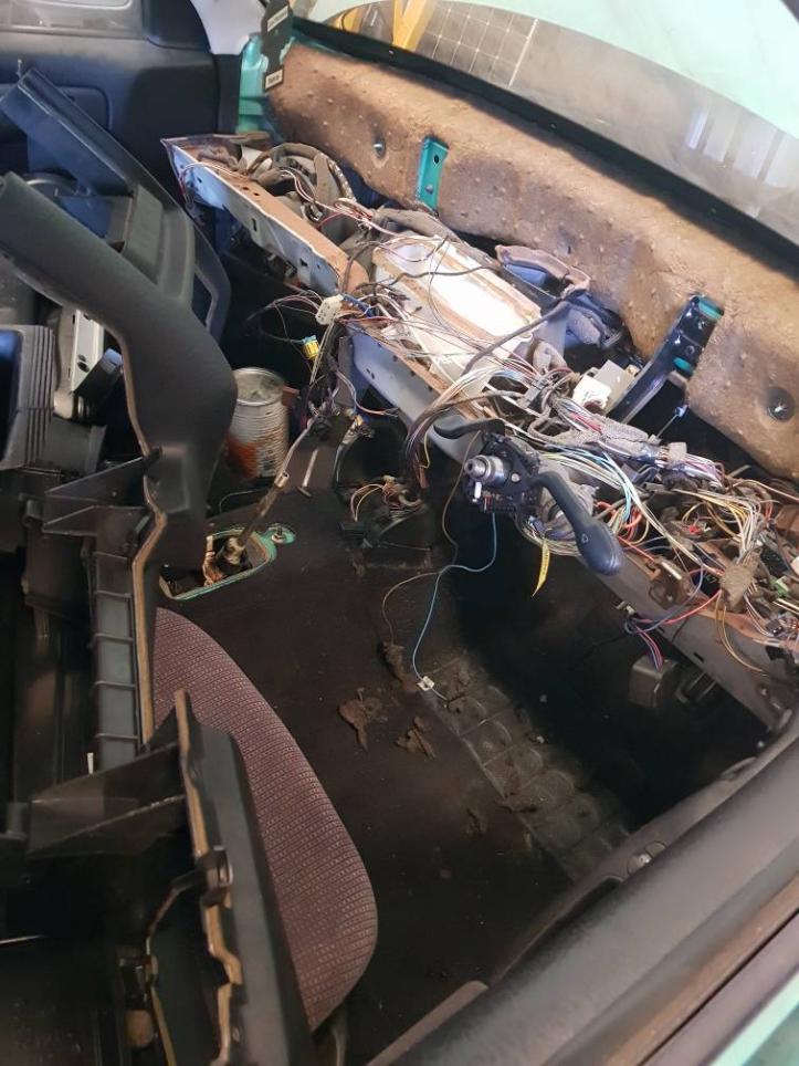

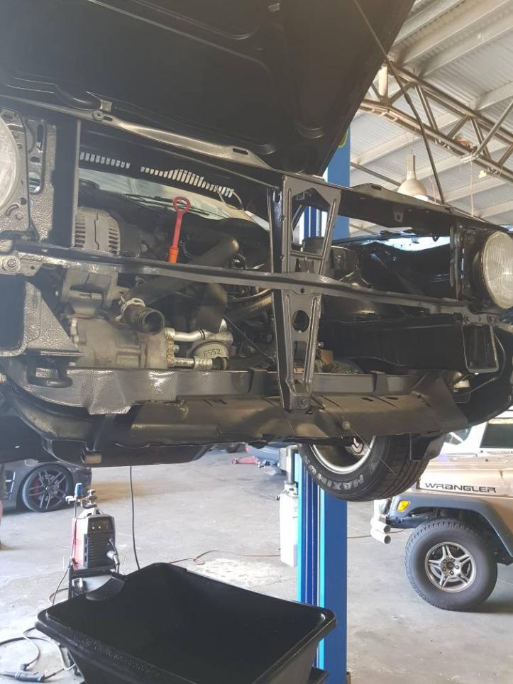

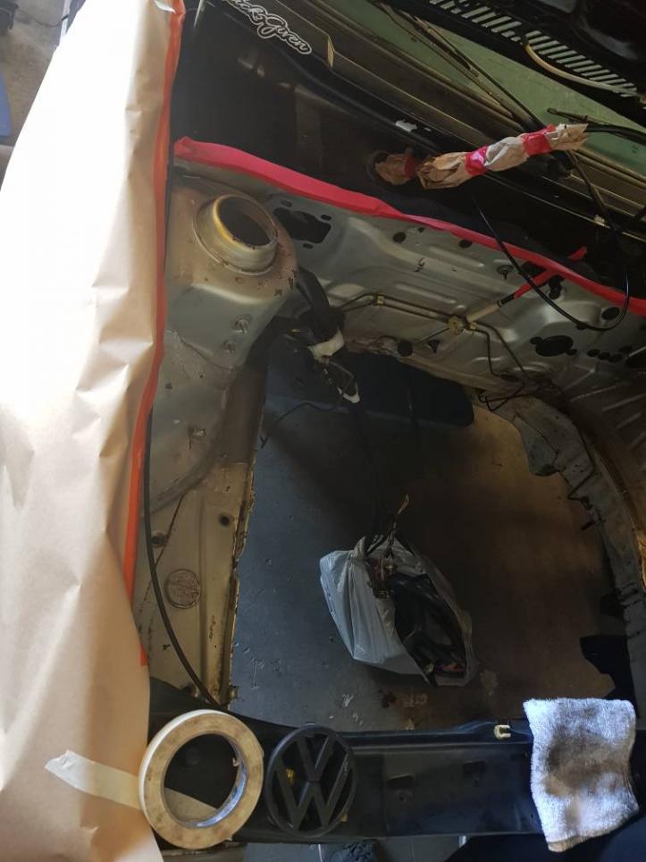

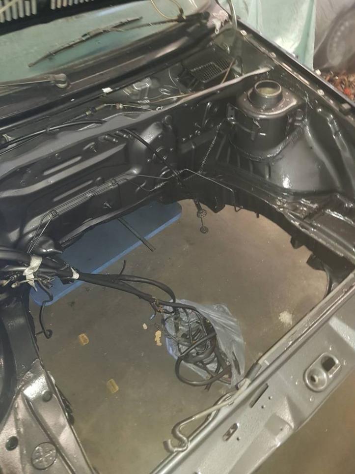

so it has been some time since anything was done but I had a couple of weeks off and decided to do few things as I really would like to get back into it. engine bay on mk2 got resprayed, and 2l engine got washed. pulled all the loom out of mk3 as well as ac/heater box (hopefully goes in without any drama). got timing belt, clutch and few other things so it can be done before it goes back into the engine bay. next thing to do will be brake lines as I will have disks all around, and brake booster from mk3 will be utilised.

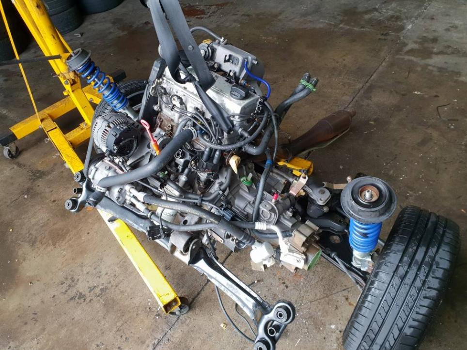

couple of pics of what was done 3 months ago.....loom should be getting done soonish, but like anything with this car it could be awhile....oh well it is what it is...

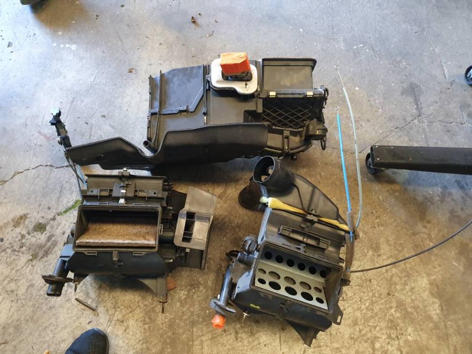

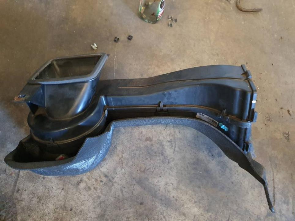

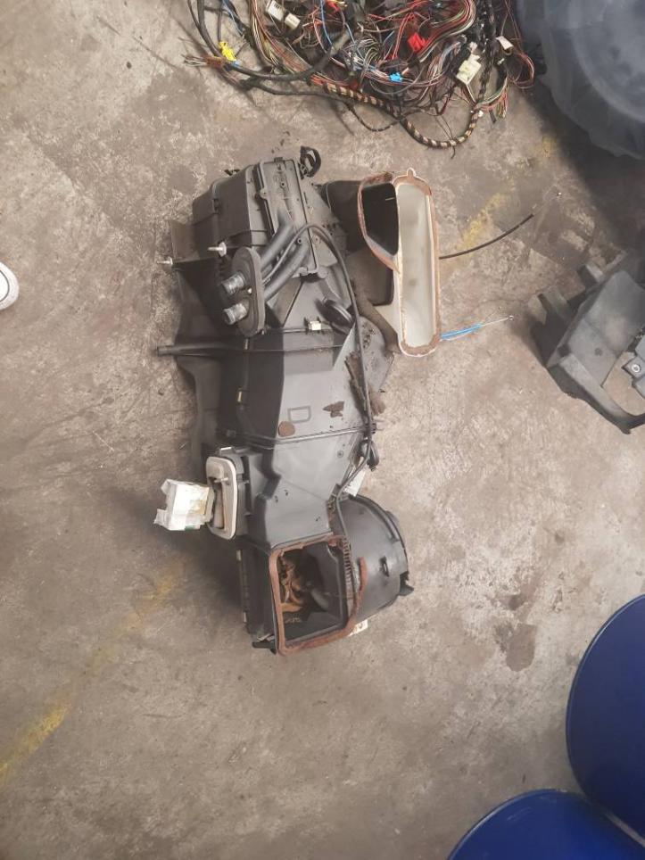

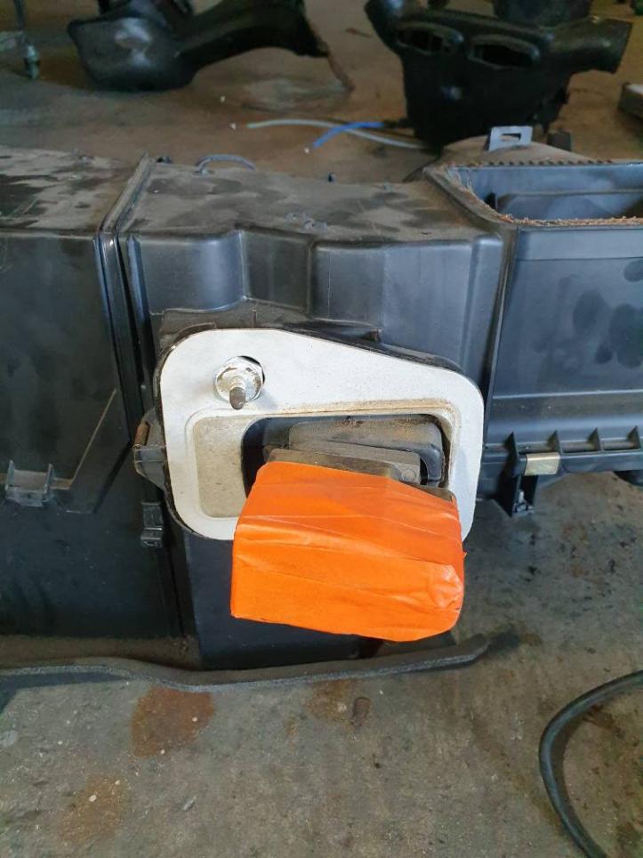

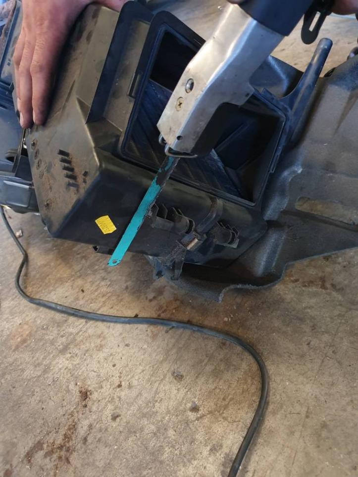

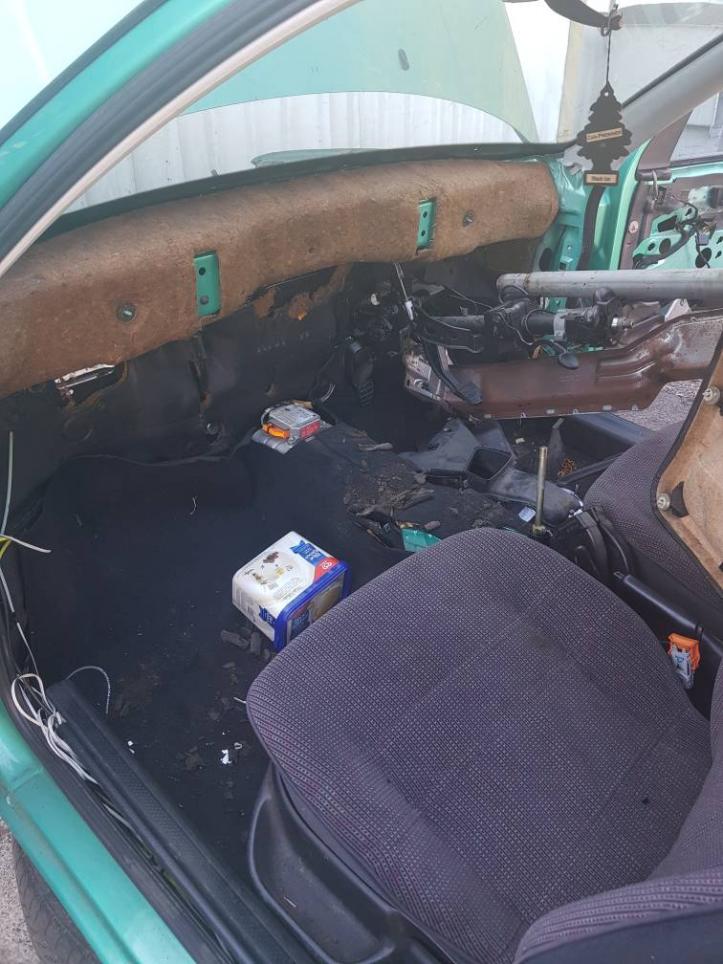

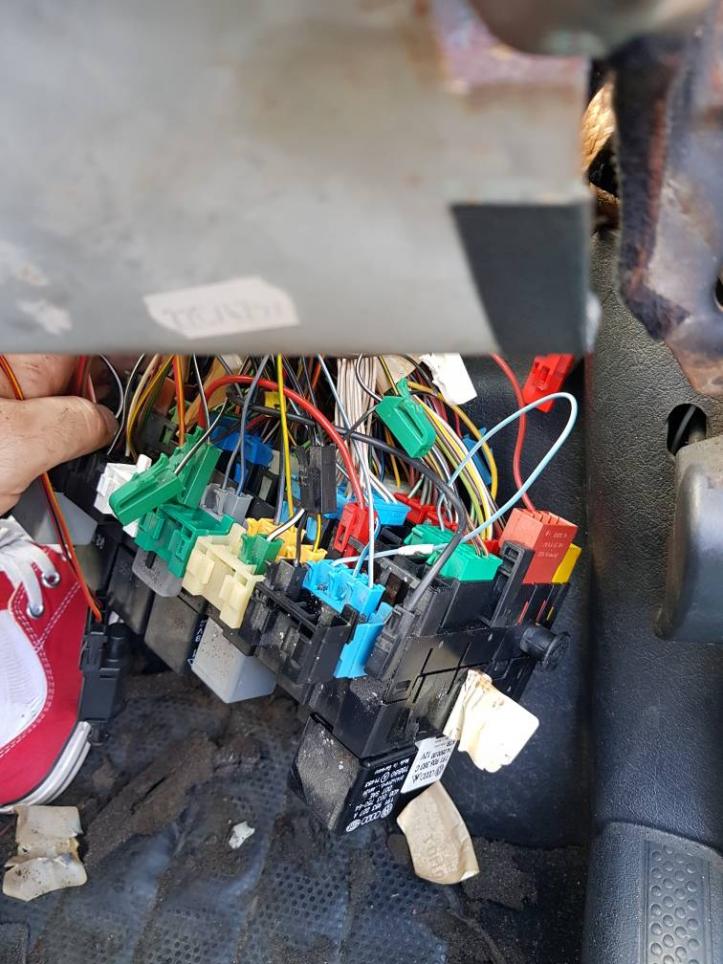

what you are seeing is vent system from Mk2 non aircondition being combined with mk3 aircondition vent system....mk3 vents had to be slightly modded as you can see 2 plastic nipples that were sliding into the rest of the mk3 system (photo with electric saw cutting the nipples)...

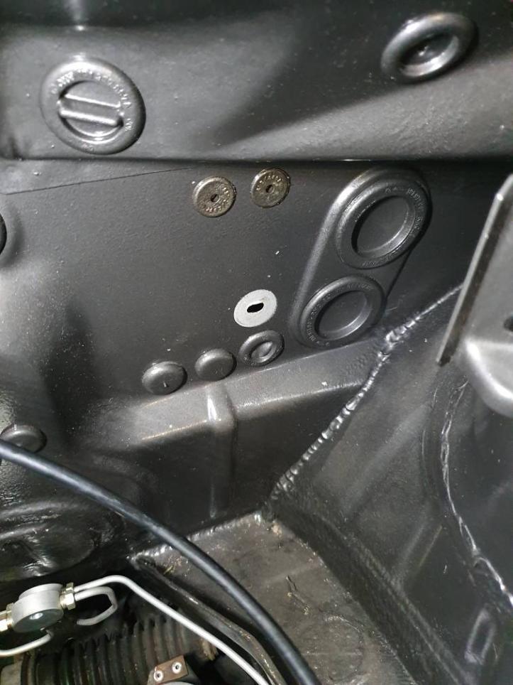

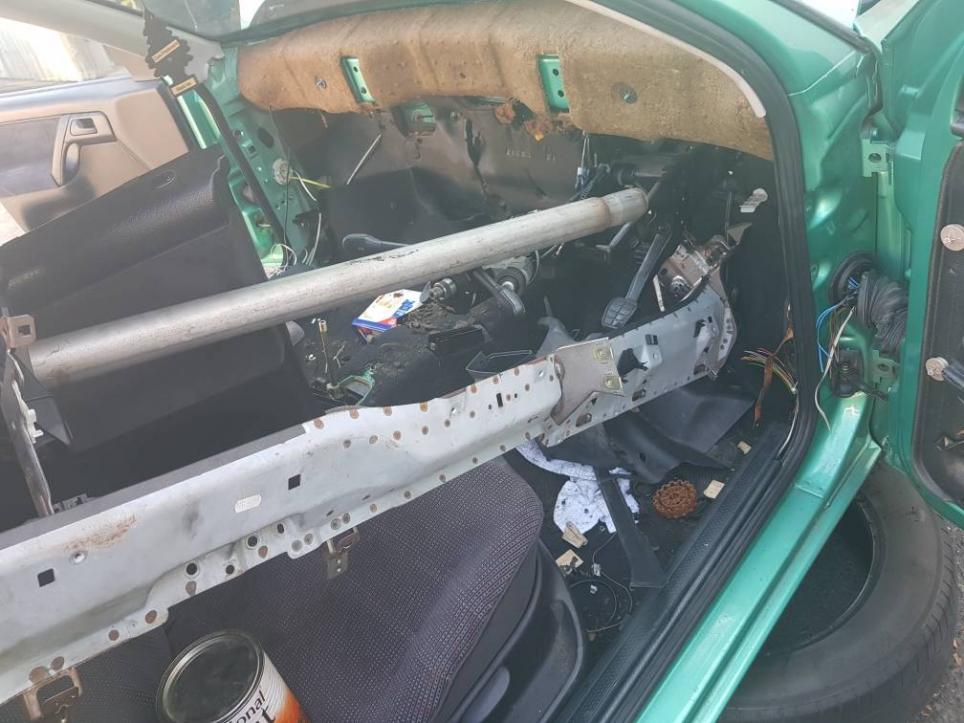

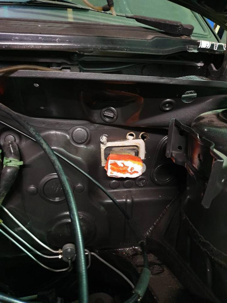

next thing is the firewall and where we will need to cut yo make space for evaporator piping to fit through....

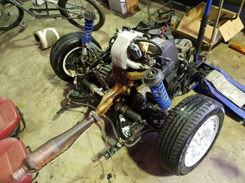

drive shafts are back in the car

aaaaand this is how we are looking inside the cabin and engine bay....Will be getting plate welded or something sorted to fix the hack job that was done in the fire wall...

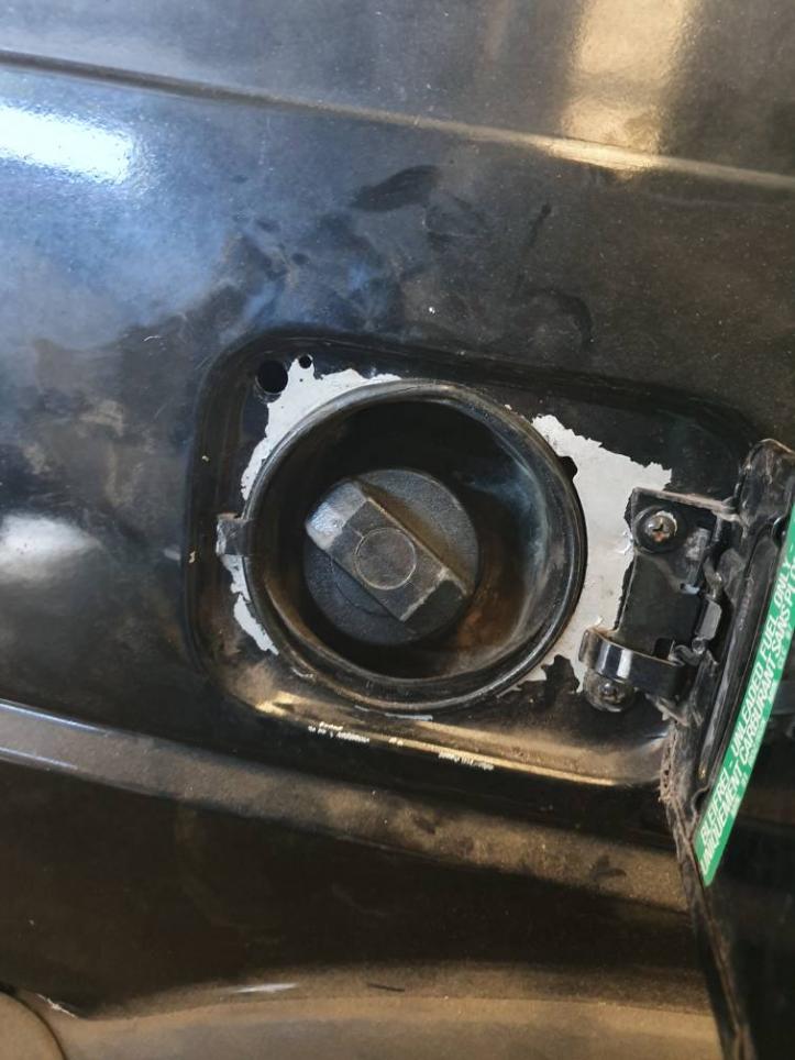

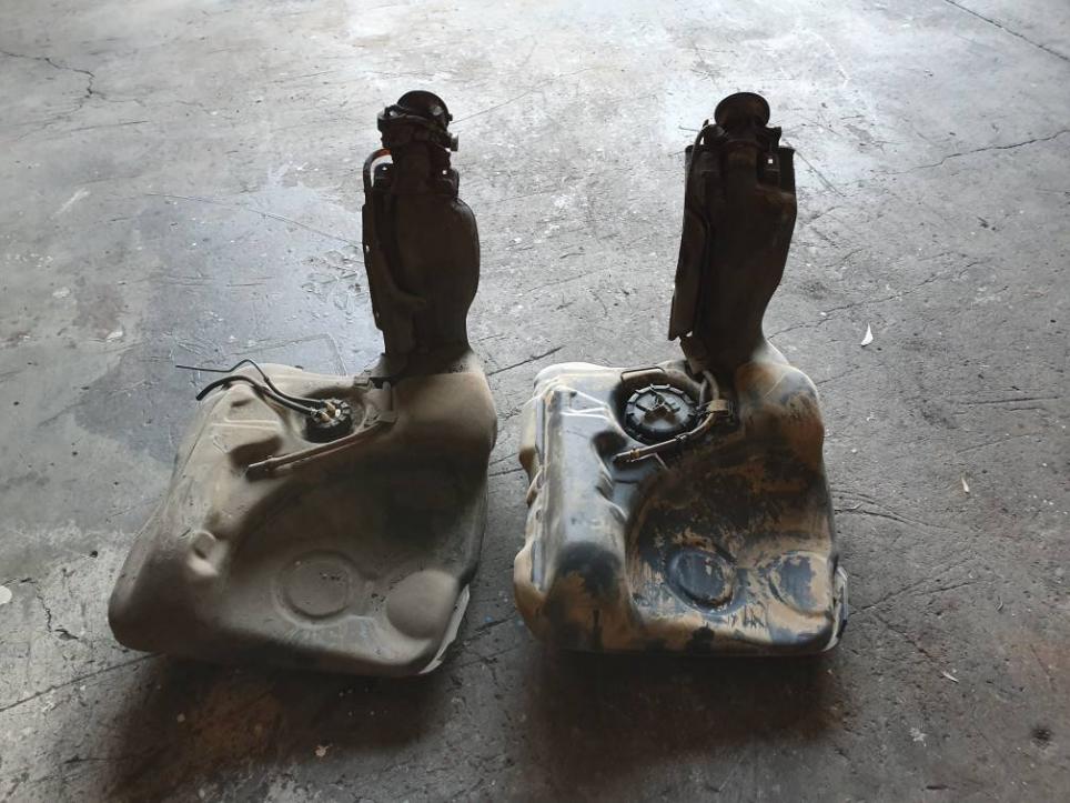

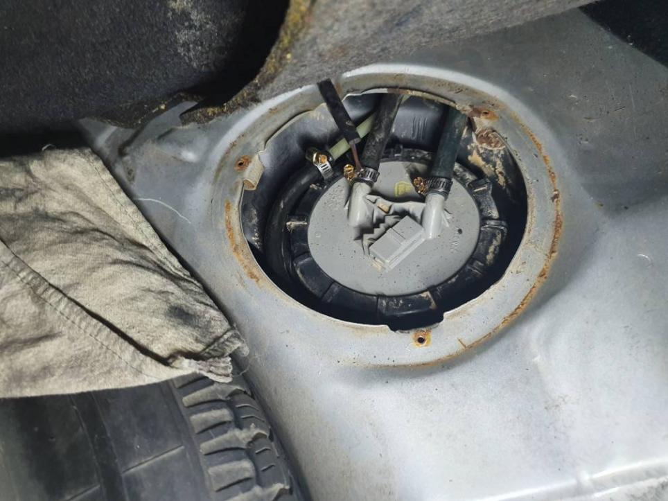

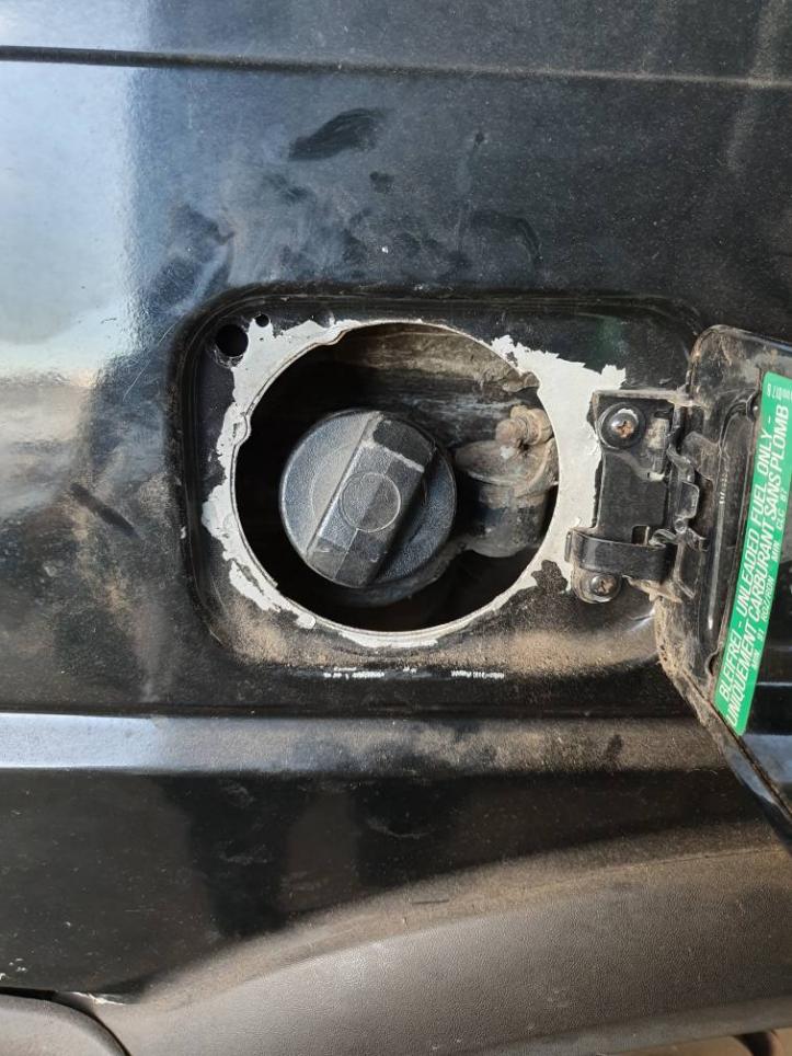

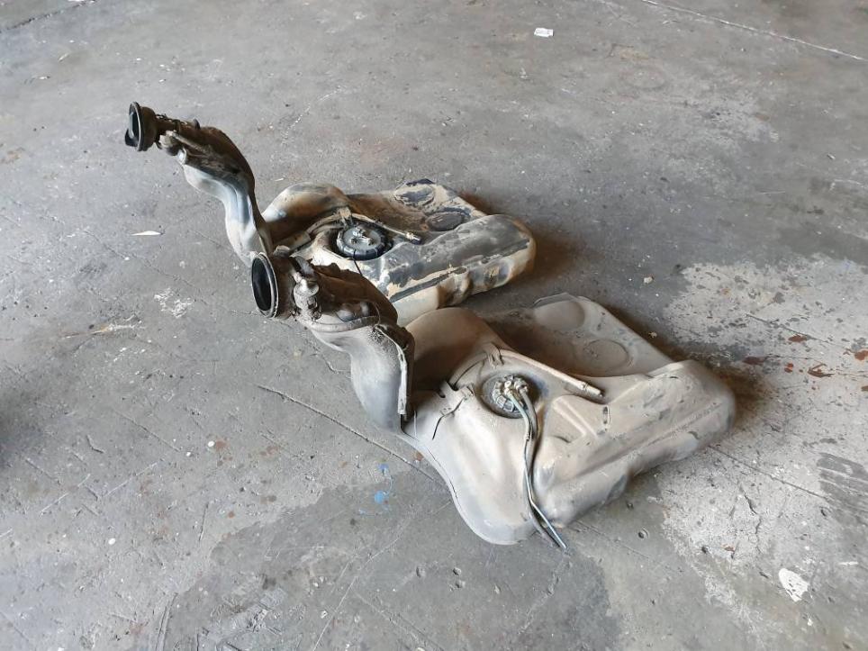

so the next bit that was done, fuel tank and lines from mk3..... as you can see they look exactly the same, but the lid for the fuel pump looks bigger......also when you place the mk3 tank into the car, make sure you keep the rubber surrounding the fuel cap from mk2.....mk2 fuel cap rubber surrounding is kinked which is needed TO make it look like it belongs....
pedja
Sent from my SM-G977B using Tapatalksigpic"stop blowing holes in my ship"
