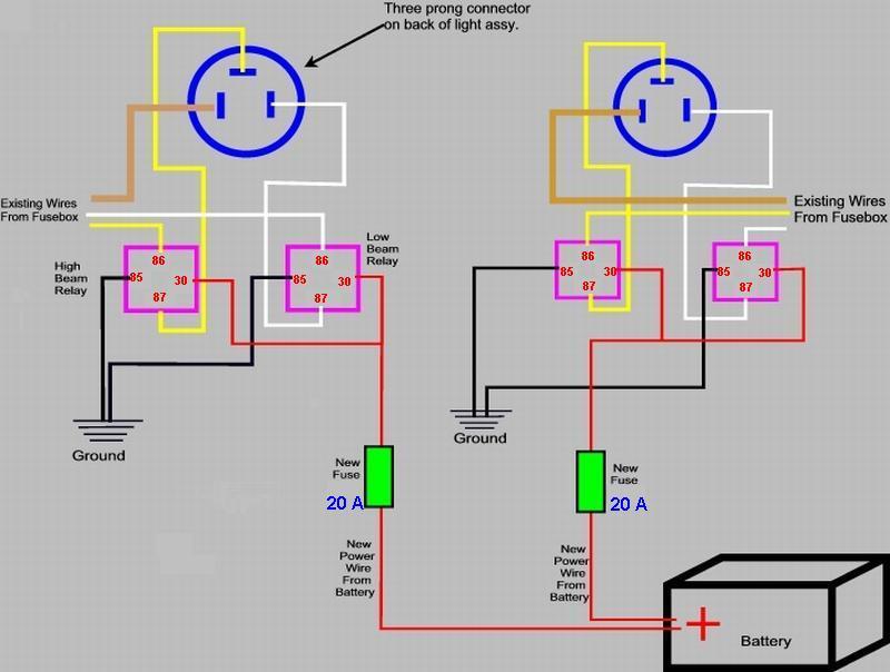

    If it hasn't already been upgraded with separate relays providing power straight from the battery then do this mod to the driving lights and headlights. Standard wiring is pathetic and the difference is literally like night and day.

      That would be awesome, did you have a link to a guide?

        On mine I mounted the relays behind the grill, next to the passenger side headlight and spliced into the headlight wiring on the passenger side. This meant the wiring going to the passenger headlight was used to power the relays so I cut off the wiring to the driver side headlight and spliced those wires to the wires coming off the plug that connects to the passenger side headlight.
        I used 2 relays, one for high beam and another for low beam. If you're really serious use 4 relays, 2 for high beam and 2 for low beam. This would prevent loosing all lights if something shorted out on one side.
        Cheers
        Paul
          Thanks for the info Paul. I've got a brother that is an ex auto electrician, I get him to have a look over what you have supplied.

            Must do for Mk1/2 => mk1 and mk2 Headlamp Wiring upgrade...this is a MUST!
