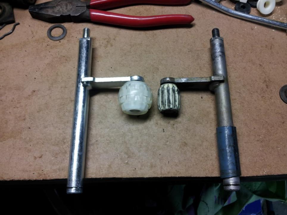

                  In the process of changing the shifter bushes. I think they're over due.
                  • #54
                    wow, how hard is it to change?
                    where'd you get the new ones from?
                    • #55
                      I actually didn't think it was too bad. Its fairly safe to say it will be a whole lot better tho. Ebay special mate.
                      • #56
                        Very easy to change brad.
                        take one of the links off, undo the top nut, take off the bottom clip and slide it out.
                        the factory ball is soft and has lots of give, replacing it for an acetyl ball makes a huge improvement

                          Sorry Brad I miss read your post, as Stiggy said it was pretty straight forward. I got the whole kit, the only thing I haven't replaced is the ball and seat for the shifter itself. Tightened the whole thing up with only a little play. Awesome!
