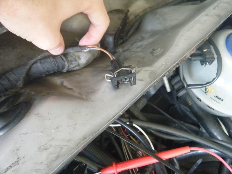

    If there is another 3wire plug somwhere, then what is the 4 wire plug meant for in the engine bay!
    Going to strip everything out and confirm if I've found the right plug or not tomorrow.

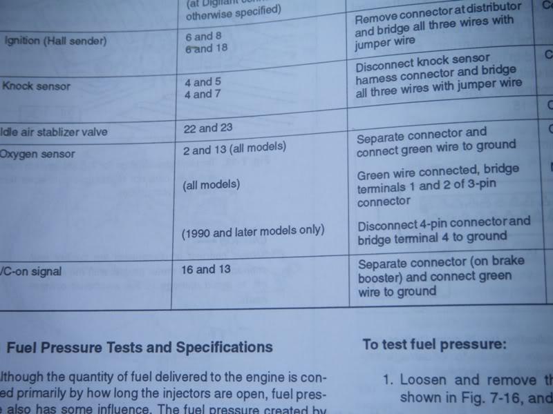

      So I was starting to get optomistic towards finding an explanation when I found this in the Bentley manaul... (Note it mentions the 4 pin/wire connector for cars after 1990)

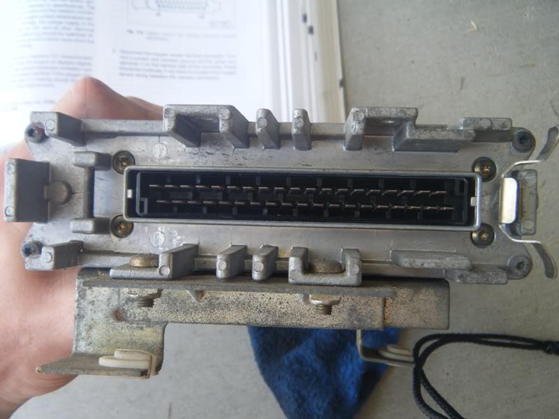

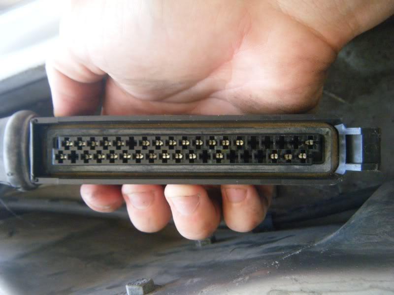

      Then I removed the ECU and looked at the connection.....
      I thought Digifant was 25pin?.........Ok

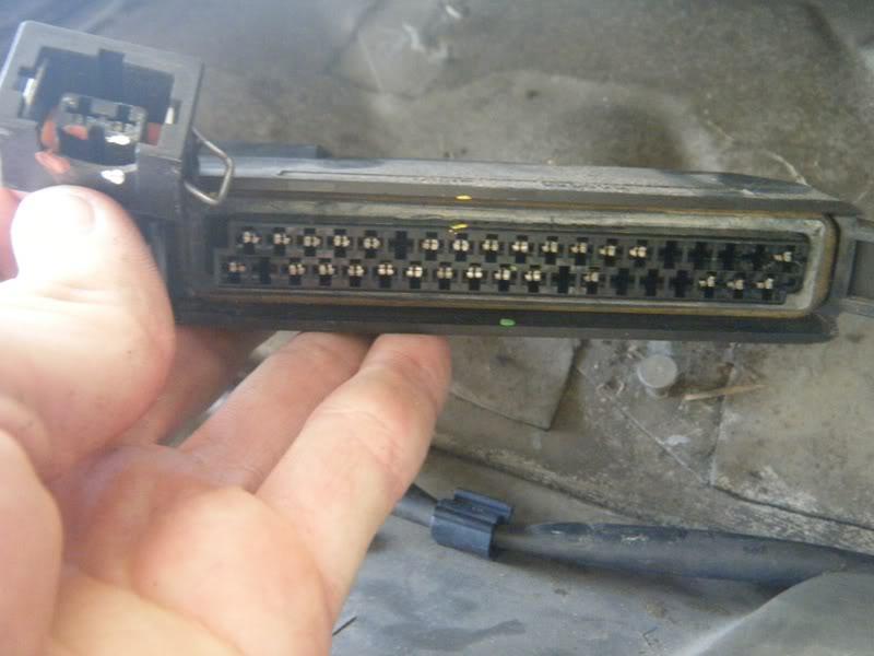

      I checked the continunuity of the 4 wire plug in my engine bay, to see if they matched to any of the ECU connector pins.
      Remember
      #1 - Green/Red
      #2 - Yellow
      #3 - Brown
      #4 - White/blue
      And here's what I found
      #1 Came out on that massive ECU connection (marked green)
      #2 came out on the ECU connection too (marked yellow)
      Now the fun bit, wires #3 and #4 did not go to the ECU, instead they had continunuity with this plug, that is connected to nothing in my scuttle tray.....
      (#3 marked brown, #4 marked white)
      The 2 wire plug that is not connected to anything.....

        LOL yours is digi1 not digi2. I miscounted the pins, #1 is actually the bottom left and 38 is the top right. So the two highlighted pins are #10 and #27 and looking at the chart, it definately corresponds with those wire colours.
        So that plug is for CO Potentiometer, and Knock Sensor!

        Digifant I Pinout
        As for the plug in the scuttle tray i think its for the ambient temperature sender which is why there is continuity there.
          Can describe how stupid I feel.......But now I can figure this out!!!!

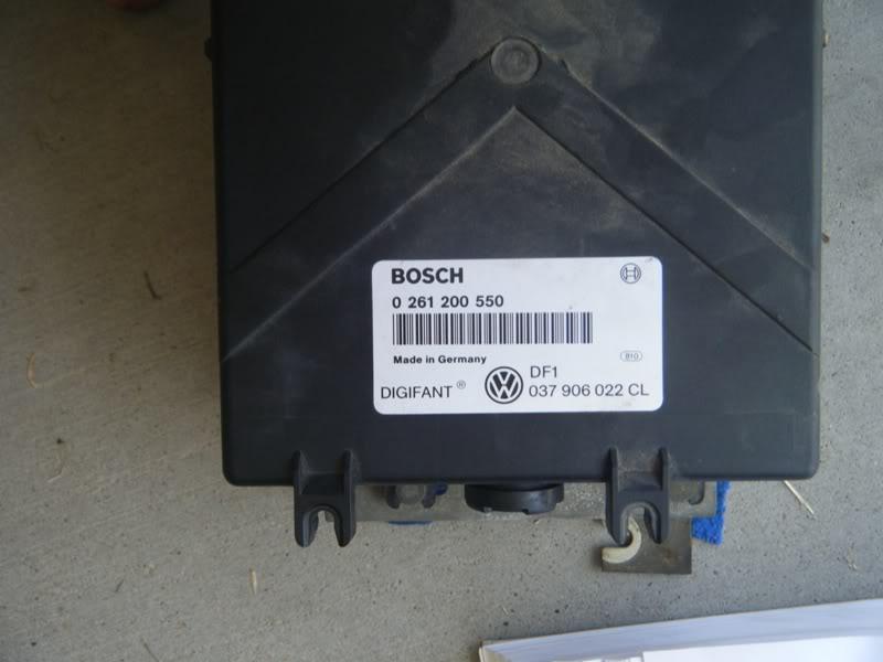

            How do they have the same numbers as mine but not be digi2? I'm sorry if I added confusion.
            • #51
              mikinoz
              Bosch Part# : 0 261 200 294
              VW Part #: 037 906 022 M
              ryana89 (me)
              Bosch Part# : 0 261 200 550
              VW Part # : 037 906 022 CL
              Must be it?

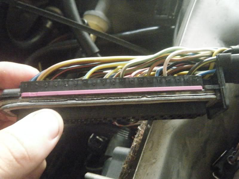

                  According too the Digi 1 wire colour chart (posted by Peedman/mikinoz and also in my Bentley manual)
                  The 2 oxygen sensor wires and their # position (the colours/position they should be in)
                  Connector Pin #9 - Black Wire
                  Connector Pin #16 - Violet Wire
                  Well.......... the picture explains itself
                  I've gone through ALL colour charts for Digi 1,2 even Motronic and NONE of them show the wire combination shown above.
