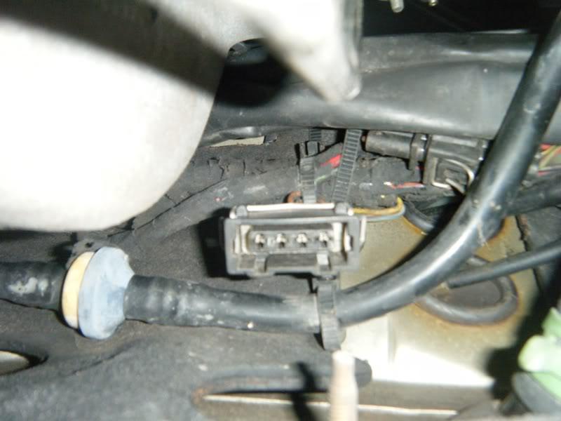

      Just went out for another check around the engine bay and FINALLY found the plug that the O2 sensor harness would plug into! (atleast I think so?)
      Feel rather stupid that I couldn't find it before, but ohwell.

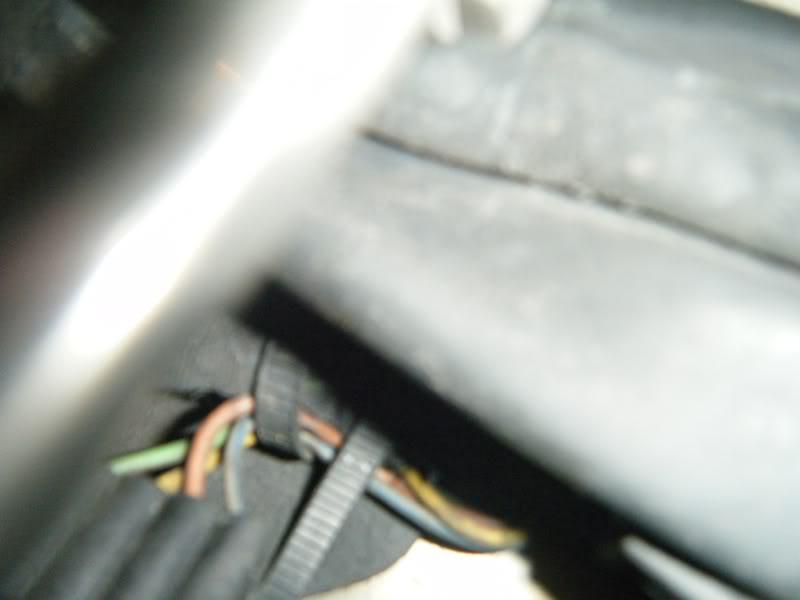

      The wires going to the plug
      It was hinding around the back of the 4th inlet runner on the manifold, had 4 wires going to it, so a 4 pin plug?
      May get a quote from an exhaust shop to see how much it would cost to weld a bung for an O2 sensor to sit in, into the exhaust.
      Just had a sneak around GAP, all MK2 O2 sensors are either 2 or 3 wire. MK3 O2 sensors are 4 wire

        It looks pretty obvious to me that this car has had a 2E conversion. That 2E engine was never offered anywhere in the world in the mk2. In the process, they have put in that custom made exhaust and left that 4-pin lambda plug hanging.
        It also explains the other wire plug you found in the scuttle tray, and the alternator is probably the mk2 one because of the ease of re-wiring.
        If that actually is the correct ECU for that engine, then its gonna be a very confused little computer without that oxy sensor in place and like Gav said, is feeding loads of fuel in coz its getting no reading.
        Remember, this car came from South Africa, which raised my suspicions of it being standard/factory immediately. I've seen quite a few imports around from SA, all of them were "tinkered with".
        You should be able to sort that out with a standard 2ltr mk3 lambda??
