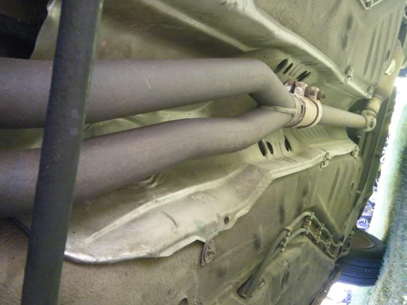

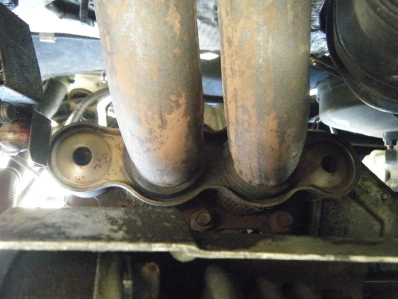

          And as I said, here are some pics (if you dont know what a catless MK2 looks like)
          Off the 4 into 2 manifold into the dual downpipes

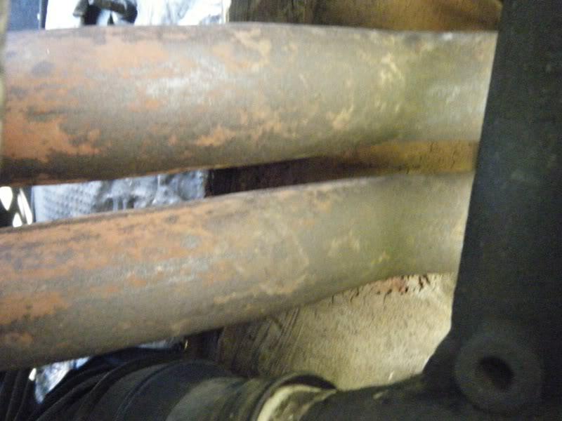

          Downpipes bending to go towards the direction a cat would be in...

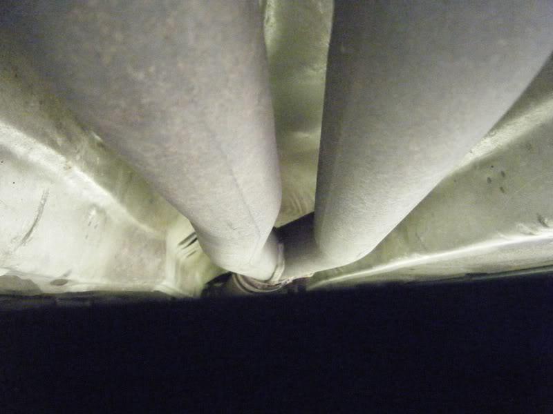

          Downpipes eventually merging
          And BAM no Cat.

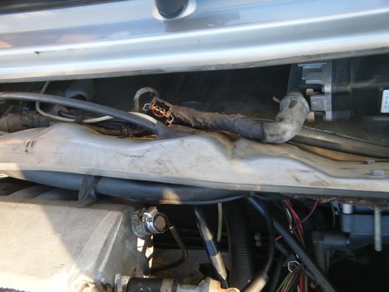

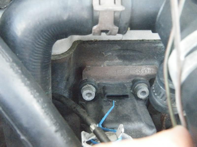

          Now this little 2 wire plug wouldn;t be where the O2 sensor harness usually plugs into would it?
          HAHAHA

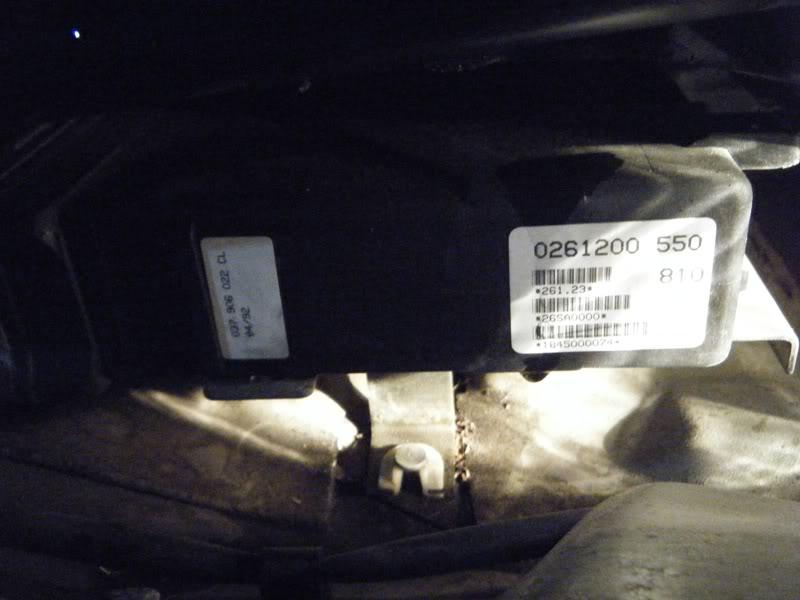

            What's the part number of the ECU? That'll tell us quite a bit.

              037 906 022
              HAHAHA
                Not as helpful as I had hoped. I couldn't find it on ETKA. google threw up a couple though which makes me think the ECU is from a 2 litre Passat. I can't tell which year though. I know that the very early MK3 GTIs that had this engine, didn't have cats fitted in the UK.
                So it is entirely possible that there is no cat/lambda needed. Could be any number of reasons yours is using lots of juice. Coolant temp springs to mind.

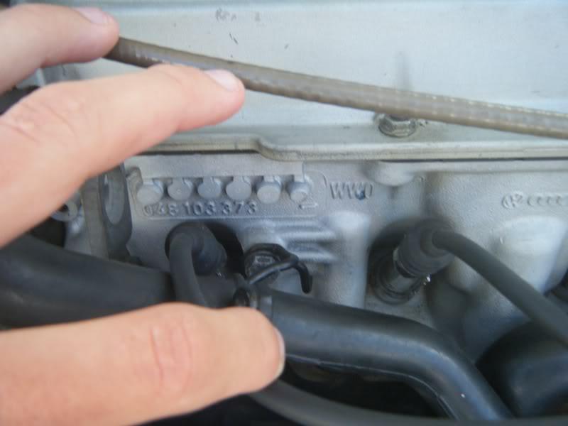

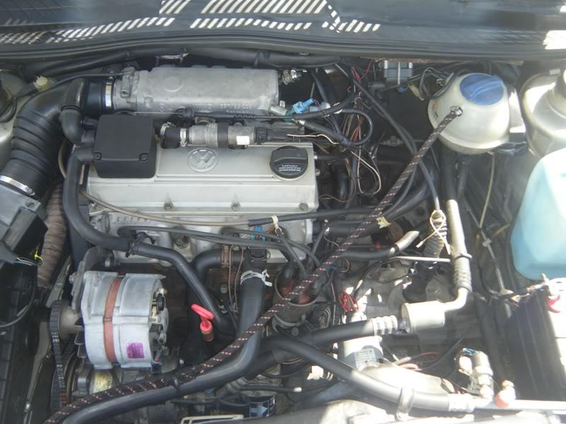

                    Post a picture of the engine bay for me. Lets see what else isn't from the original car. It is easy to put a 2 litre bottom end in but has it got a full 2litre engine fitted??

                      The head
                      The bottom end
                      HAHAHA
                        I am going to stick my neck out slightly, that's a full 2 litre engine in there.
                        It would be worth trying to find another, Ibiza GTI or MK3 GL and comparing them. The downpipes look to be MK2. Maybe the probe is missing and the folk doing the conversion weren't bright enough to appreciate that fact.

                            Yes, I've noticed the many similarities to the 2ltr used in the MK3 GL Golf
                            Only differances appear to be in with the Alternator and A/C set up and intake system set up
                            Just to confirm, there is absolutly NO area along the exhaust in which a oxygen sensor could mount into
                            HAHAHA
