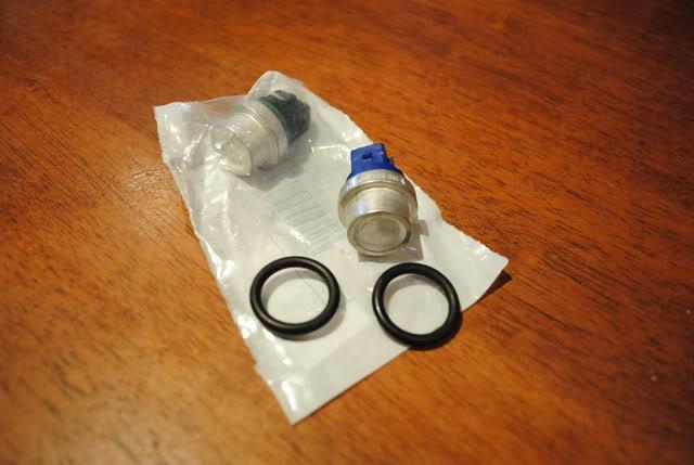

Ordered my two sensors from Matt. I'll let you guys know how it runs with the new sensors in, and the earth connected for the lambda.Audi S3 8L - Stroker GTX3582 700bhp+
Golf GTI 1980
Golf GLS 1979
They are genuine VW sensors too mate. I think the colour of one of em may be different, but it is a supercession. Sent you a couple of o rings too

Fitted the sensors today.
I let it run to get the temp up and....IT WORKS!!
Temp gauge working, no misfiring or stalling either. Less smoke too since the lambda was connected.
Thanks again to all those that helped me find a solution to my problem.Audi S3 8L - Stroker GTX3582 700bhp+
