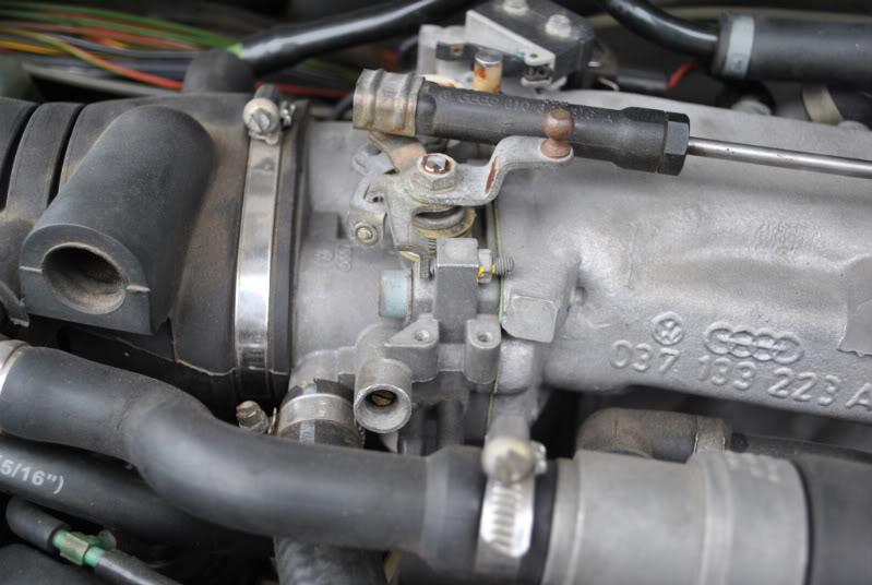

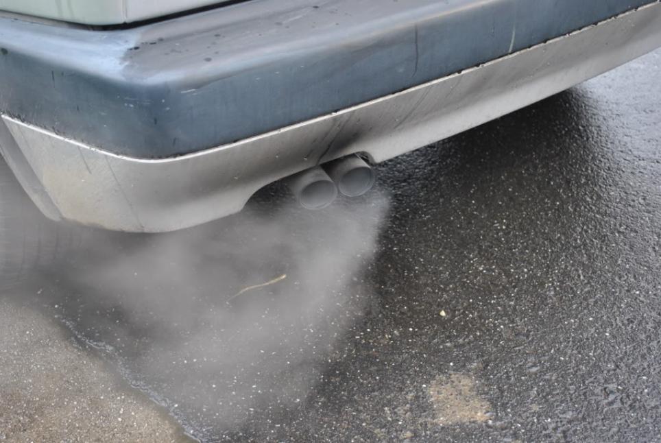

        The problem is back! Its fuel consumption has increased once again.
        Approximately 14 liters per 100km.
        It also stalls once it gets hot. When you try to put it in R or D it will just stall. It also blows black smoke from the exhaust when you give it a little squirt.
        Could the idle air bypass screw have anything to do with the stalling?

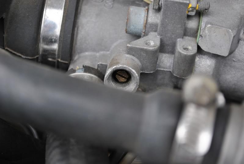

                      The idle screw is just to hold the tickover not to keep the engine running if you load it up, by selecting drive or having the AC on. There are idle-up signals and air-bypass solenoids for that (IIRC it will be idle up signals).

                        I just swapped the sensors over. I let it run for a little while, rev it a little to, to get the temp up. The gauge didn't move!

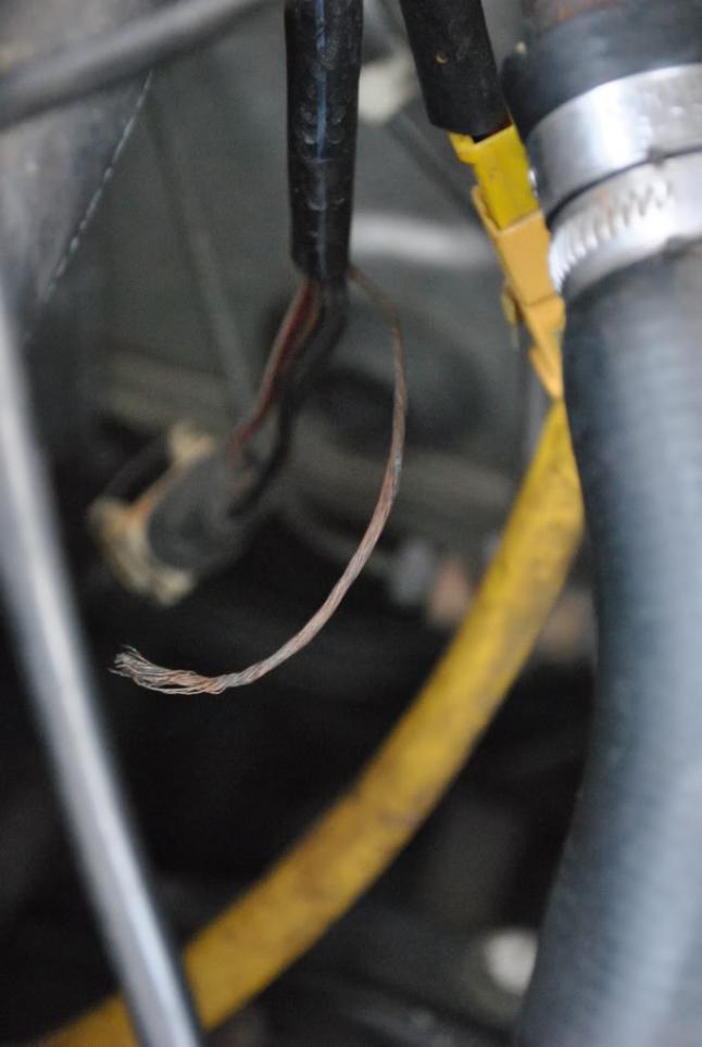

                        It looks like both sensors are faulty. It also blows some smoke from the exhaust once warm up. Also, one of the wires that's meant to be connected to the lambda probe is ripped of.

                          Listen to H100VW he speaks the truth. The blue sensor should have a blue connector and the black sensor a black connector.
                          I reckon that loose earth wire might be the earth for the lambda, connect it to a bolt on the rocker cover and see if that helps the smoke / economy.

                          Idle screw should have a good o ring on it too.

                            That smoke looks like condensation to me. What does the oil temp get to on the MFA. That's a good guide to engine temp, the oil warms up slower so when it gets to 50 degrees, the water should be plenty warm enough.
                            That busted wire most likely won't be helping matters at all. You need to see if there's anything voltage coming out of the probe though. IIRC the black wire will be the signal to the ECU. You should get hold of the wiring diagram and make sure the probe wires are connected to the ECU.

                                Will be fixing the wire tomorrow. I will need 2 new temp sensors to suit this engine and a new o-ring for the air bypass screw.
