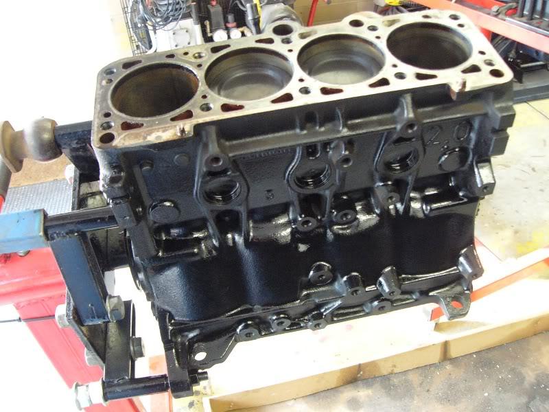

                  I'll be writing up the 2.0 bottom end swap into a MK2 K-Jet system to replace a notoriously (and track proven by myself) underpowered GX 1800 bottom end. (This Mk2 motor is in a MK1). I'll be re-using the MK 2 K-Jet head and injection system.
                  You might like to keep an eye on what I'm up to, there's a few little tricks along the way to sort out. I've got most of it figured out now, I'll write it all up as I do it , rather than link to third hand experiences, I'll write my first hand findings. Doesn't seem too hard, there's some fiddly bits but they can be overcome with off the shelf solutions if you're not up to the home brew challenge.
                  I'm not sure how well this will work, although I'm confident it will work better than the low compression GX bottom end.
                  It's a low risk gamble for me because I got the 2.0 engine very cheap and I can do all the work my self. Mostly this particular conversion will cost me time and gaskets. I plan to properly engineer a higher performance race motor next year after I've paid for a USA Holiday.
                  Meanwhile if you have any questions - fire away and I'll explain the theory as I understand it before I put it into practice.
