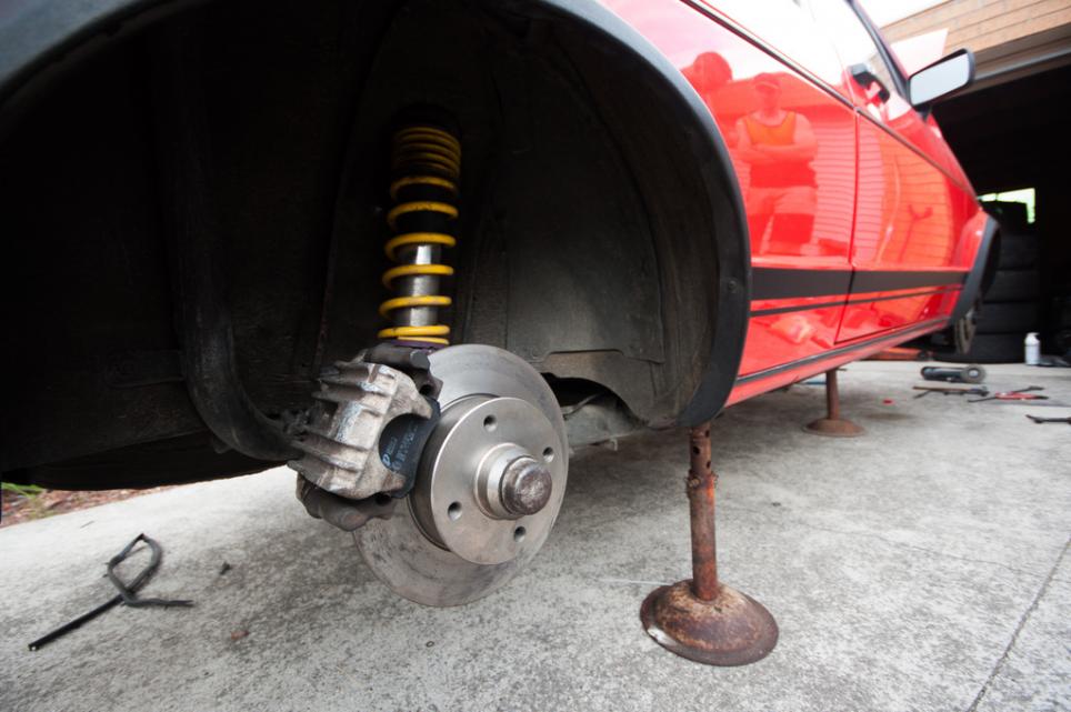

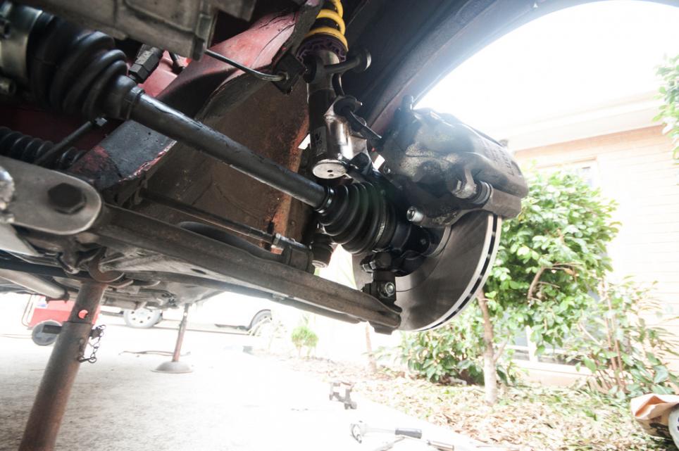

- New rear discs with new bearings and QFM racing pads, along with a camber shim with brought out the rears to -1.70 degrees of camber.
- On the front I upgraded the brakes to 280mm using the G60 disc and VR6 calipers, QFM racing pads aswell. I also got a hold of a flipping the tie rod ends with the help of my dad using a magnetic drill! Sandblasted the hubs and painted them after.

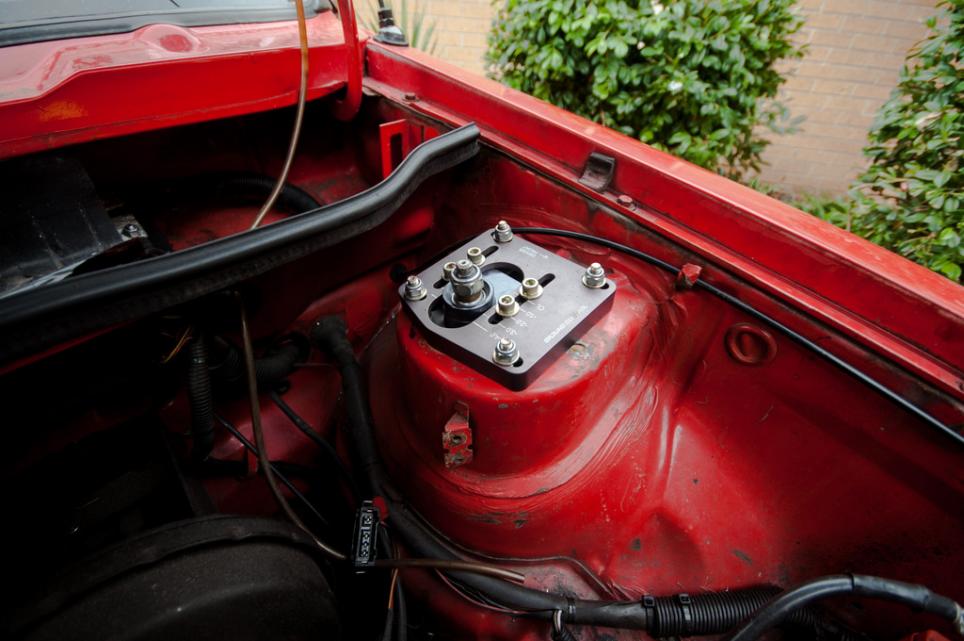

I got around installing the Ground Control camber tops too.
Camber is around -3.95 on the front, has made a big difference in corner speed and grip, very happy! I flushed the whole system with racing black fluid and gave the engine a service. Flushed the coolant system with some racing penrite coolant which actually help alot on the day keeping the temps down.
