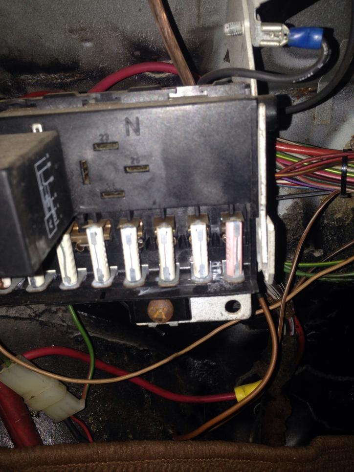

                                Hey guys been a very long time since ive done any updates or anything...amazing how caught up you get starting your own business! 😫😫
                                ANYWAY! Rest assured the car has been doing well and creating loads of love n smiles around sydneys north shore ran into a dilemma recently though...

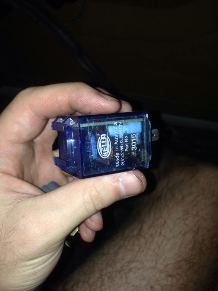

                                My fuse box started creating an immense amount of noise and sounded like buzzing, i located it to be on the far right relay? I think it is?
                                As you can see it has 4 spaces for terminals, however the relay that was causing the ruckus had only 3?
                                With this blue one, the buzzing stopped when indicators were being used but instantly back on as indicators are disengaged...
                                I put a relay in that had the 4 terminals in the space, this stopped the buzzing, but the indicators ceased functioning. Oh and with either relay, i get no cluster instrument use (no fuel, revs or fuelgauge) :/
                                Its also started running a lil rougher than usual, i searched a bit and found a few people talking about fuel relay? Not sure if this is it though. Any ideas guys??
