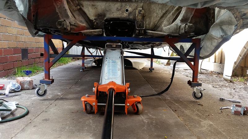

  • Not a bad day to be outside so I replaced the wheels on the dolly.

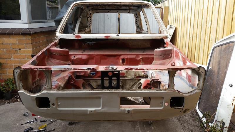

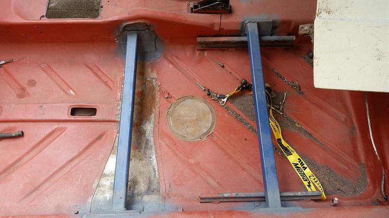

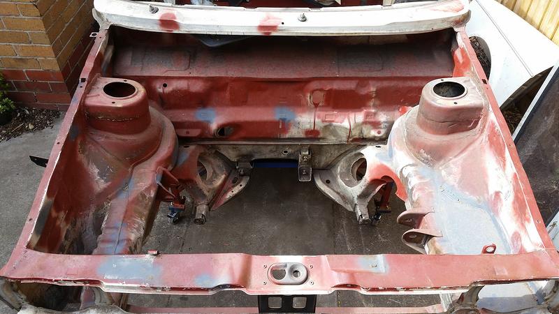

      • Looks like someone who knows about MK1's has already made a few mods. Things like the chassis notch, welding all the nonessential holes in the firewall and raising the front strut towers are small things but make a big difference. The welding on those towers needs tidying up but that floor looks perfect.
        When they did the towers did they keep the original chassis number on the tower or were the towers cut from a different car?

          He sure did. You can tell where he got better at welding haha. I have lots to do!
          Kept the original towers

            • Also - sweet jack! Has lifted a few swallowtail Mk1s in its time

                HAHA that Jack has saved me so many times...I need to buy you so much beer haha.

                      • Hahah those strut welds are not mine, bought it like that! So i guess that brings my average welding skills back up?
