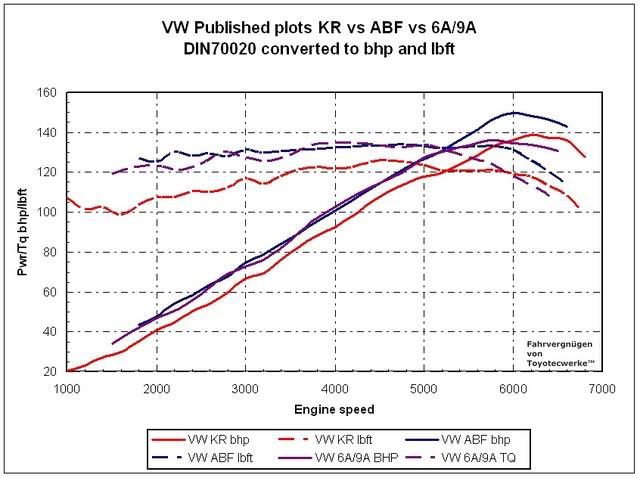

    What's your style of driving? - this will drive the cam choice. From ClubGTI tests (Mr Hillclimber) the ABF head flows better as standard than the 9a head. ABF block is newer design, but not sure if there is much to it. Nice problem to have though. Gav
      The ABF is a much better engine but it develops its power up around 6000 rpm and max torque is at 4600 rpm. The ABF is great if you are racing, lousy for highway cruising. Max torque on the 9a is at 3500 rpm so it’s much more useable.
      What I’m looking for is a magical combination that gives me lots of low down torque combined with a good top end that has more power than the 9a normally produces. It’s probably not possible but you don’t know if you don’t ask.
        ABF uses longer rods and has a taller deck. Has a slightly better head off the shelf.
        All the 16vs make great torque- More than an 8v- across the entire rev range. They're a better engine in every way. All of the VW engines are undersquare (longer stroke than bore diameter) which is why they all make good torque. The ABF makes more top end power but that's relative. It makes more power full stop.
        Use the KR cams or the ABF cams. If you use twin 40mm Delortos it's never going to be awesome down low. You won't have the air speed for it. If you choke them down they'll be pretty good, though.

          I never found the ABF a peaky engine like a KR or 4AGE.

            I support Preen on this Often cars with better overall torque feel like they have less because they come on at the top end, but that doesn't mean they have less at any point, just when the other one drops off the other steps it up
            Really need to look at the exact curve on the same scale.

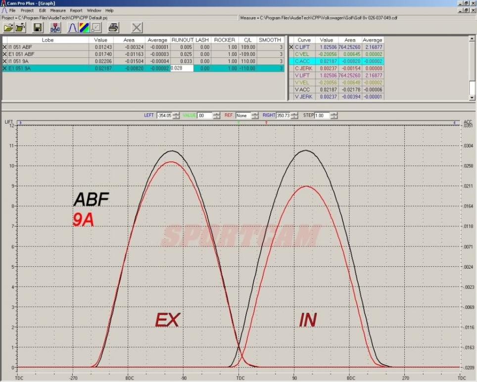

                      After doing some research it seems a good combo is the 9a block with the ABF head. The 9a block is normal height so no clearance problems if I decide to fit the fuel injection off the Seat and the ABF head has the following advantages over the 9a head:
                      Small 27mm dia exhaust valve on 27mm seat for improved flow of hot exhaust gas
                      Cooling passages in the exhaust port to reduce hot spots and improve durability
                      Cooling channels in inlet port to improve/vaporisation and wall warm up.
                      Cooling passages in the combustion chamber to reduce hot spots and improve durability.
                      Improved squish areas working with revised piston.
                      Optimised valve shrouding on the inlet toward spark plug hole
                      optimised head shape around the shrouded part of the exhaust valves.
                      Reduce valve guide protrusion.
                      Reduction in port casting imperfections.
                      In/Ex Port flow improved over "51***373" heads.
                      Late model 9a motors had the same head casting numbers as the ABF motors so there shouldn't be any problems fitting the ABF head. The only difference was the inlet and exhaust cams.
                      This is the bit that convinced me to use the ABF head. It develops more power and it has a similar torque curve to the 9a so running the wilder ABF cams isn't going to kill my low down torque.
                      Lots of info here.
                      A VW 16v camshaft study.
