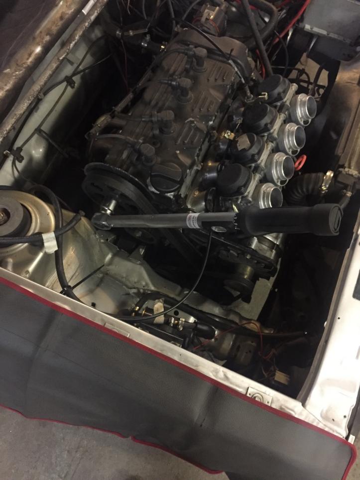

So... How bad is this? It makes this horrible screeching noise and I can't figure out where it comes from... https://vimeo.com/160507775
Any ideas? If I turn the engine by hand I can't hear it...
Edit: could it be the starter?Last edited by mads_christ; 27-03-2016, 08:50 PM.
It's definitely something rubbing against a metal plate.
Check if it's coming from the gearbox end. Sounds like the flywheel is rubbing against the metal plate that keeps the dirt out under the gearbox.
If it's really hard to work out where the sound is coming from try the old trick of holding a metal tube or pipe against your ear. The other end rests against the engine. Keep moving it until you hear it the loudest, that will be where the noise is coming from.Last edited by sports racer; 28-03-2016, 01:08 AM.1978 MK1 2.0 16v http://www.vwwatercooled.com.au/foru...-46488-70.html
Thanks! I'll give the tube a try!
I thought it was something going on with the torque converter in the auto box but the car moves freely when engaging drive and reverse. So I don't I don't think that is the problem.
It does seem like the problem is around the belts... But I have to "tube-test" it to be sure. I removed the V-belt and spun each pulley one by one without any noticeable noise. Do I dare turning the engine over without the V-belt attached to rule out the alternator and water pump?
You can run it without the V-belt attached. Just make sure you don't run the engine for more than a few minutes as it will heat up pretty quick. And don't disturb the toothed belt.
Cheers
Paul1978 MK1 2.0 16v http://www.vwwatercooled.com.au/foru...-46488-70.html
The noise is still there when the v-belt is removed...
Currently believing/hoping that the inner timing belt cover is the cause.
But... How the hell do I remove it? Do I need to remove the timing belt? It seems to be stuck behind the intermediate cam sprocket... But there shouldn't be any bolts there. At least from what I can tell...
