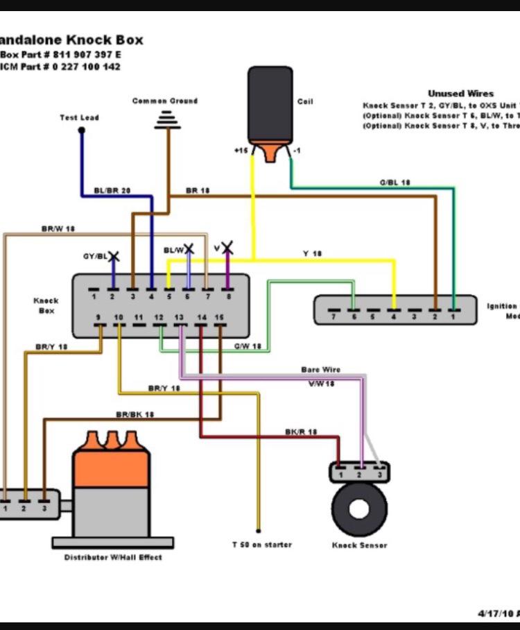

Isn't the test lead for diagnostics?1978 MK1 2.0 16v http://www.vwwatercooled.com.au/foru...-46488-70.html

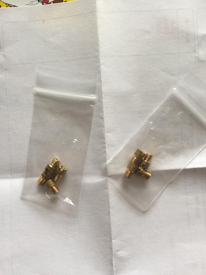

Carbs has been rejetted. And a few new bits has been bought.

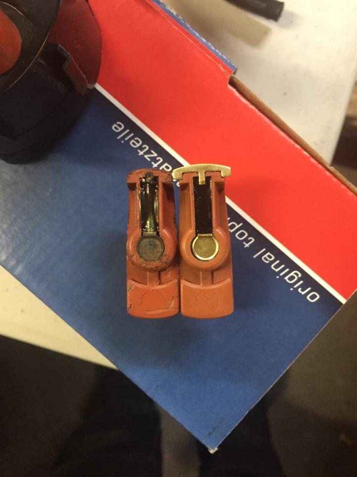

A new rotor was definitely needed...

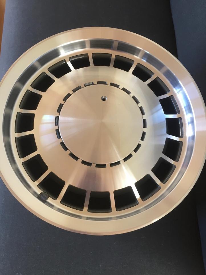

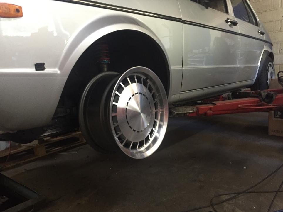

I had an accident today... Bought new wheels. New wheels was probably the last thing I needed. But 360 aud for a never used set...Last edited by mads_christ; 27-09-2015, 09:43 PM.
The Danish mk1

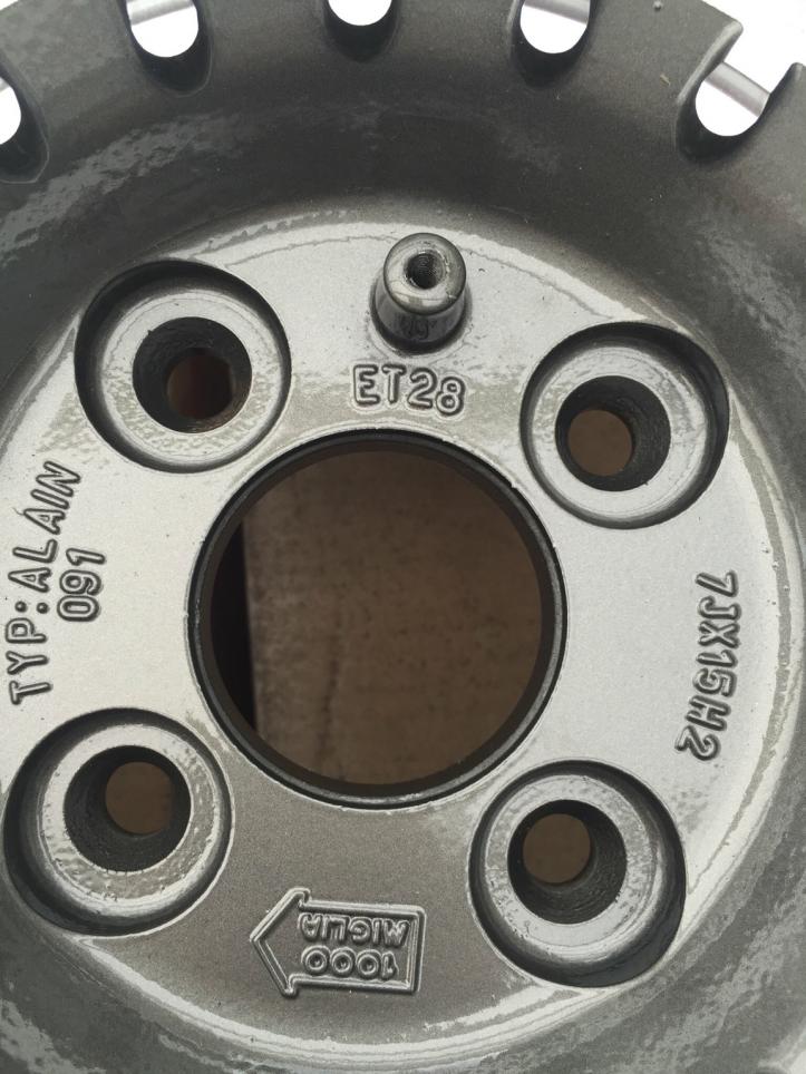

They are Mille Miglia (1000 Miglia) Alains.
7x15 ET 28. They do look very wiiiide though. Not sure if it will work.
Perfect choice!1978 MK1 2.0 16v http://www.vwwatercooled.com.au/foru...-46488-70.html
Et28 is massive! No wonder they look like they won't fit
