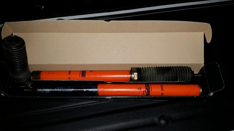

Trying to sort fronts now, there was more oil in the upright than in the shock of our original sets... can anyone help out with inserts? There isn't much in the country from new.
I might have some gabriels, I'll have a look tonight.79 MK1 Golf Wreck to Race / 79 MK1 Golf The Red Thread / 76 MK1 Golf Kamei Race Car

You're in luck.
I found these in the shed.
They were NOS when I got them and they didn't do a lot of miles in our red Golf.
Not leaking, plenty of pressure in them.
Can't see you bending these, they're made like the Bilsteins and use a large diameter hollow shaft for extra volume.
Same address as last time?79 MK1 Golf Wreck to Race / 79 MK1 Golf The Red Thread / 76 MK1 Golf Kamei Race Car
