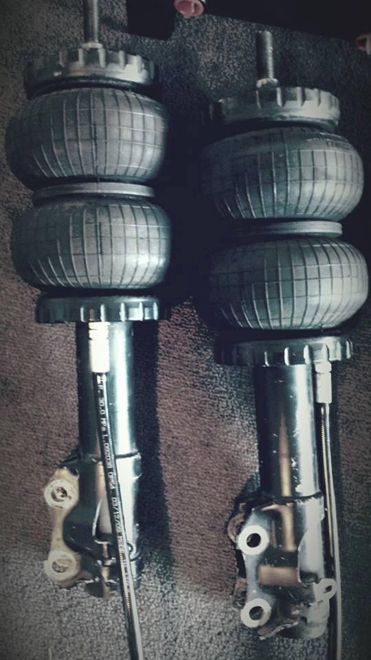

Put absolutely everything back in yesterday and hard wired a fan switch for me to control. Drove around beautifully and the front strut top raisers work awesome! I picked up my girl friend and the car died in her street. It wasn't priming so I checked the fuse and sure you it's the fuel pump fuse blown. Unsure of what happened I touched the fuel pump wire direct to + and it sparked! this meaning it was shorting somewhere. Got a new wire in and fired right up.
