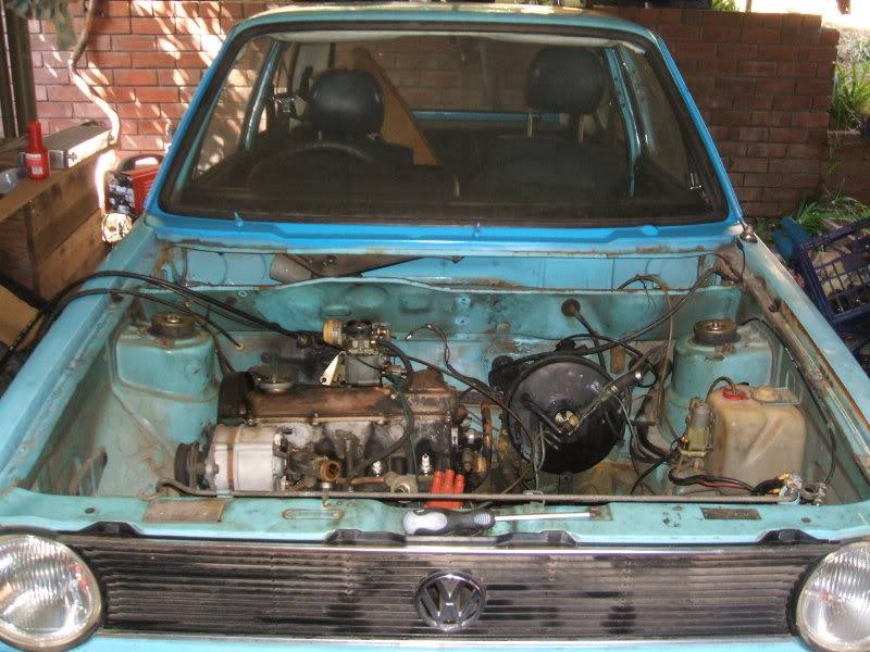

If you check out this pic you can see some idiot has siliconed around the windscreen. This causes it to rust...
we pulled out the windscreen and cleaned up the seal, there was rust all the way along the bottom edge, with holes varying in size from 2 to 10mm in diamet
thanks to aydan and his ebay welder for the help... this rust is now goneski.. it was filled and ground back to flat. then tidied up with some filler.
The windscreen was fun (read:dreadful) to get back in again.. I would love to hear how others do it, but i recommend you park the car on the flat when trying this. Push some 2-3mm diameter string into the seal then mount the base of the windscreen into the shell. Then, while keeping pressure on the glass near the seal, pull the string out from the inside of the car.
then if the windscreen is close to going in once all the seal has caught the outside of the shell, but just poking out a bit, drive up a gutter with one wheel to twist the chassis slightly, then push the windscreen in further. Then repeat with the other side. worked for us.

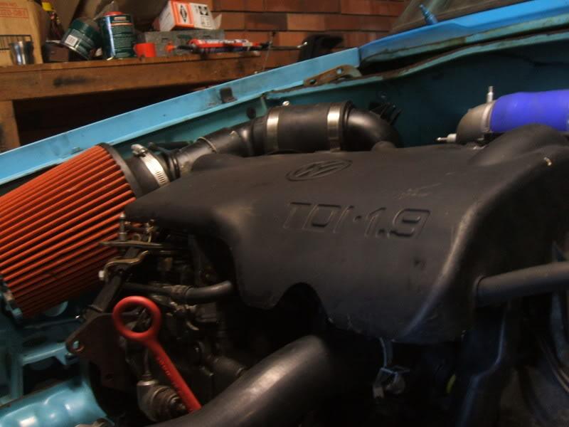

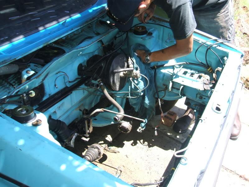

Update

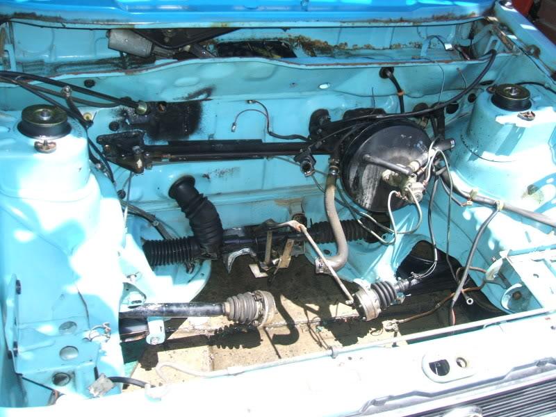

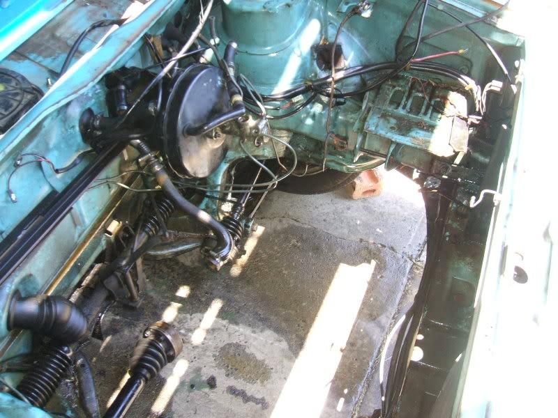

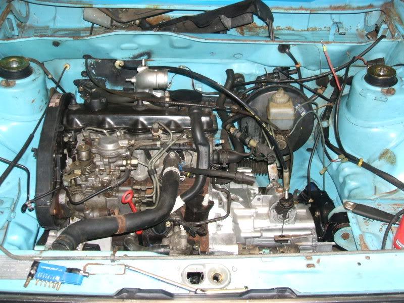

heres what you've been waiting for kids...
i'll let the pictures do the talking, but needless to say, after just one full day on this, mikey and i are SHAGGED. it'll be another good days work to have it running, and another good day's work to get it looking alright.... then it'll need an exhaust.... but its really getting there
mike getting stuck in :-P
now what to put in this hole.....? i know!

oh hellllllll ye-ah!
about time! this ought to be wikid.
can't wait till it's done..
Woah! Sexy time! Very niiice!
