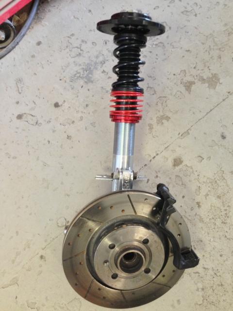

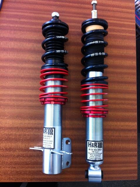

    Im changing my coilovers to ive bought some AH-exclusive modified ultra lows by H&R pure coilover porn lol
    The koni fk's were ok but i know they wont be a patch on the new set up i ran the same ones on my mk5 golf the ride was amazing, they are bilstein shocks so you know there gonna perform well

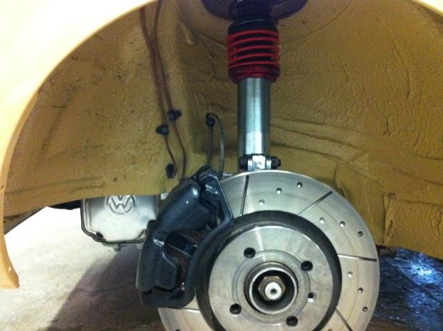

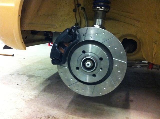

              to update i fitted the g60 front brakes haven't tried them yet just hope they perform ok after having the wilwoods fitted
              at least now i can run without the need of a large spacer

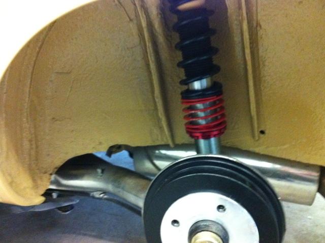

                so to update fitted the H&R's they ride awesome still yet to set the height exactly where i want it tho

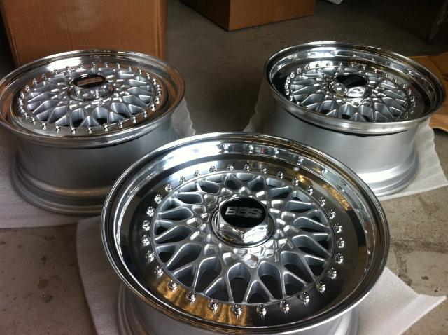

                  To update my new wheels arrived 16" bbs rs's i had the lips and barrels changed so i could run the off sets i wanted

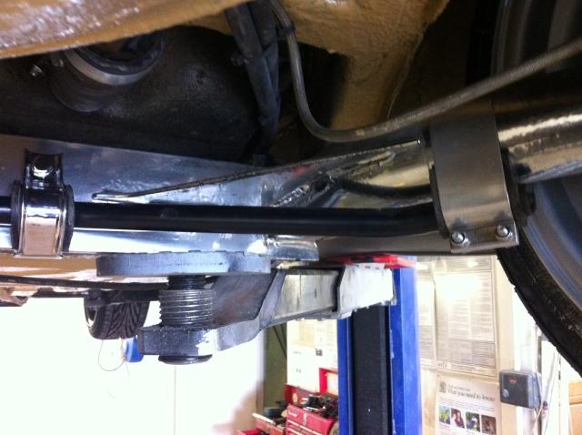

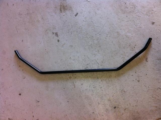

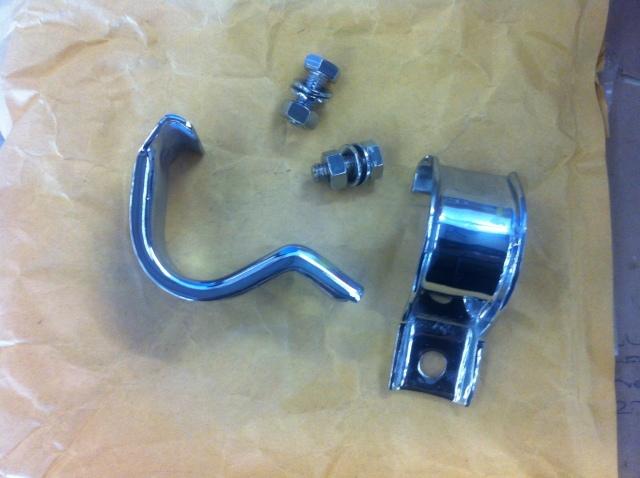

                    refurbed my anti roll bar when money allows it will be upgraded
                    my chrome brackets arrived
                    all fitted with stainless steel outer brackets

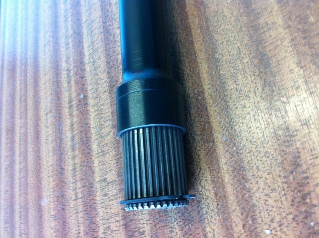

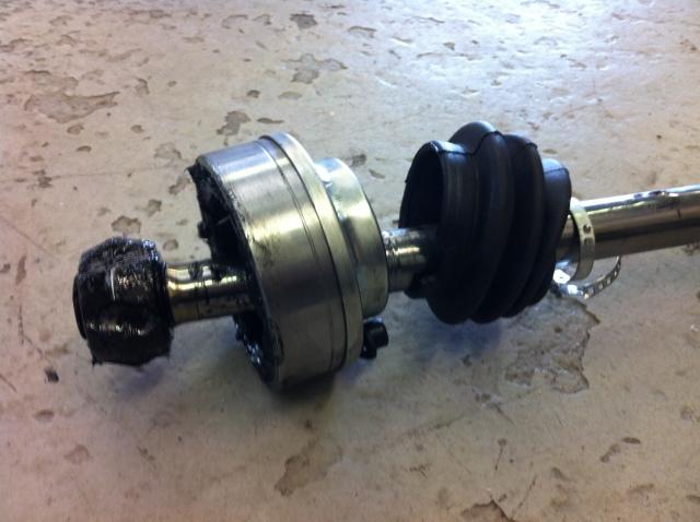

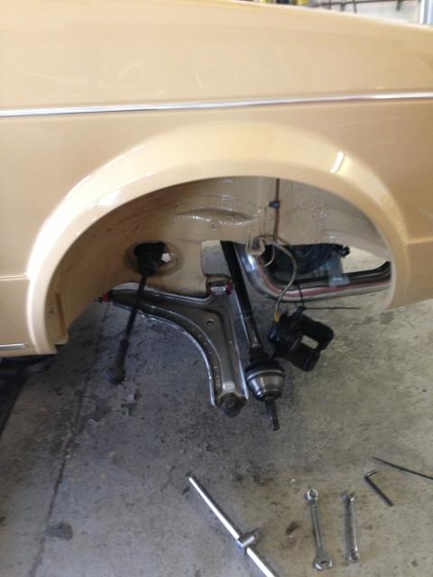

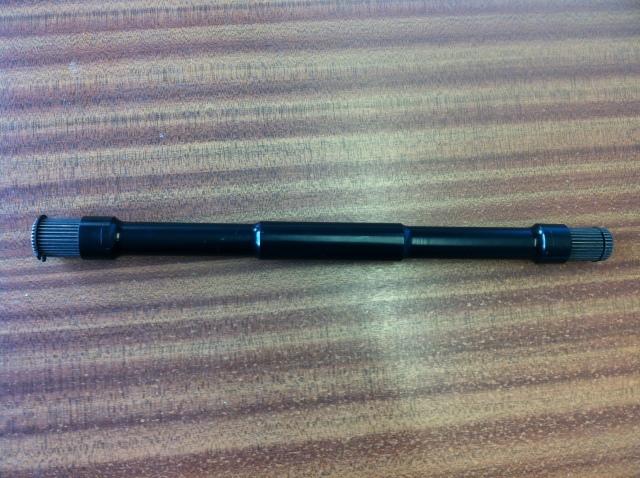

                      I also tok the car out to check the new wheels clear etc but broke the new inner cv joint ! the shaft is to long and the cv joint cant take it
                      so im having a custom shaft made up
                      • #56
                        Custom shaft made from scratch 20mm shorter

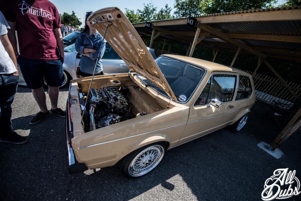

                          Its was time for another show Players classics at goodwood race circuit
                          a few pics from the show
                          i won a trophy to

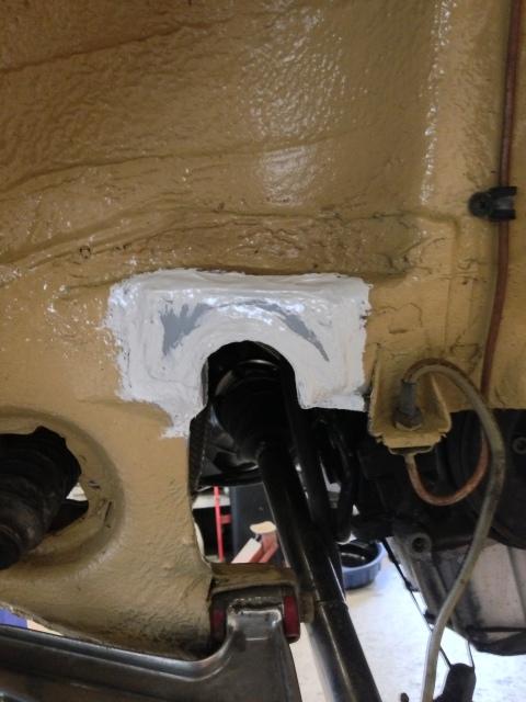

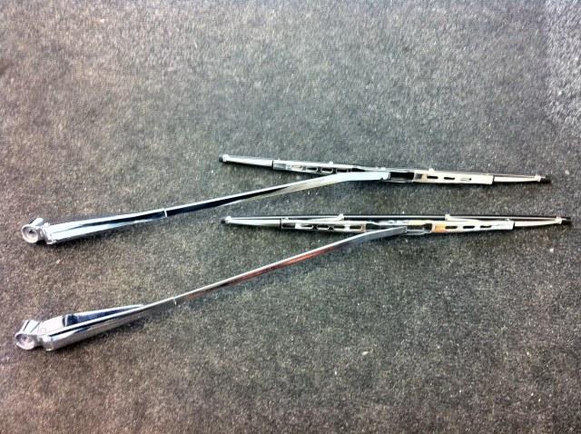

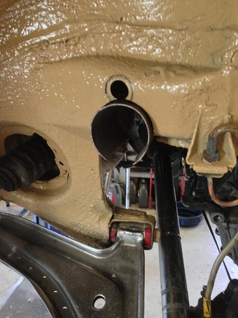

                            so to update a little it was time to change a few things 1st up some more chrome
                            wipers and some caps

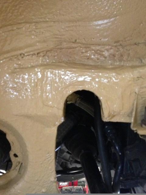

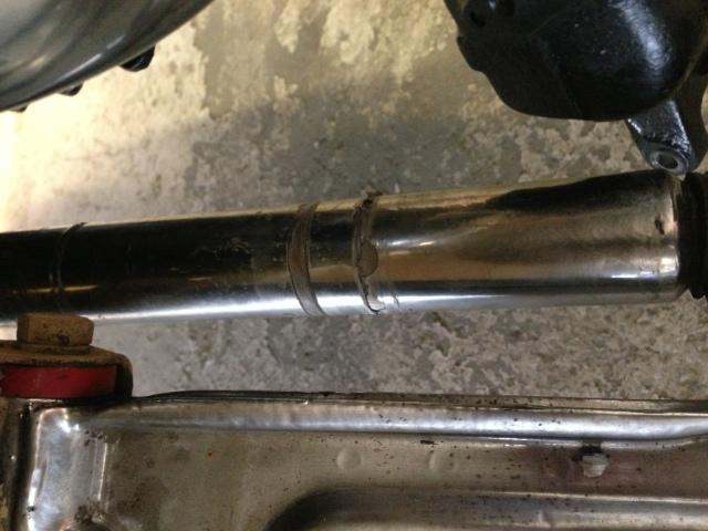

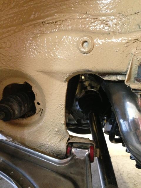

                            I needed to go a little lower so i had to notch the drivers side you can see the rub marks on the shaft
                            so i stripped that side out

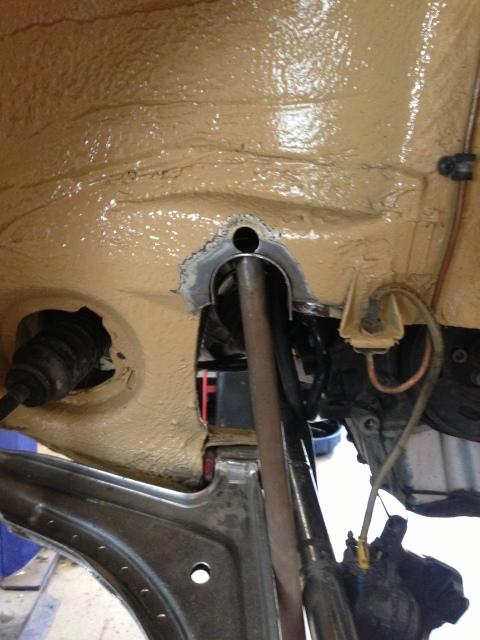

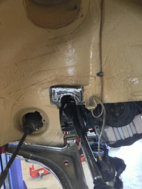

                            what the chassis looked like
                            i then marked out the ares and cut all the way through the chassis leg, cut metal tube to size and began welding it in
                            i also welded a plate above it for extra strength
                            primed it and seam sealed it
                            and painted it

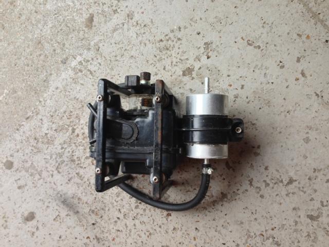

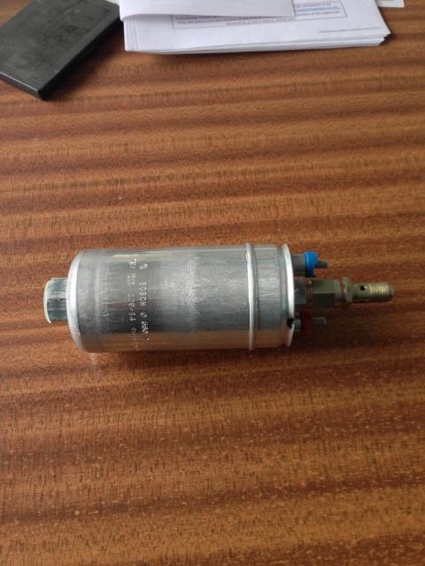

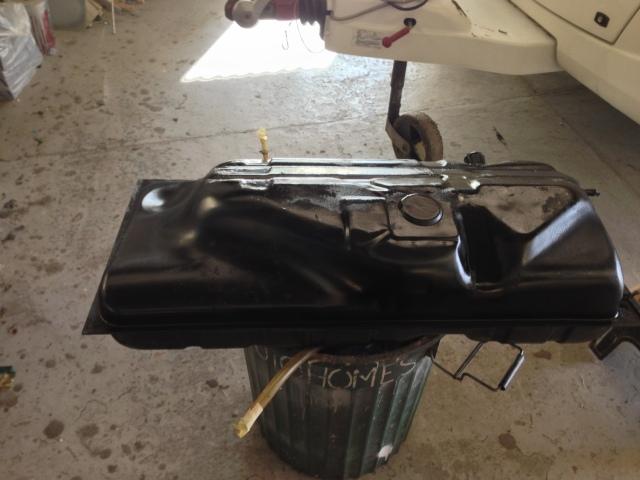

                              Next up was the fuel pump i was running a pump and accumilator in the boot as my lines run inside the car, this made the car smell of fuel so time to change it all
                              the old pump
                              i needed to change the fuel tank to a gti tank as it was running the old 1.1 tank with pick up pump in the tanks
                              so i sourced a gti tank

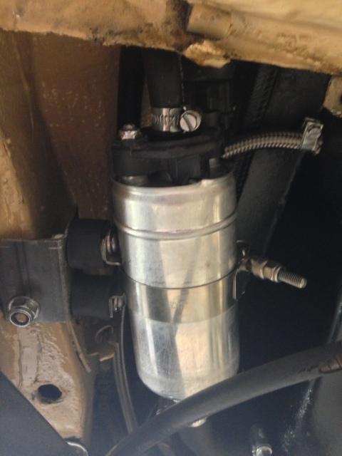

                              bought a new bosch pump this one is good to run upto 500 bhp
                              out came the old tank in with the new one
                              i made up a mounting bracket for the pump and another for the filter and added teflon braided hose
                              no more bad fuel smells

                                Went to another show and won the people choice car of the show
